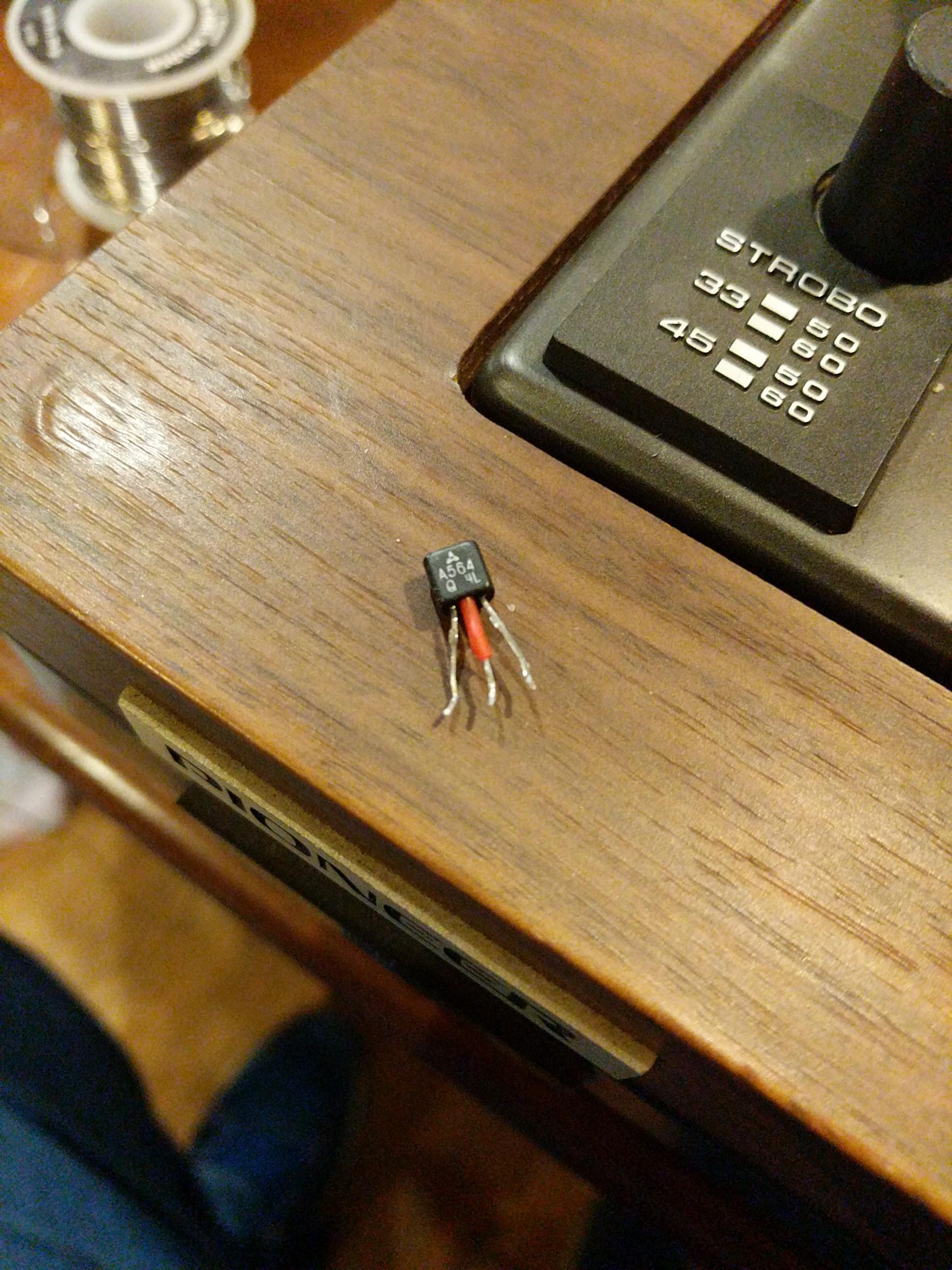

I think I figured it out.
One of the driver transistors for the 3 poles is leaky. I can see it when I use a scope looking at both the AC and DC component.
However if I remove it from circuit, it tests "ok" on my DMM.
Leaving it out of circuit, the turntable runs without stalling, just a little jerky from the missing pole now.
So I think I am close.
Exactly what it was. Tests great on DMM, but fails miserably under load.

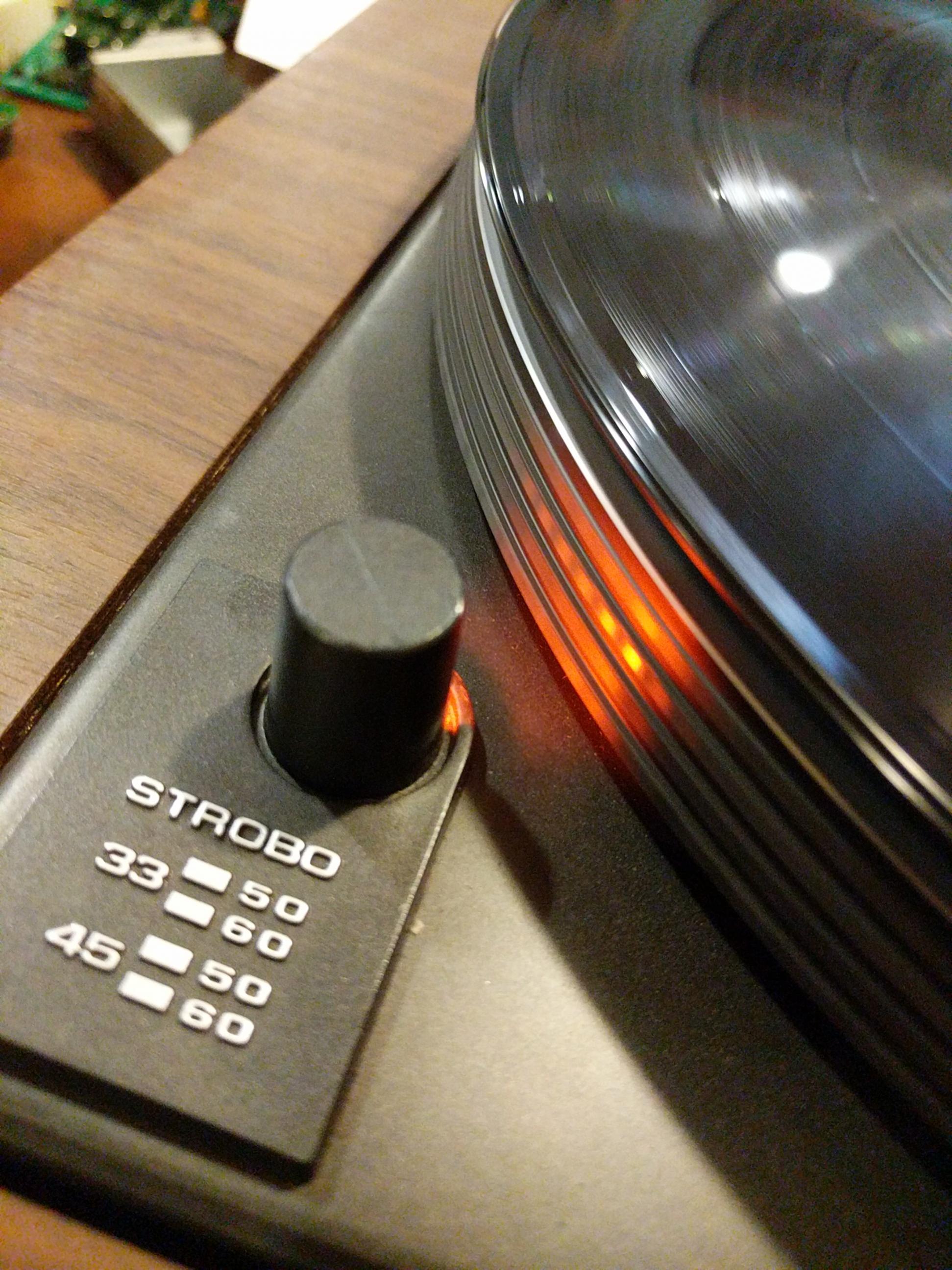

Swapped it out with a 2N2907 or something along those lines, I forget. She took right off and is running perfect although she is a slightly bit drift happy. I guess because its not really quartz locked like the newer ones.
