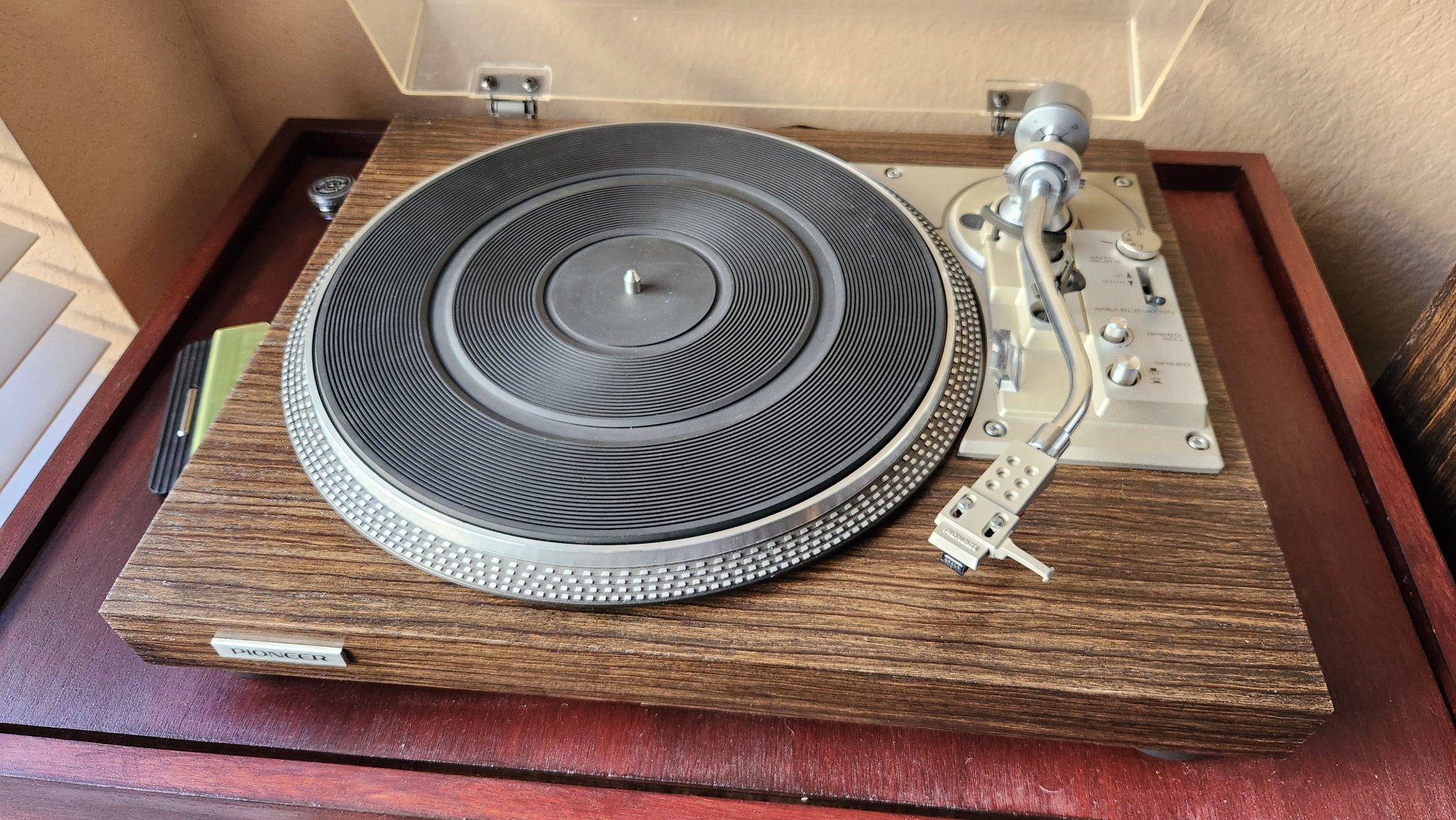

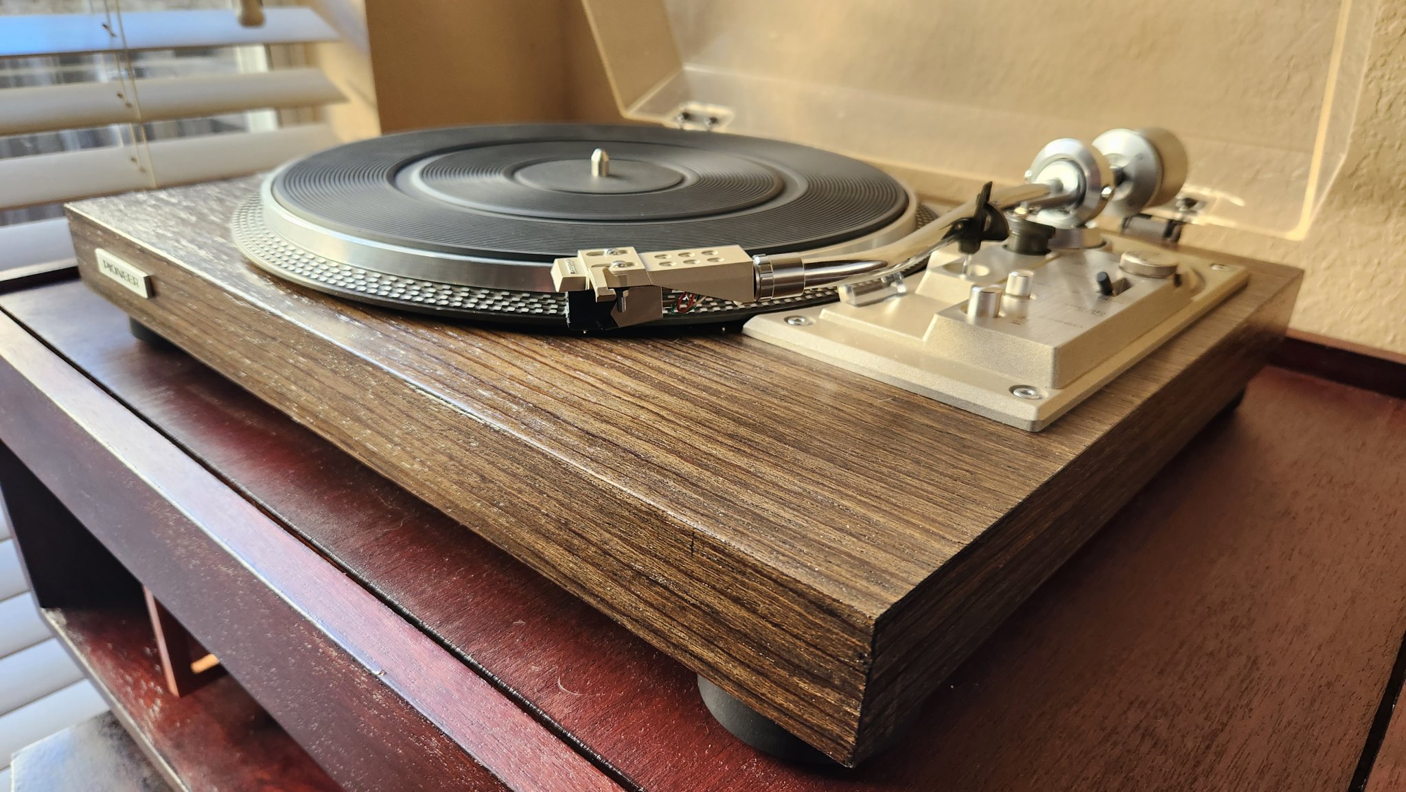

Plinth veneered, stained and with two thin coats of water based poly. I didn't have a veneer scrap large enough to cover the entire top so had to use two pieces, but the grain of the zebrawood makes the seam invisible. New RCA cables were wired into the tonearm connector and out the back at the stock location. These are quite thicker than the originals so care must be taken to ensure they don't disrupt operation of the automatic mechanism.
Overall view in place. Dust cover needs to be sanded and polished. I thought of painting the tonearm base satin black but now feel I prefer the factory almost champagne color.
Closeup of plinth.
This turntable drives a Pearl 2 phono preamp and though I had no complaints of the Technics SL-B2/Shure M97 previously in place, the Pioneer PL-516/Grado F3+ combo is the clear winner to me. The Pioneer does everything better and is far quieter. I experimented with swapping cartridges between the turntables and in my opinion the Technics sounded best with the Shure cartridge and the Pioneer best with the Grado cartridge. Not a bad find for a broken PL-516!

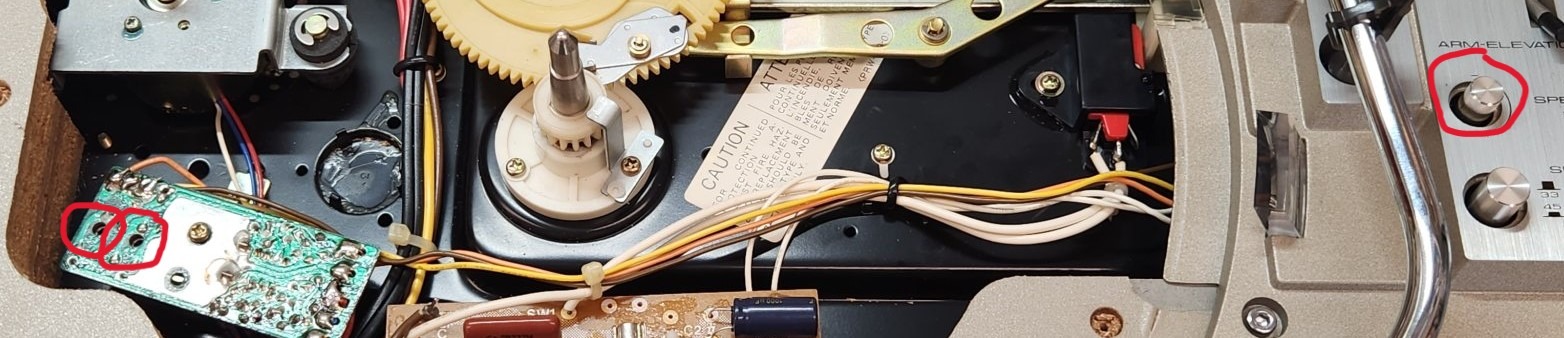

This turntable has been serving me well but speed was beginning to become erratic after extended listening sessions even though I'd originally cleaned all the pots and replaced the caps on the motor control board. I went ahead and replaced the the 33 rpm and 45 rpm 20K pots on the motor control board as well as the 5k speed fine adjust on the console (I'd already ruled out the speed switch causing problems by jumping it out of the circuit). Let the platter run for 6 hours and speed is still solid so this should be the end of it. Net cost of the three pots= $3.50
At this point all the caps on the motor control board have been replaced with an ebay kit, and now three more pots associated with speed control have been replaced. Should be good for another 30 years!
Two red circles on left are the 20K pots on underside of motor control board. One on right is the 5K fine adjust.
