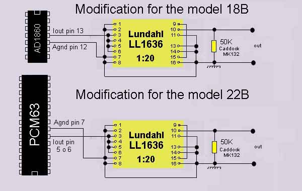

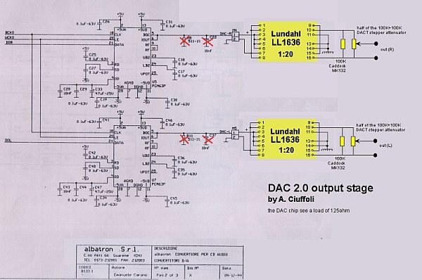

I have a Pioneer PD-8500 cd player. This cd player use a piece of BB Pcm-63K dac/channel. I want to built another, better output stage.
I have two idea.
1 Transformer output whitout tube. Sowter 8347, or Lundahl LL1620.
2. Fet output stage.
What is the better? Have anyone a better idea?
I have two Lundahl schematic, but i haven't got a Sowter schematic. What do you think for these?
I have two idea.

in that case you'll certainly need buffer after transformer outputs and preamp ;
input impedance of your next (preamp ) stage is too low for transformers in that place and role ;
besides that - when you ( and if ) you made that modification to PD , your receiver will be way below in quality .

I think, I understand what you say for me. What you recommend me, what I do? What kind of buffer do you think?
Which you recommend me, from among two schematic? That I showed it?

these "two" schematics are in fact - same .
regarding buffer - do you have possibility to buy from e- bay ?
presuming your lack of experience , maybe is best to buy ready made buffers
