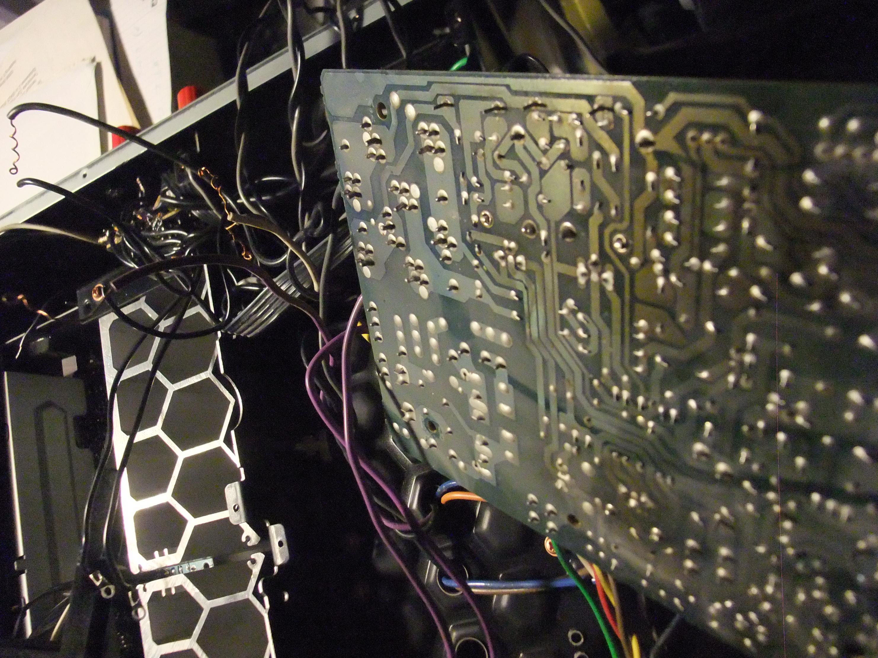

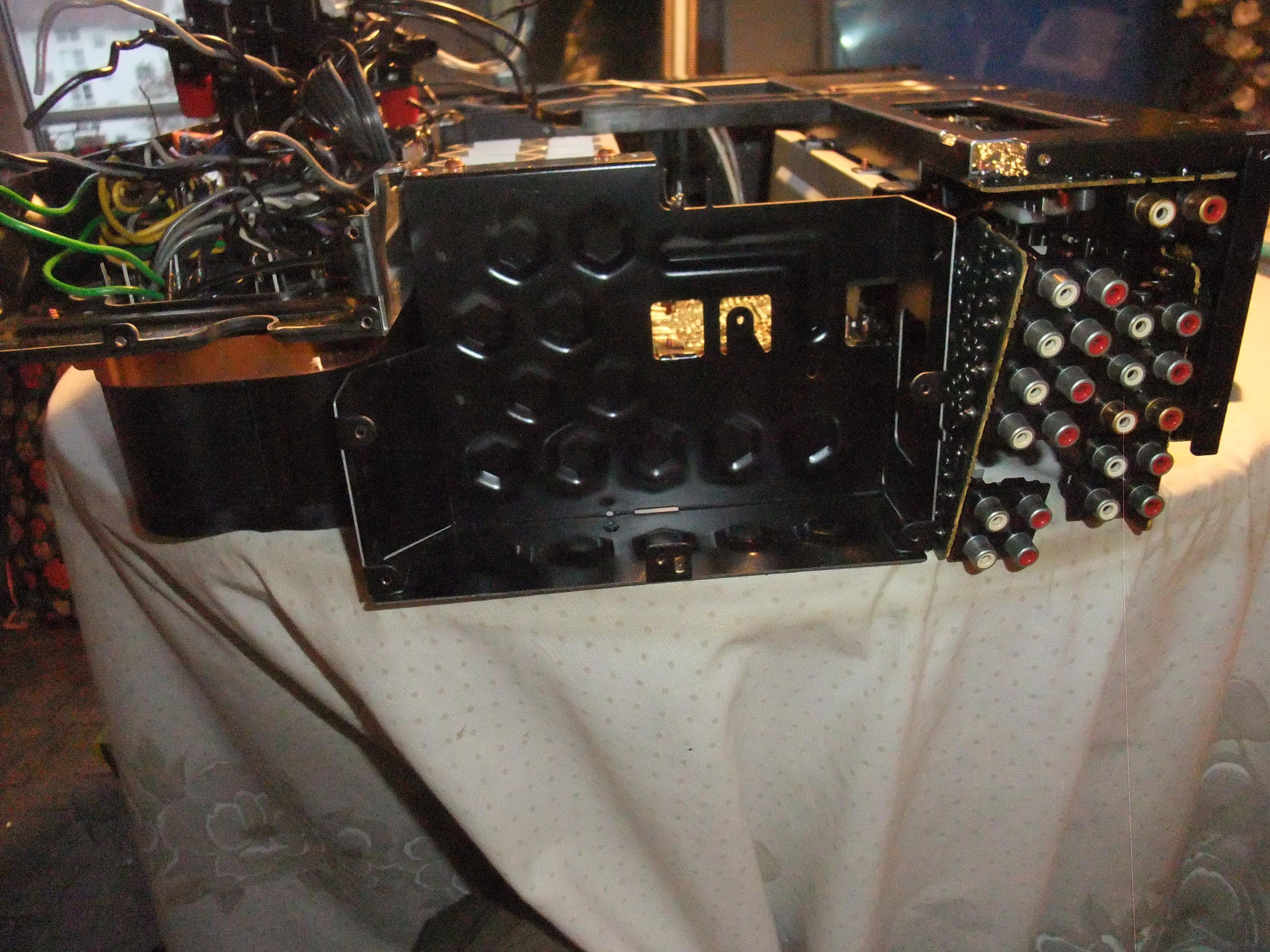

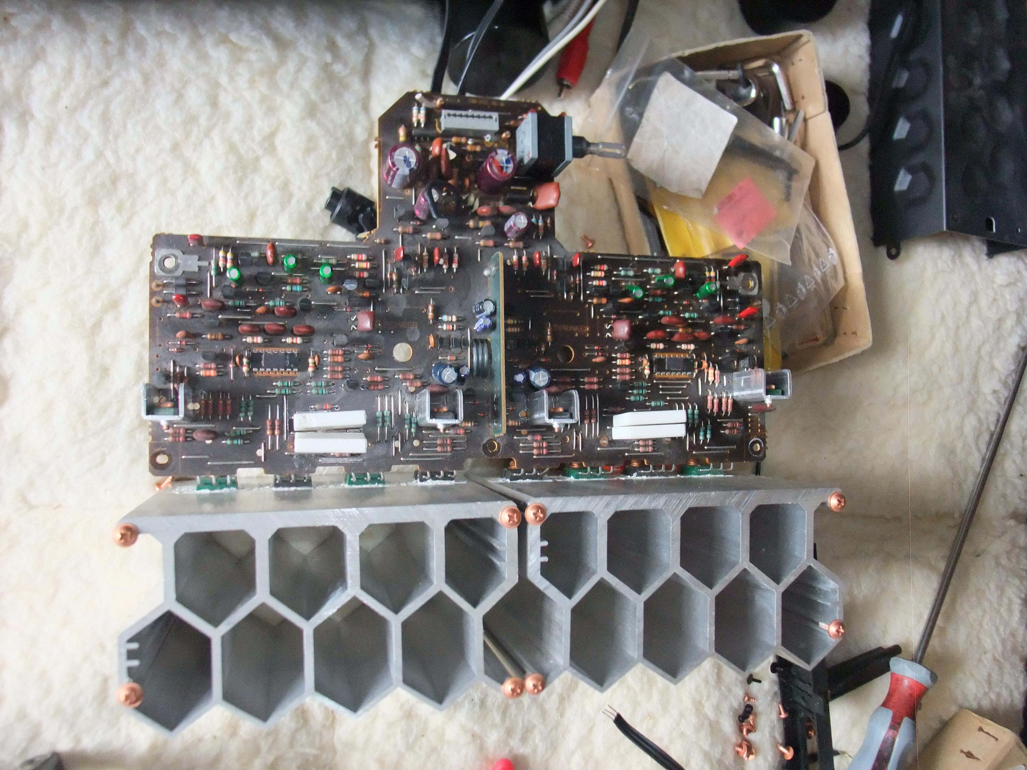

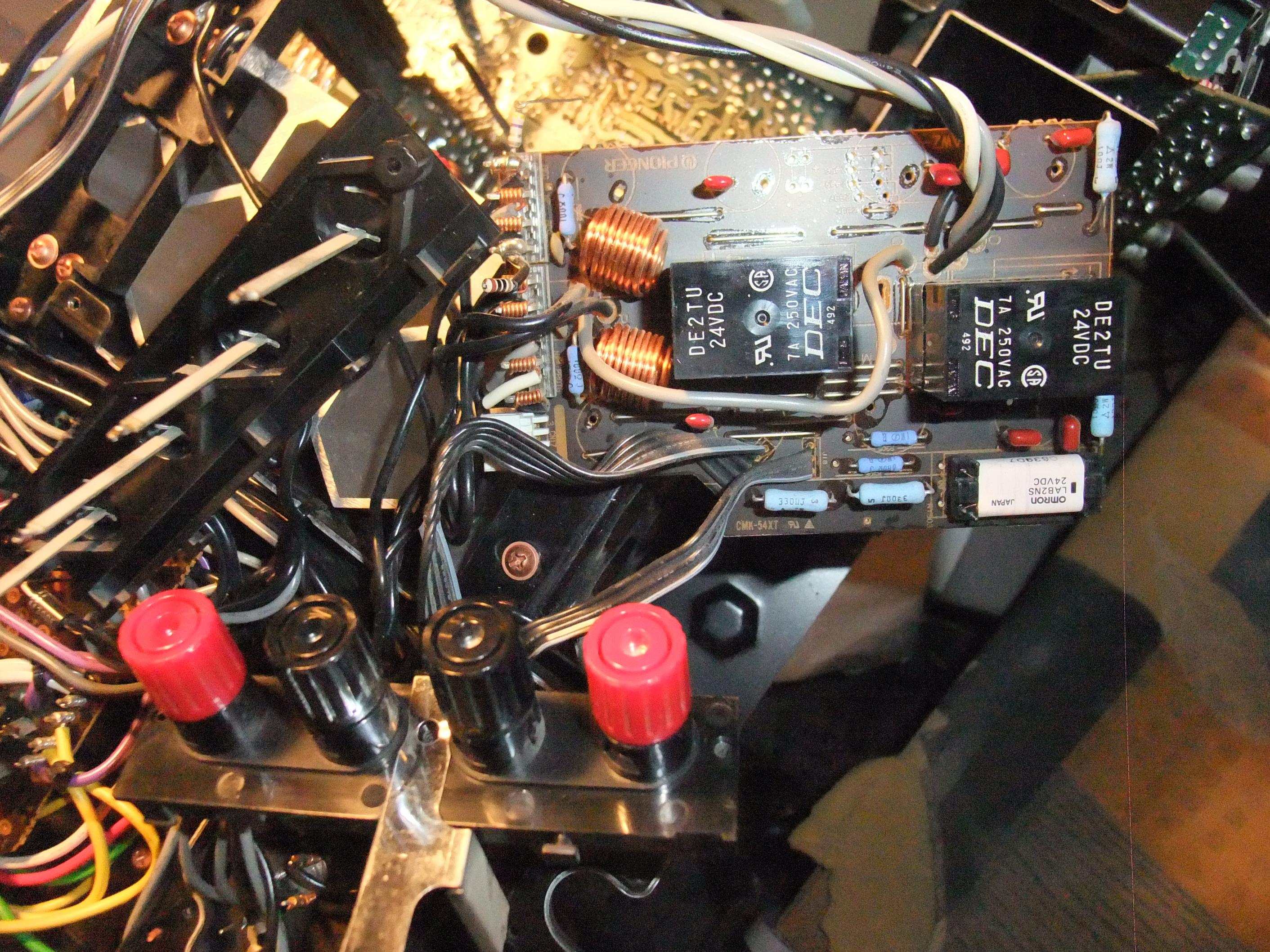

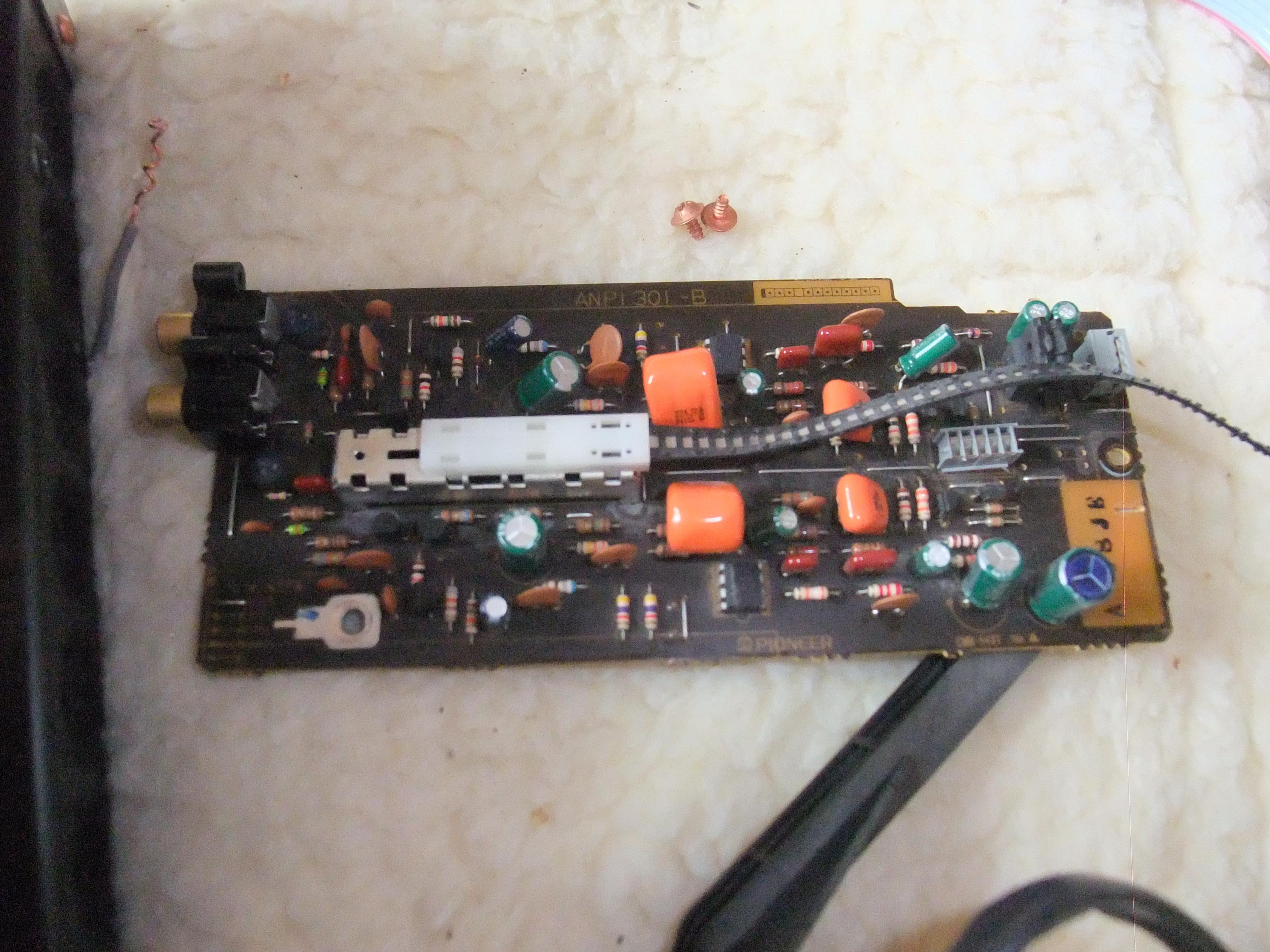

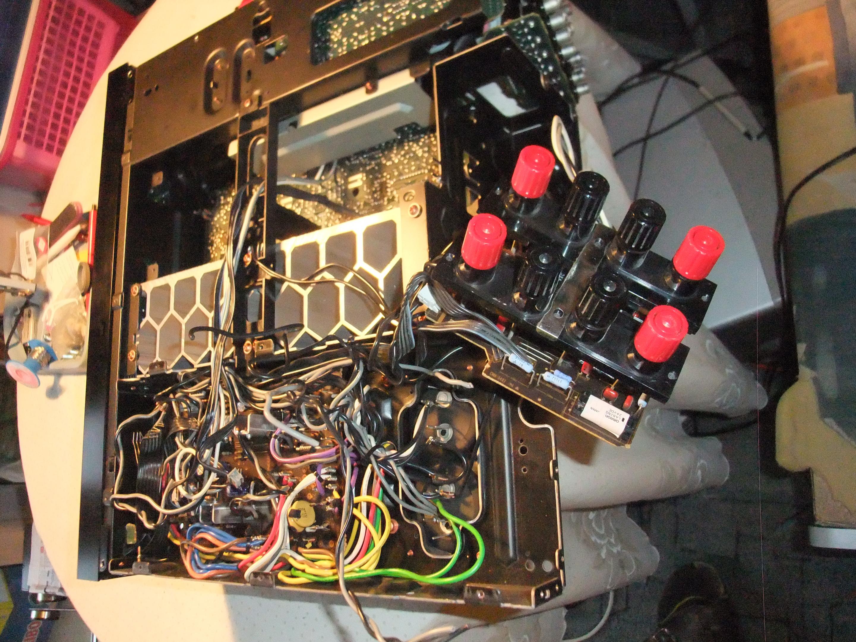

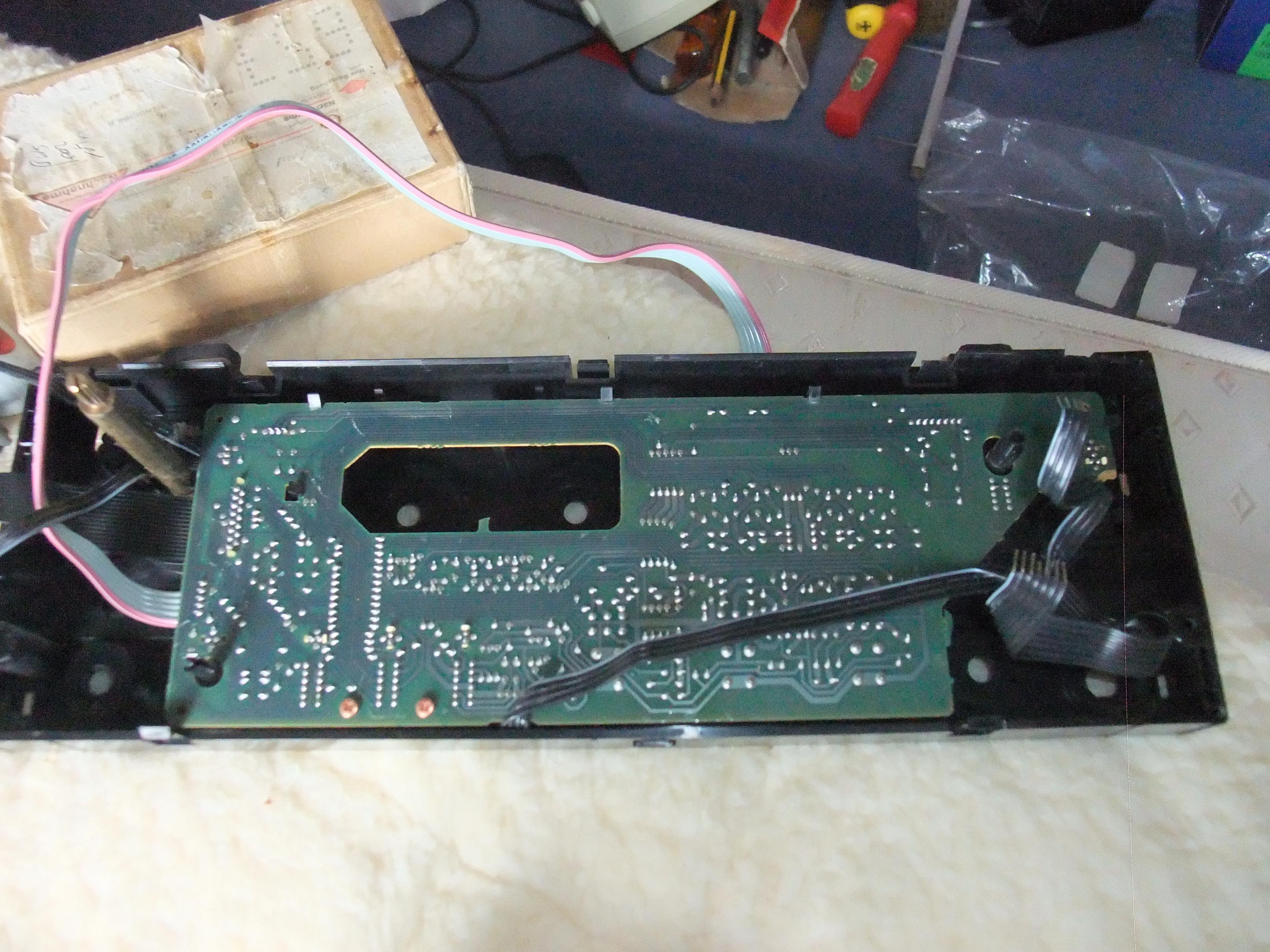

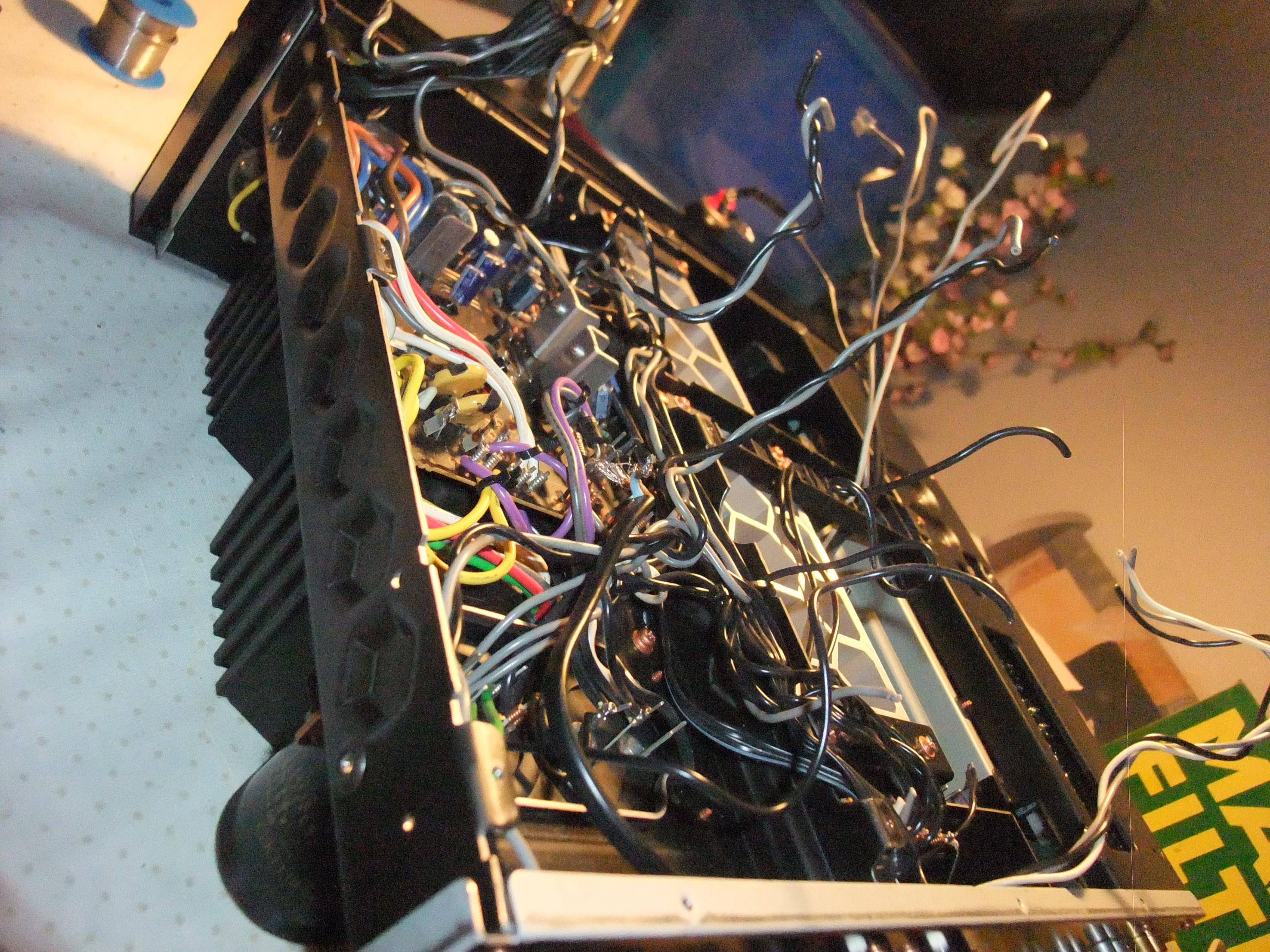

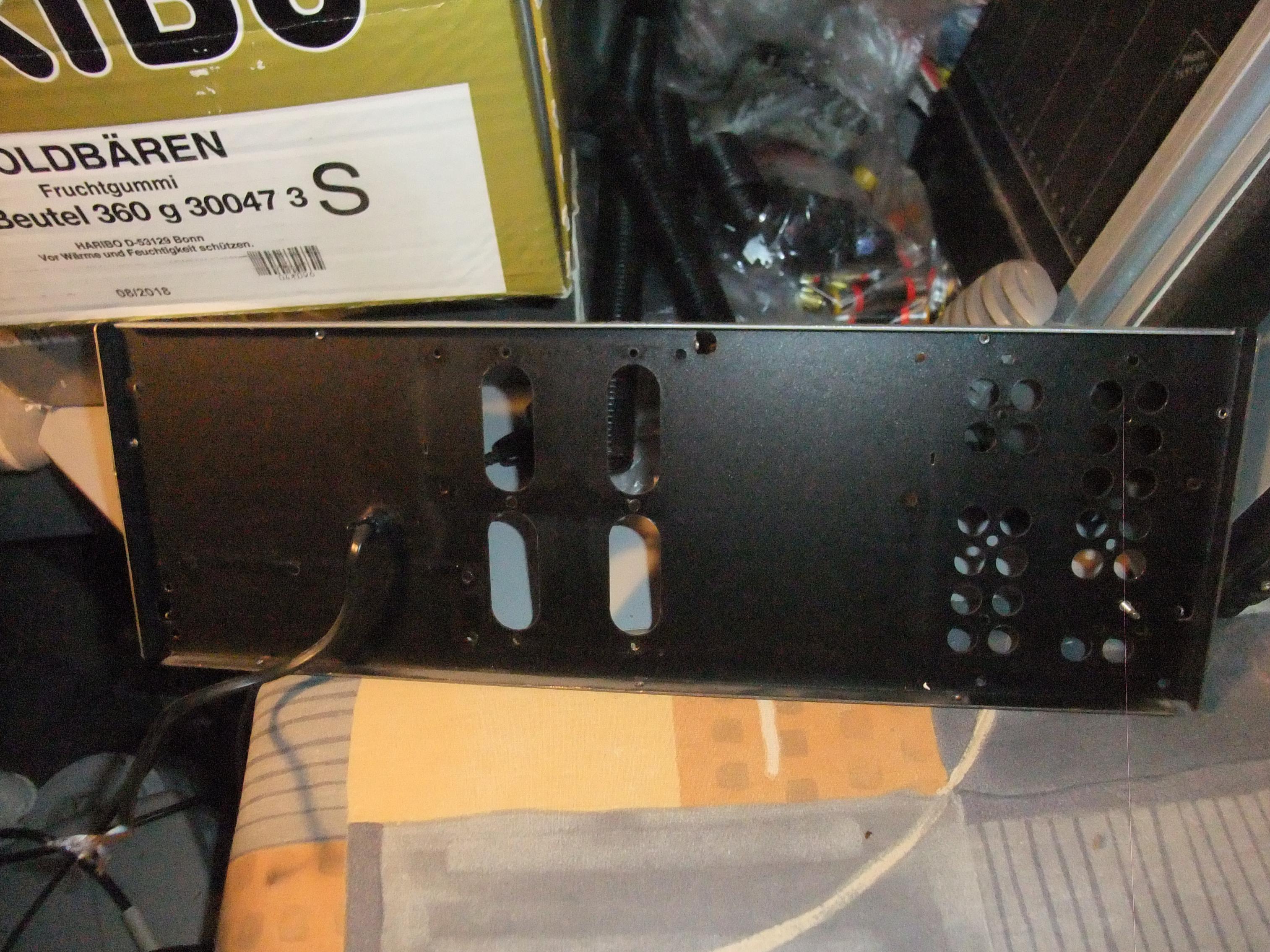

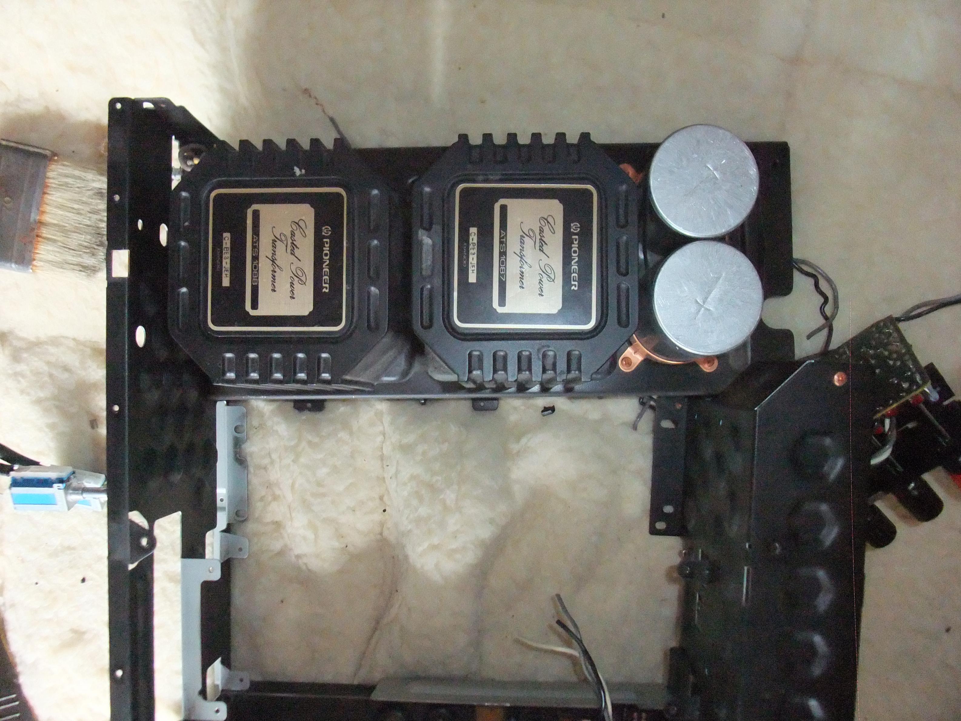

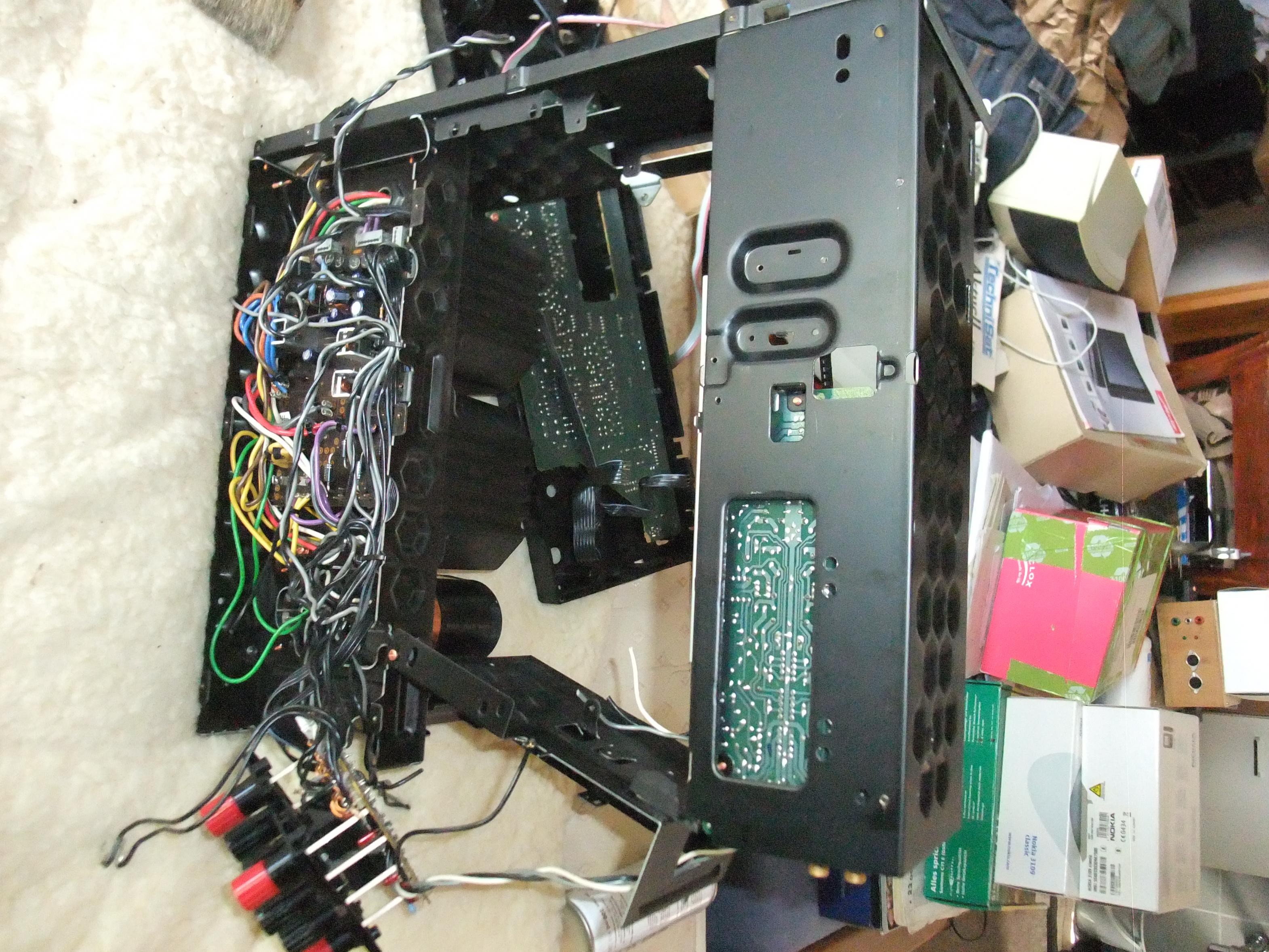

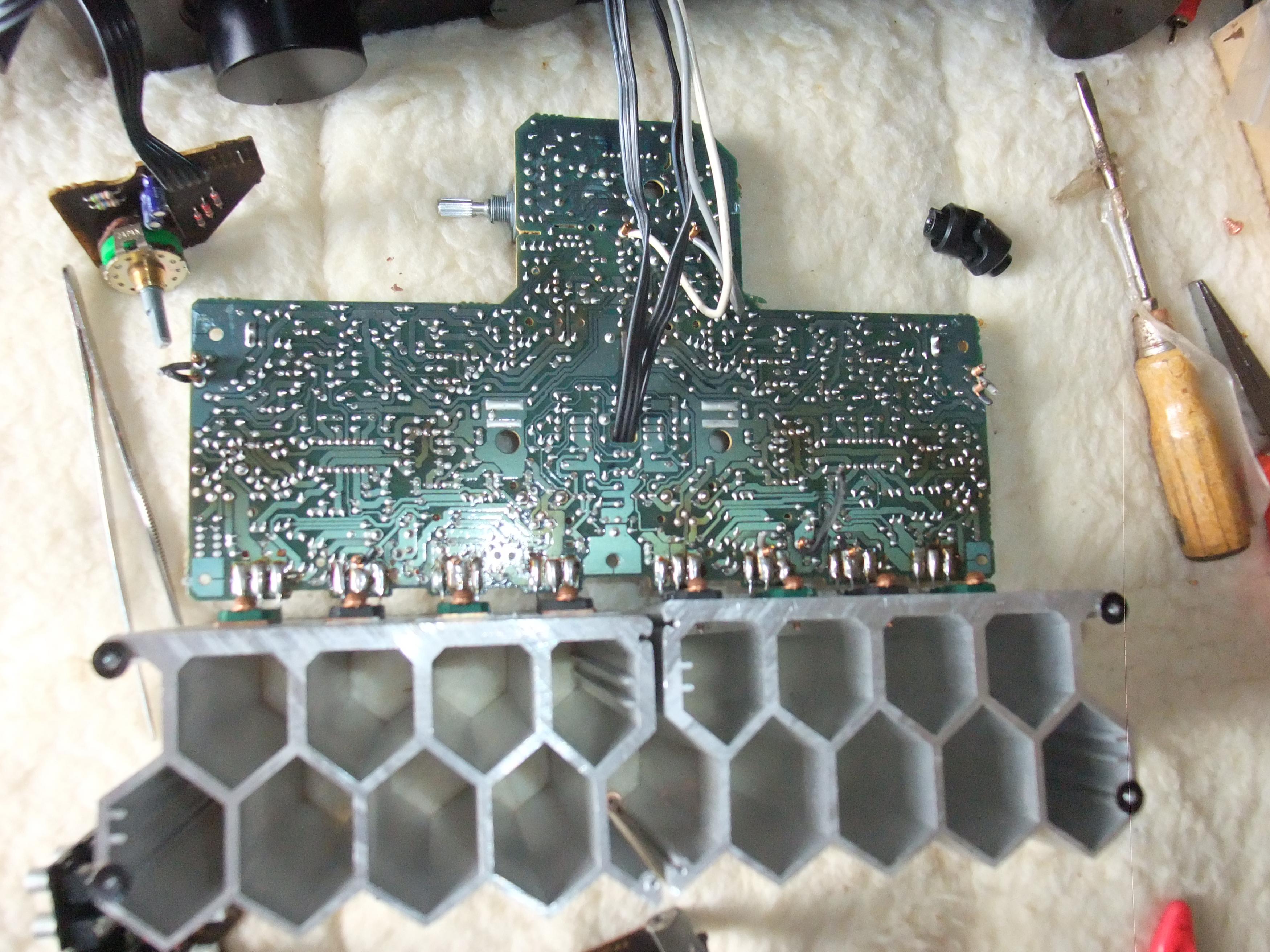

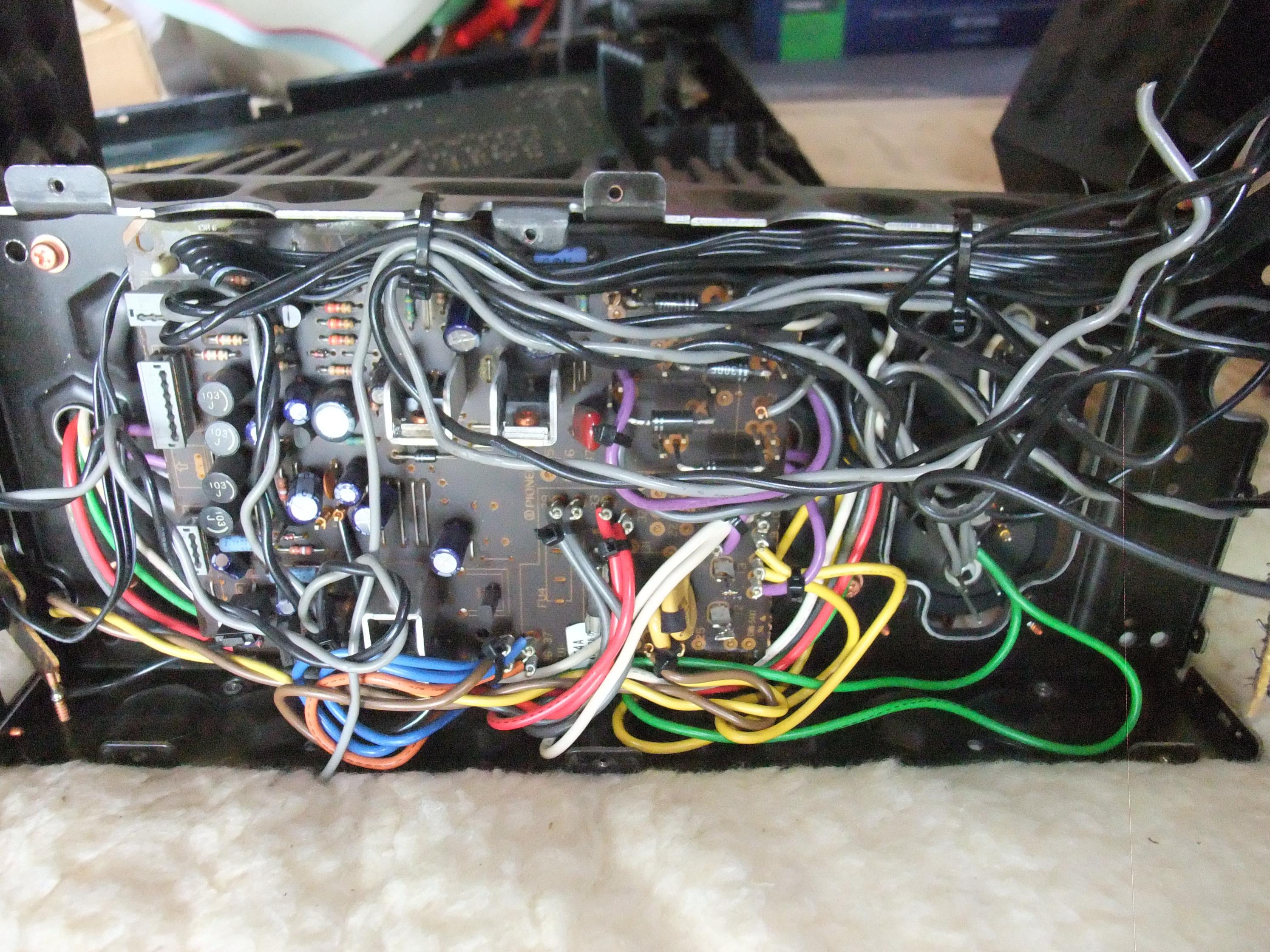

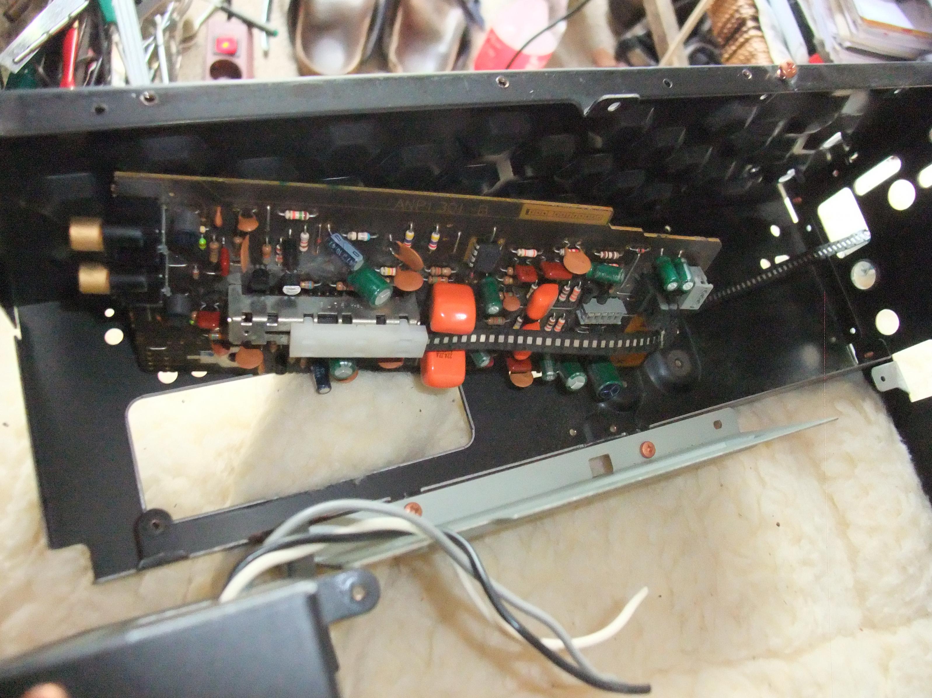

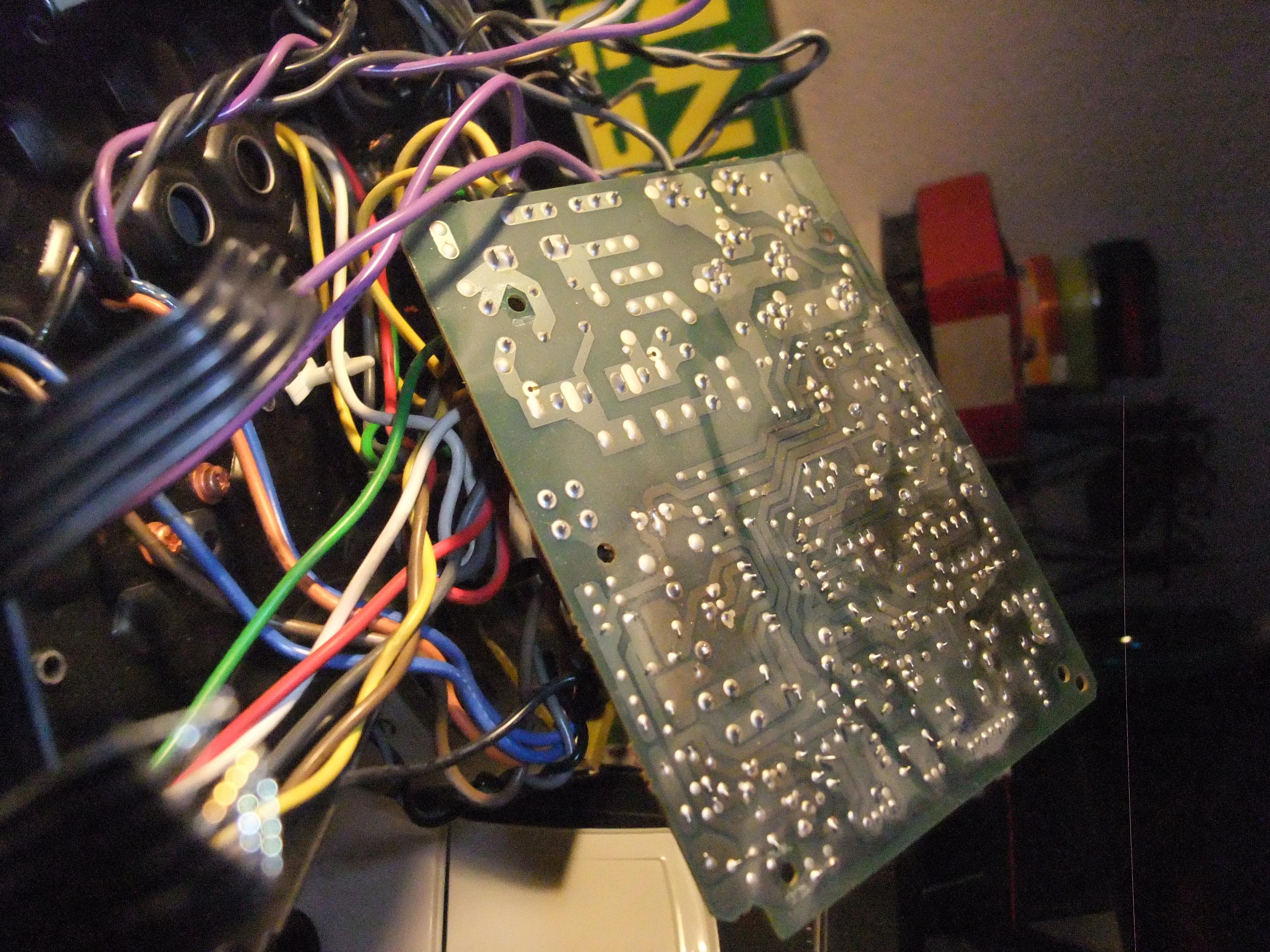

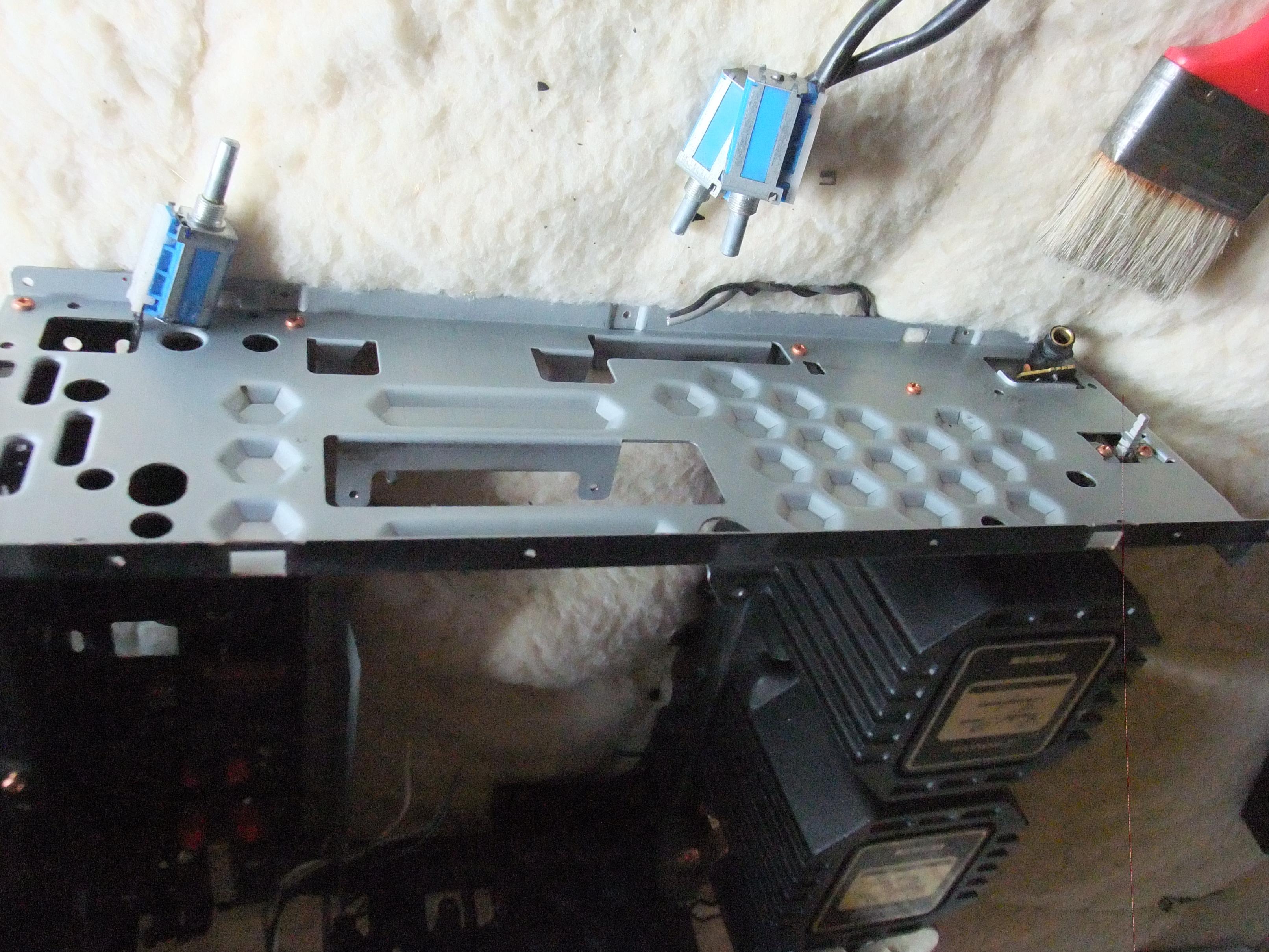

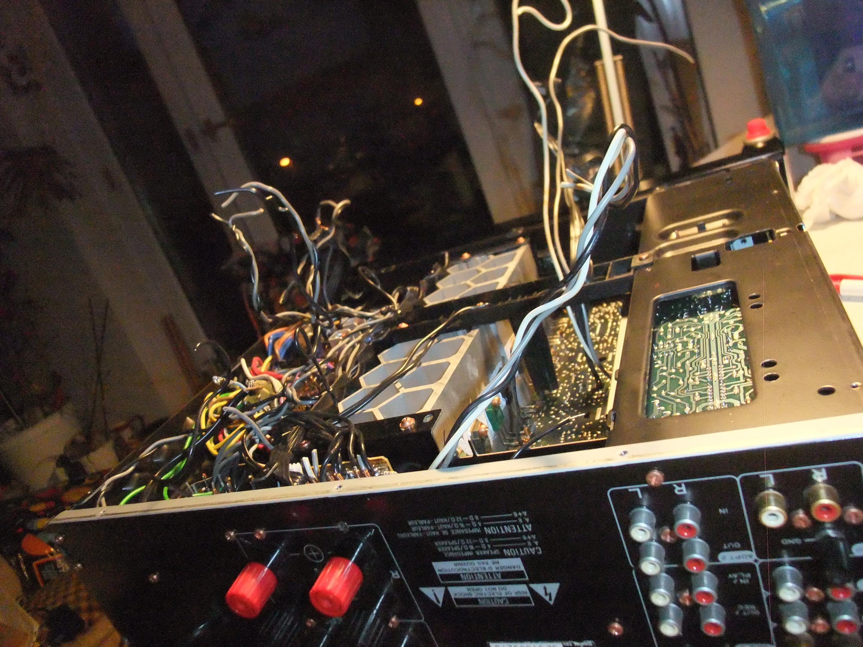

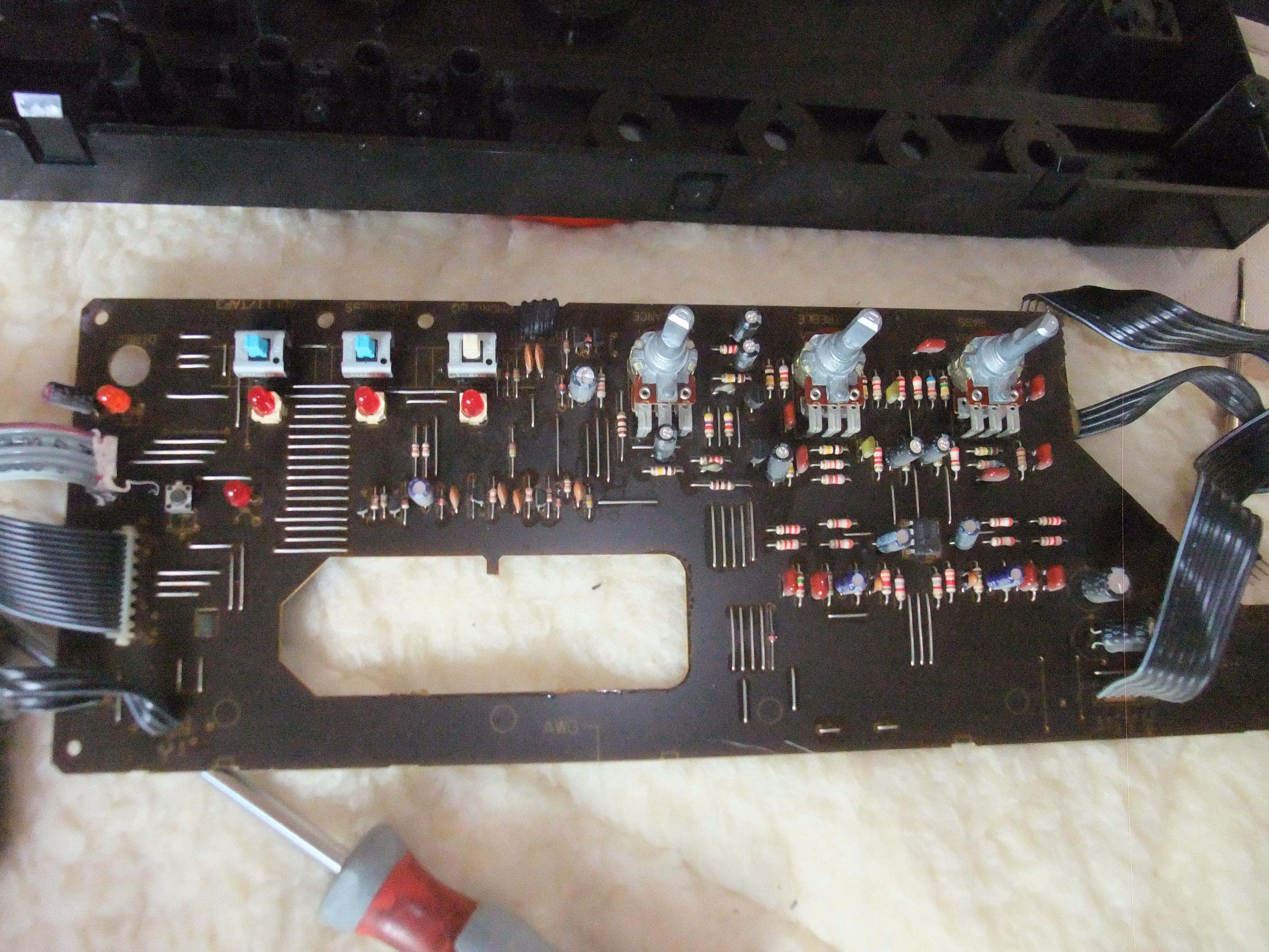

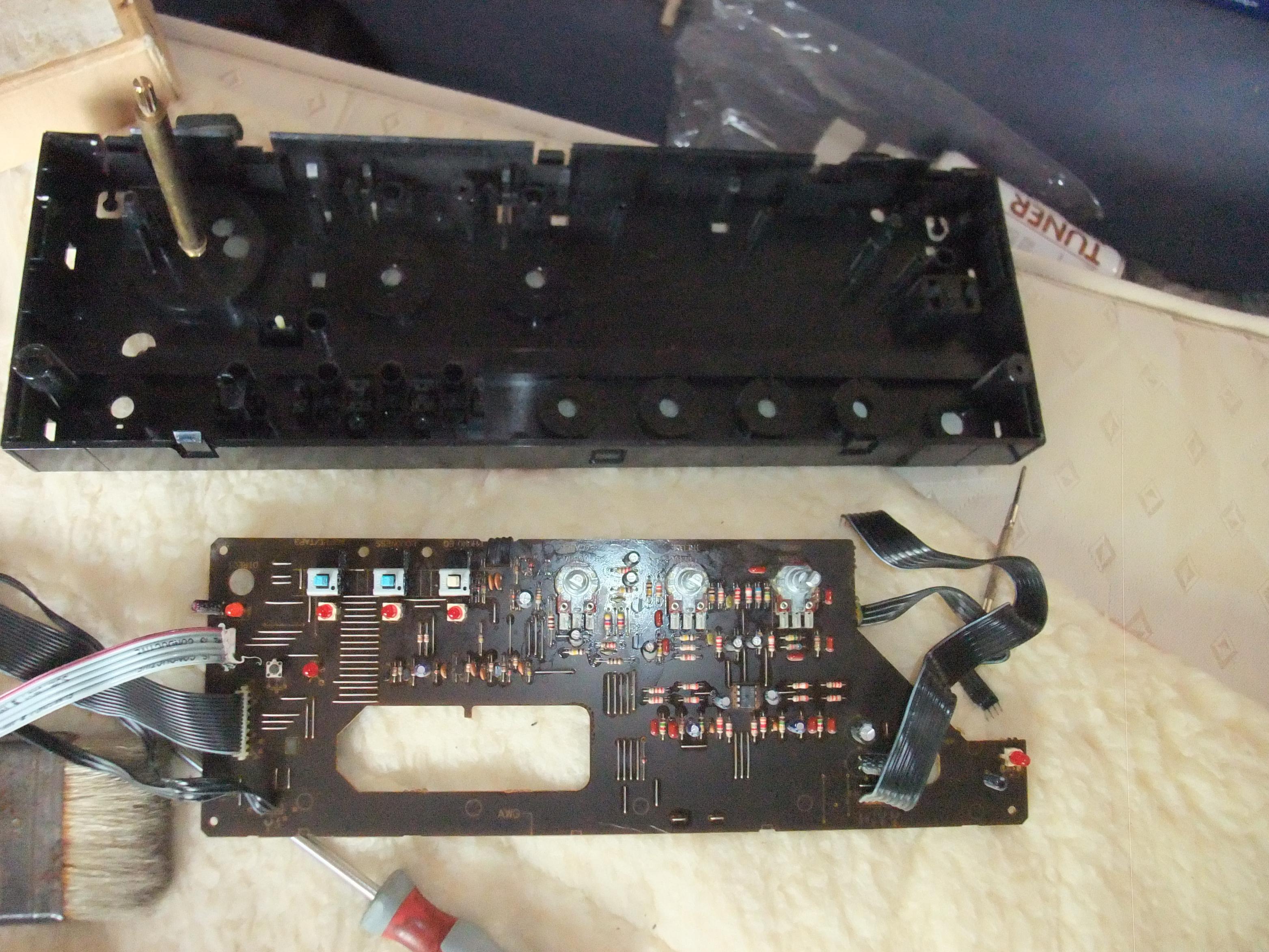

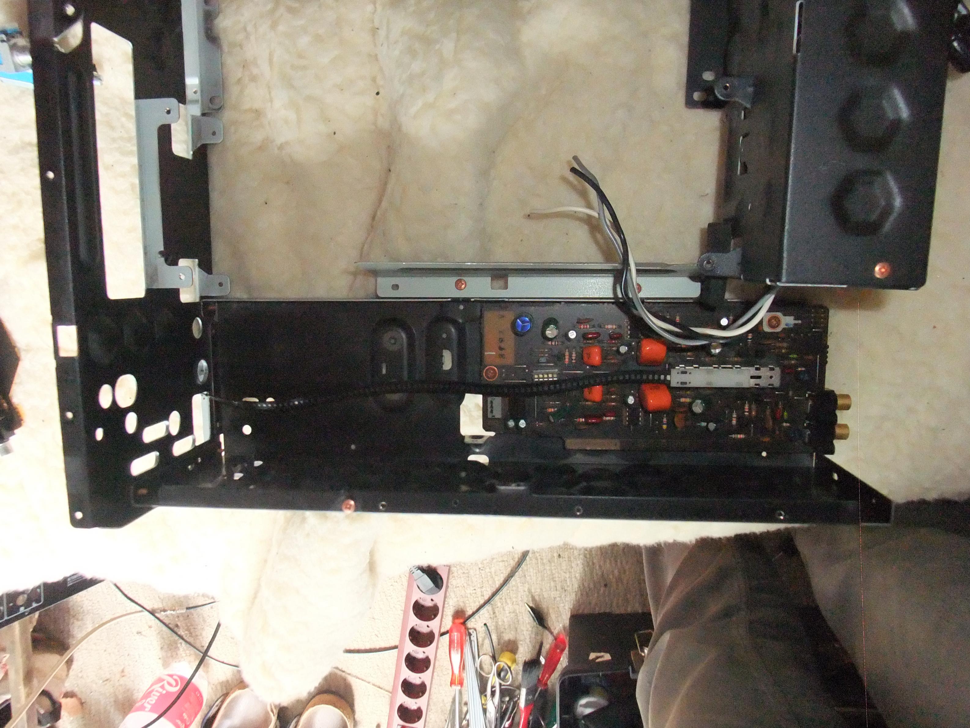

This integrated amplifier is the most complicated device ever (only in order for mechanical matters resp. disassembly).
Complete dismantling and assembly is definitely a challenge, but necessary to reach some areas around the input selection, volume control, RIAA MC/MM section and tone defeat switch - go to the attached images.
Now I am not able to perform a perfect assembly procedure. Where is to read the steps therefore ?
Thanks for an advice.
This links are not helpfull in this matter
Pioneer A757 repair, break & repair again - YouTube

Which repair company resp. service center is able to completely disassemble and assemble this amplifier without any trouble?
I ask this so that I can give an address to the next guy who comes with this amplifier that is in need of maintenance, so that he can send the amplifier to those company.

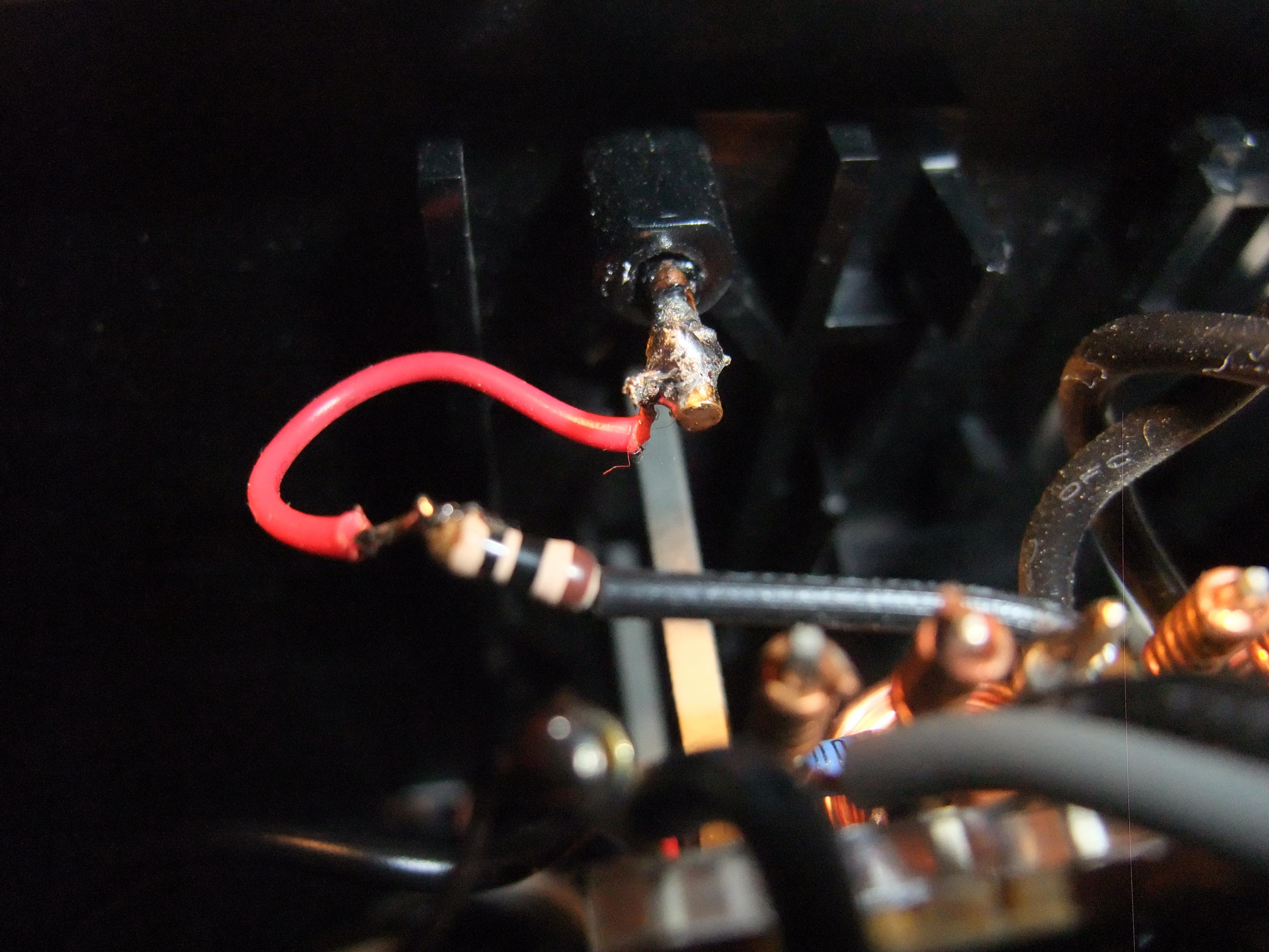

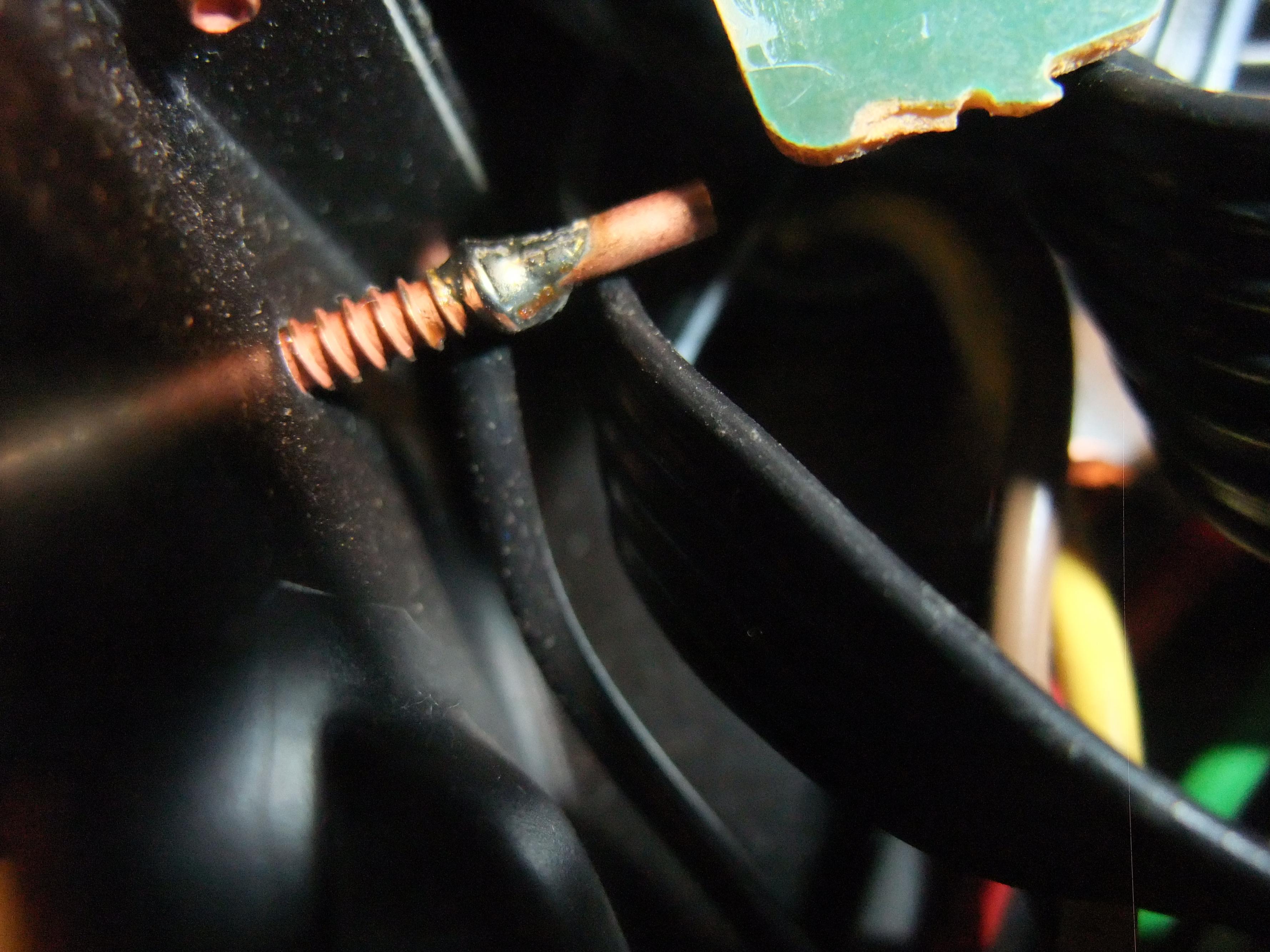

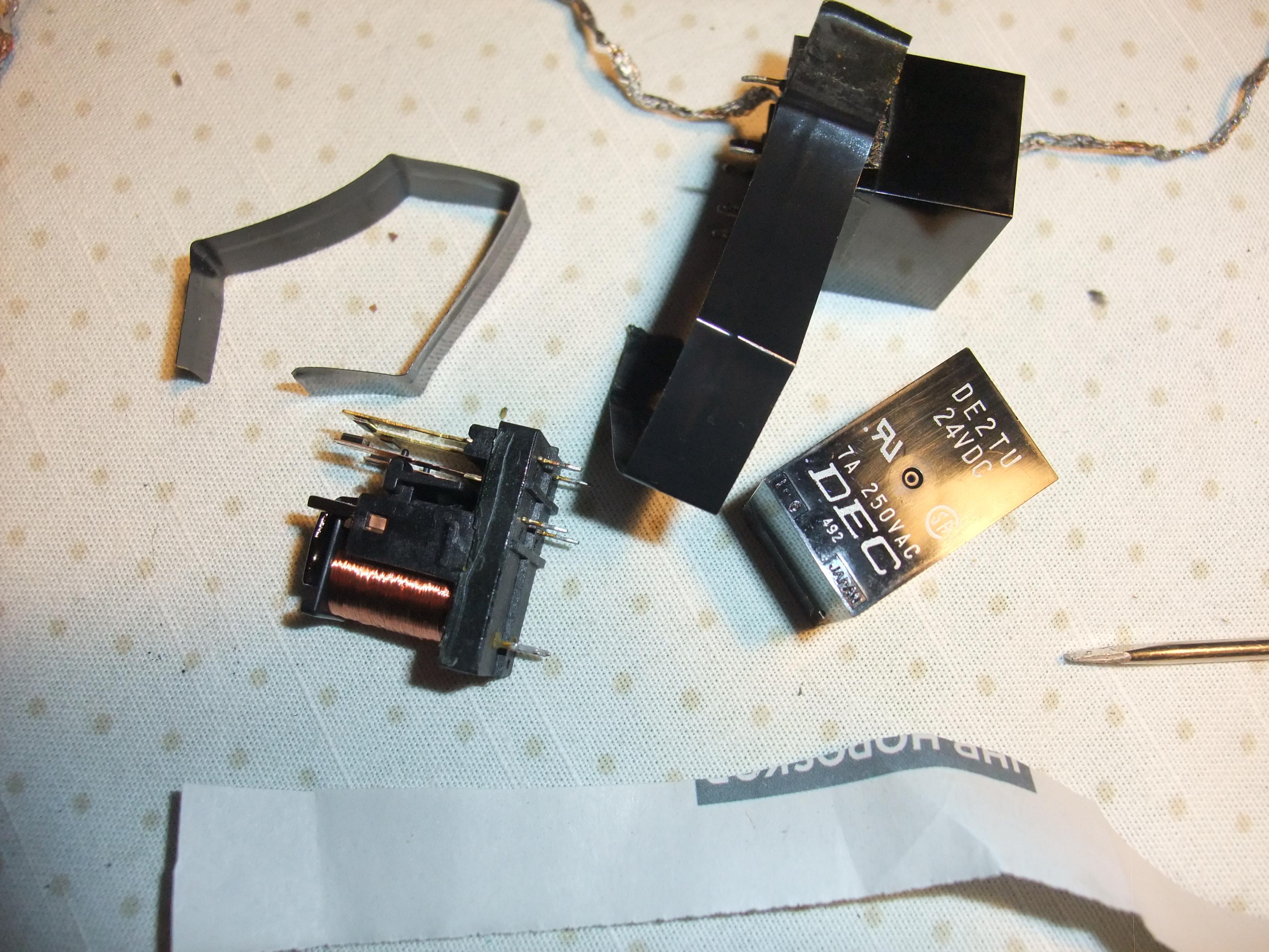

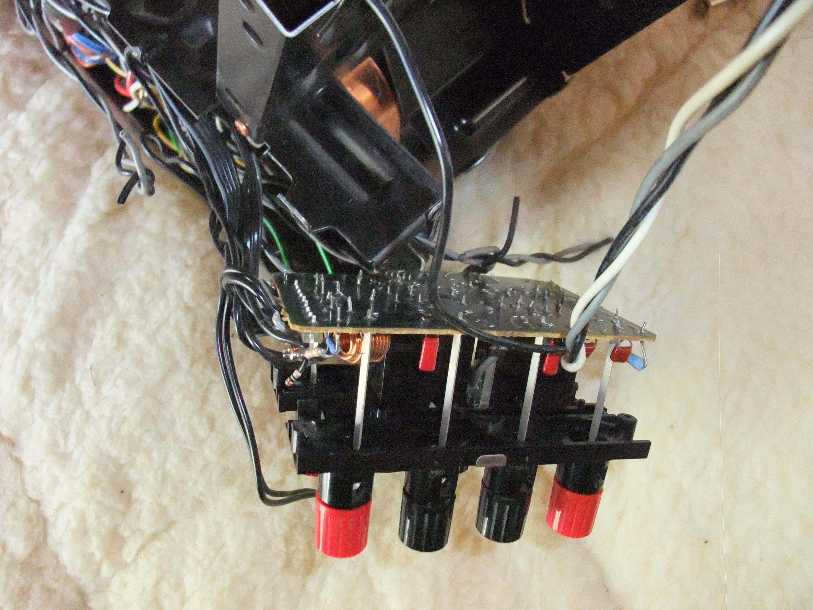

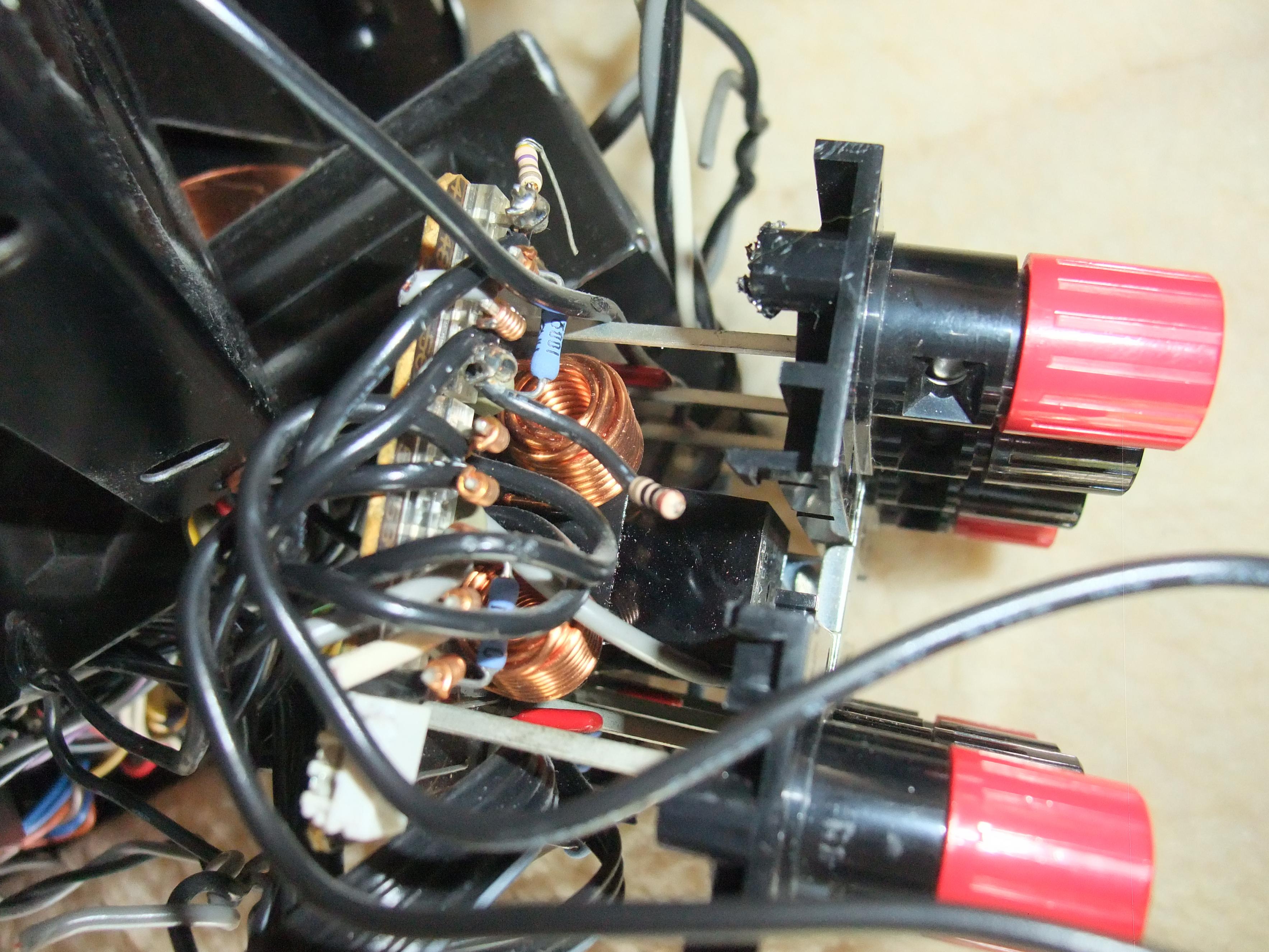

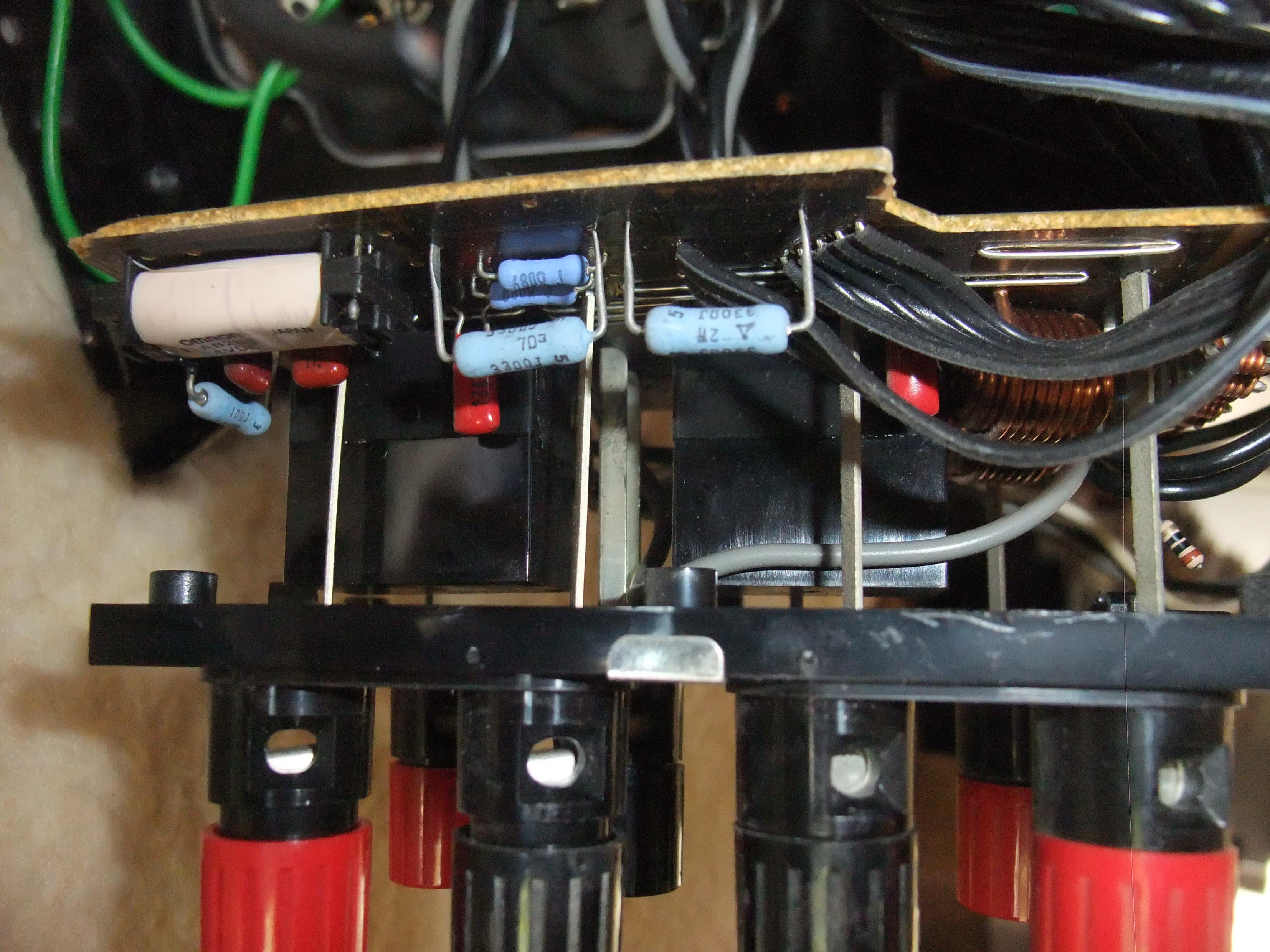

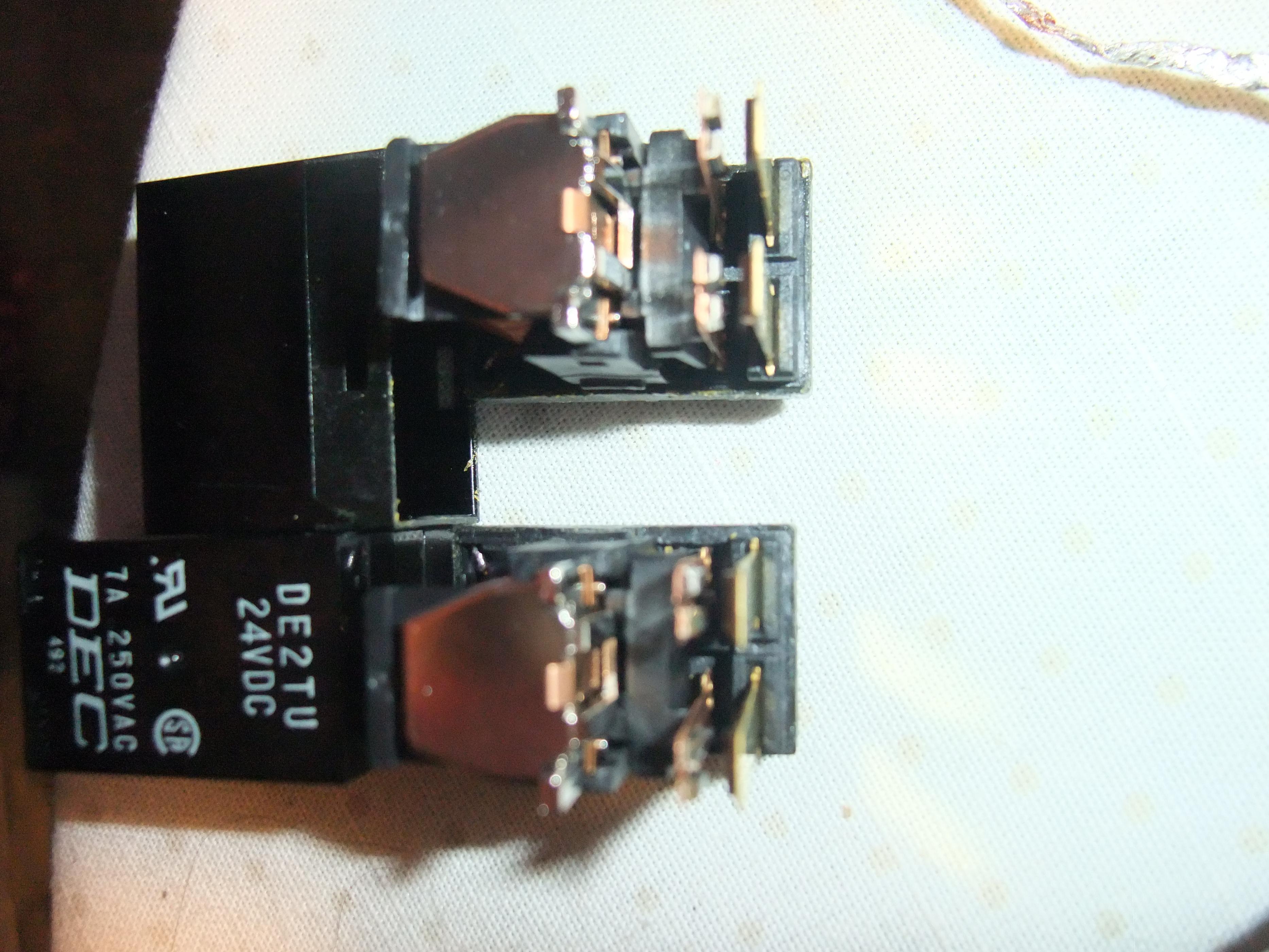

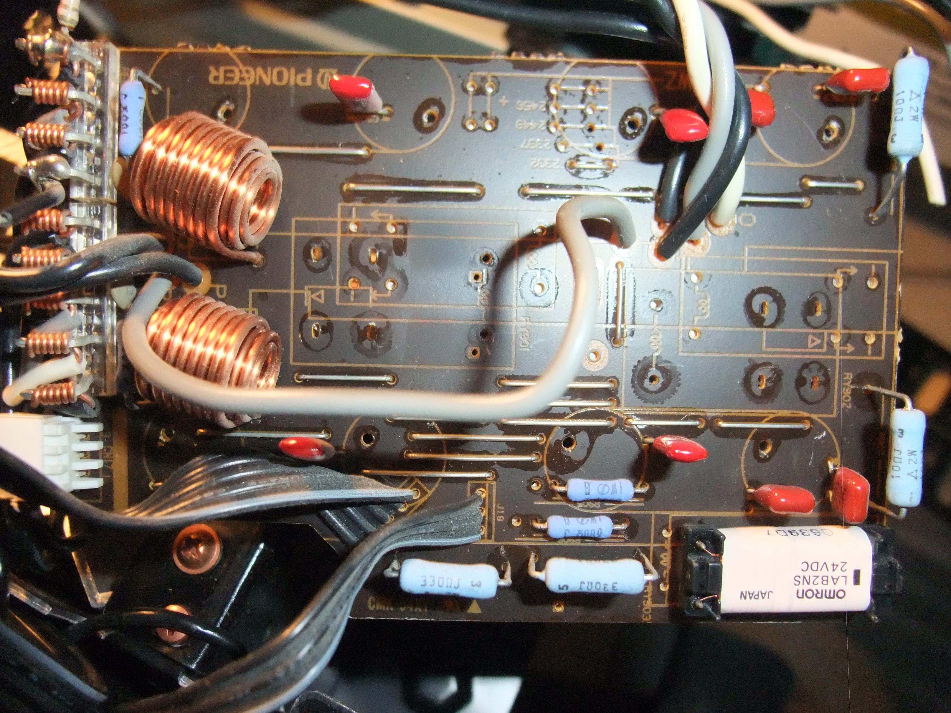

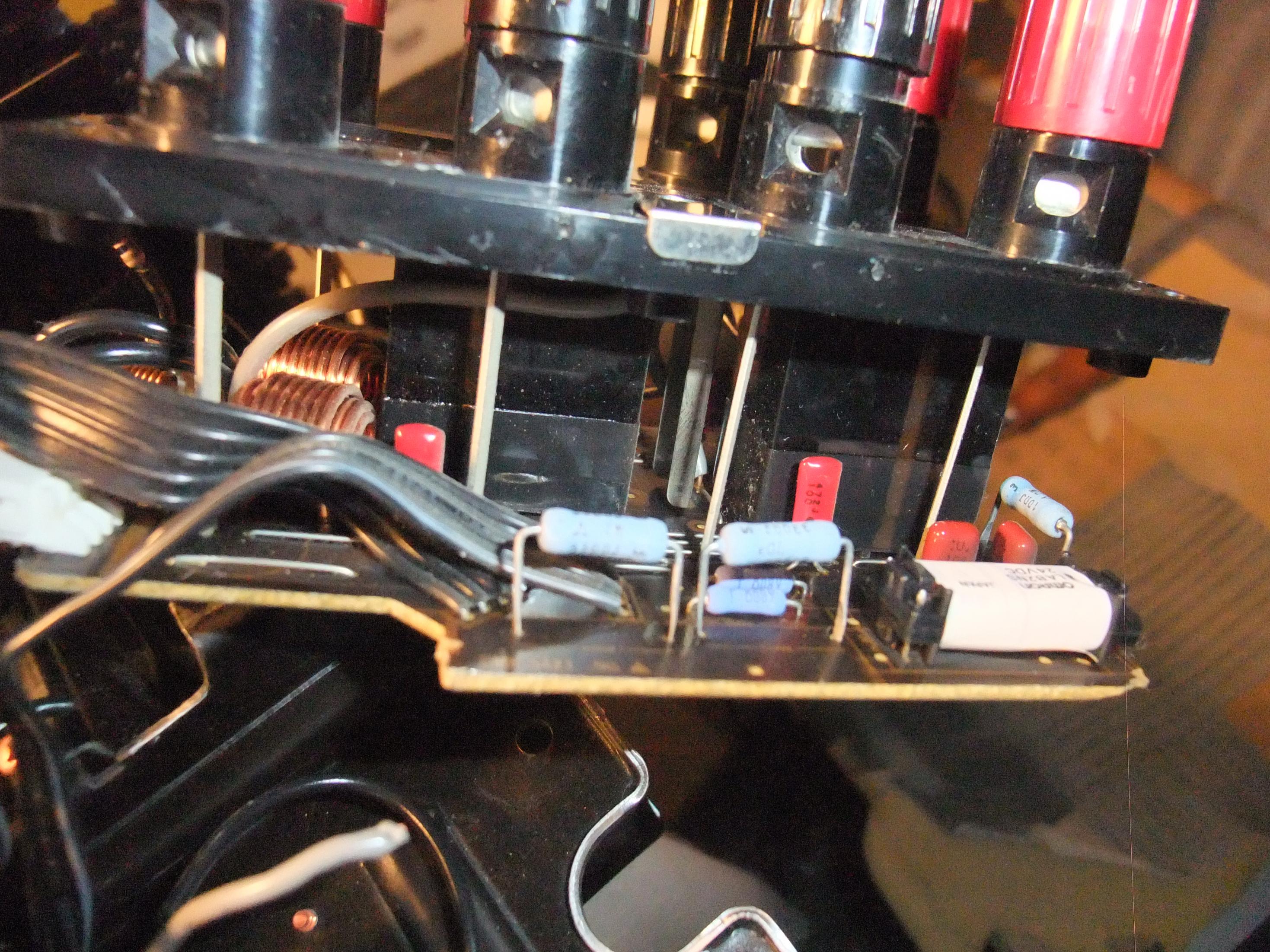

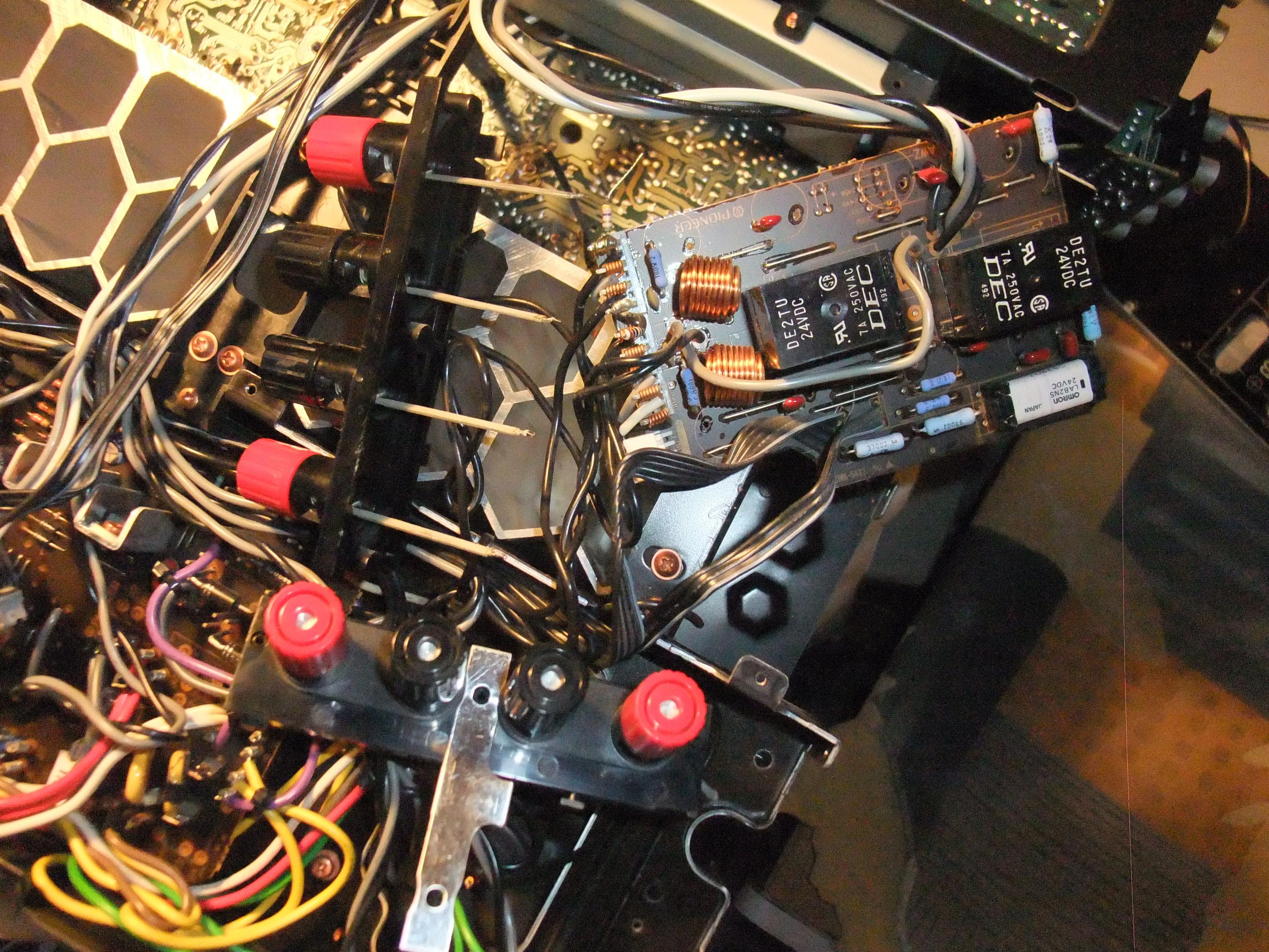

Desolder and opening Speaker Protect Relais
In contrast to most other amplifiers, this is also extremely complex and laborious with this model - go to the attached images.
Last image shows the not good method when not using solder tags and instead this the cable is soldered directly to the screw that needs to be removed.

Voltage Regulator PCB
Images from the removed board (images from regulator PCB in assembled condition post #7 (Power caps replacement)
Pioneer A757 MKII - Power caps replacement?
Due to the lack of a solder tag, a resistor wire was torn off when the screw for speaker terminal was opened (last image).

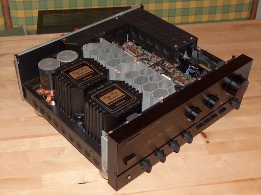

Very complicated, but very good amplifier.
One thing is unique in that whole series of Pioneer amps (A series from early 90s),
tone control is connected to loudness tap, so they act like a loudness in usual amps - decreasing when volume is up.
