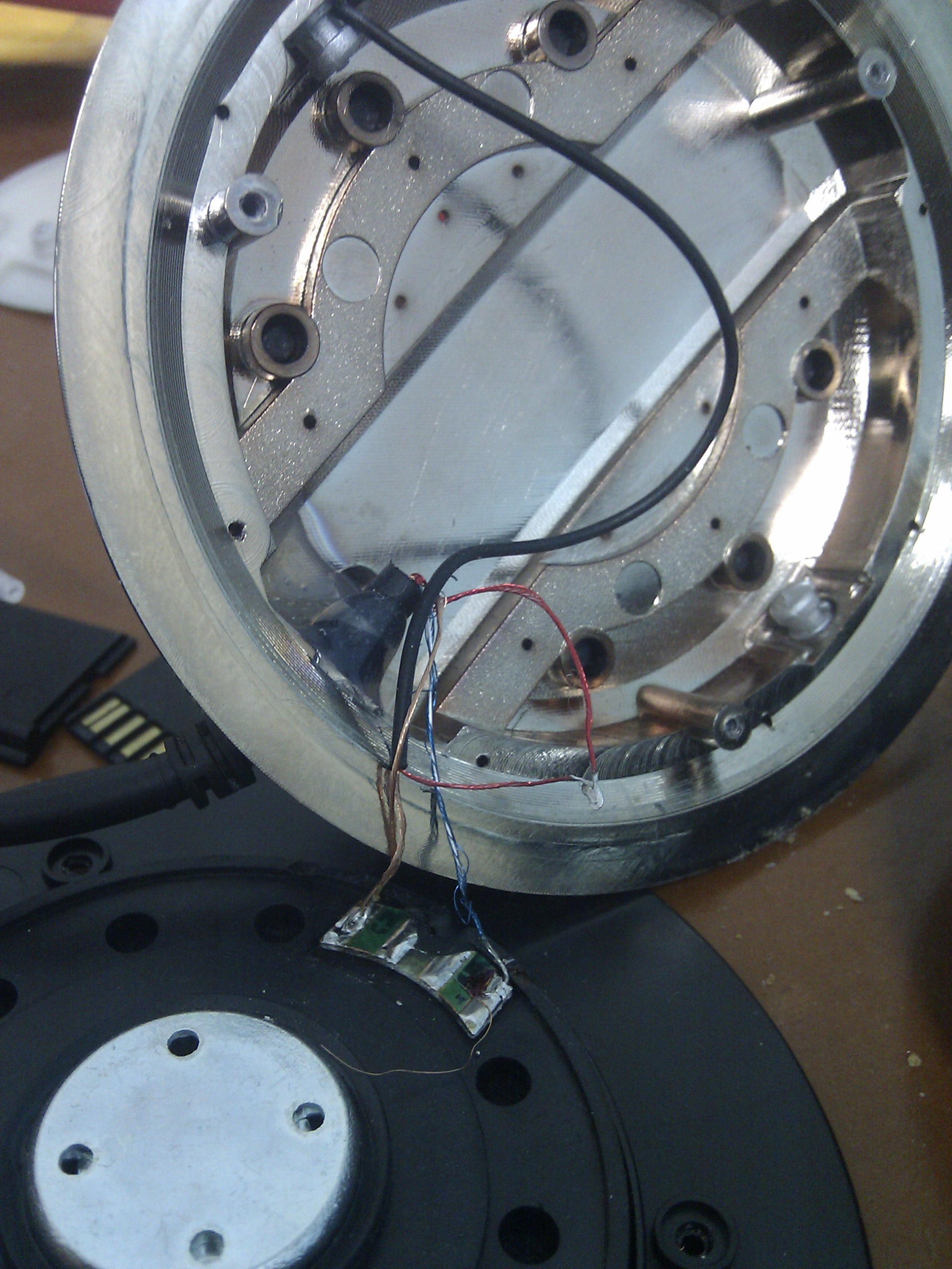

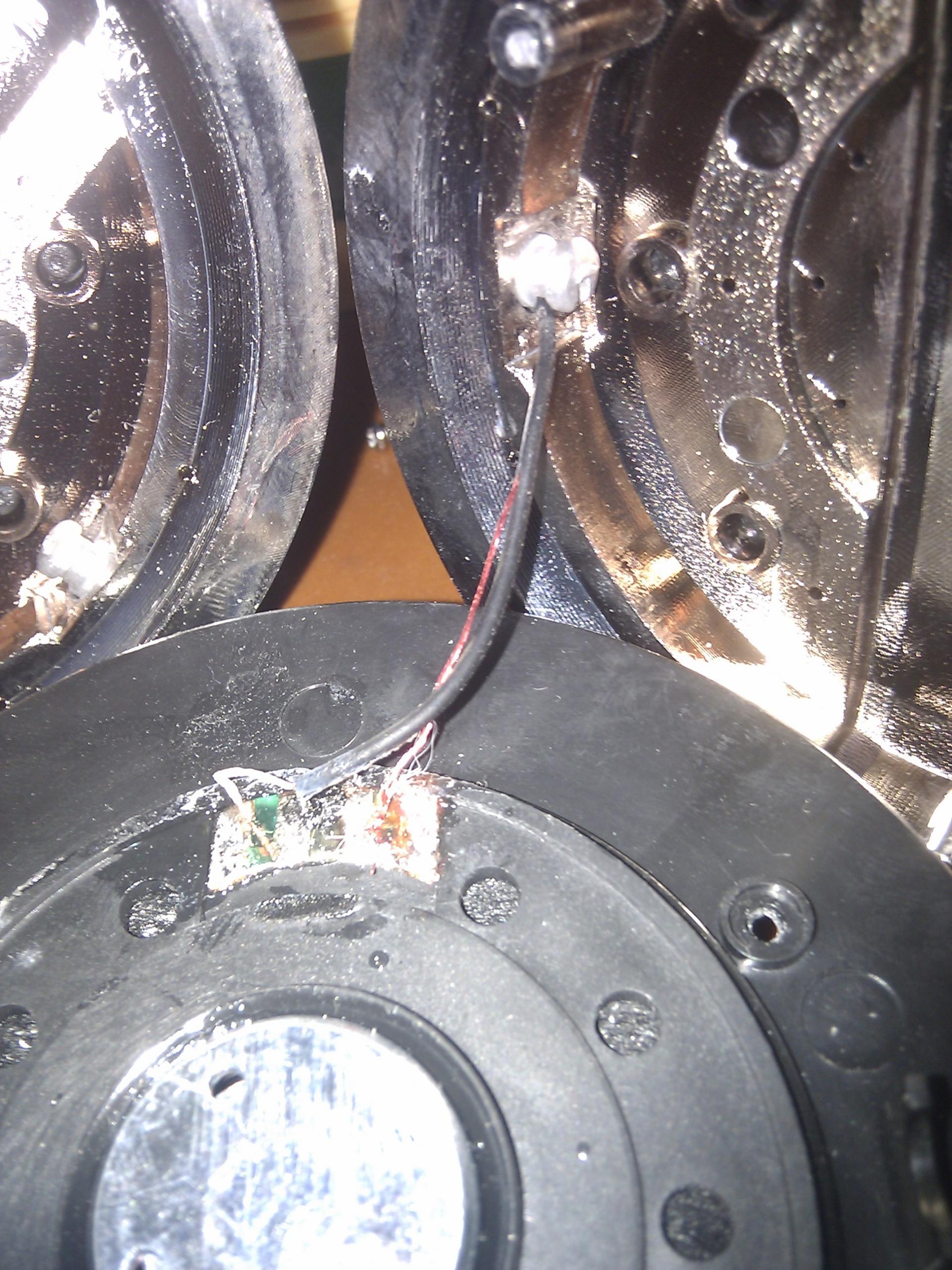

I took in these HDJ 1000s to the pioneer repair shop and the technician told me that he didn't replace the part that was damage just repaired it, and told me to be extra careful because it was very sensitive and the right channel could stop working again. Of course my father came in and raged and threw them on the ground.
I am not in the position to drop another $150 on them, So the story is the left channel works fine but on the right channel no sound comes out. I've attached pics of both the left and right channels.
The strange thing is when i have viewed videos on youtube of people demonstrating how to fix your hdj1000s...there's look very different from the inside than man. Perhaps you guys may notice it as well, but nevertheless please help me out and let me know if i can be of any assistance to get these bad boys working again 🙂
As a note, the right channel wires split off from the connector board as i was opening up the case so i superglued them back on. Aside from that, everything should be the same.
I think that's also why the sound was out again, the wires were disconnected.As a note, the right channel wires split off from the connector board as i was opening up the case so i superglued them back on.
You SUPERGLUED them back on?! First the wires need to be soldered to the appropriate terminals, then driver function checked (the channel should be working again at this point), and only then can one think of securing things with hot glue or superglue.
