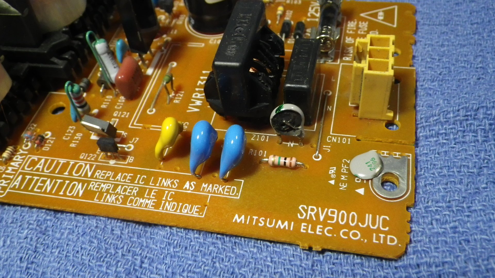

I pulled it from the rack and pulled the cover and right away saw the fuse was popped, so i tried a new fuse.

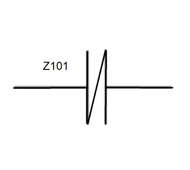

When I did I got an even bigger pop and the first part in line beyond the fuse, Z101, which looks like some sort of capacitor or thermistor?
I don't recognize the symbol but I'm used to Z being used on Zener diodes but this thing has a capacitor type symbol with a slash through it.

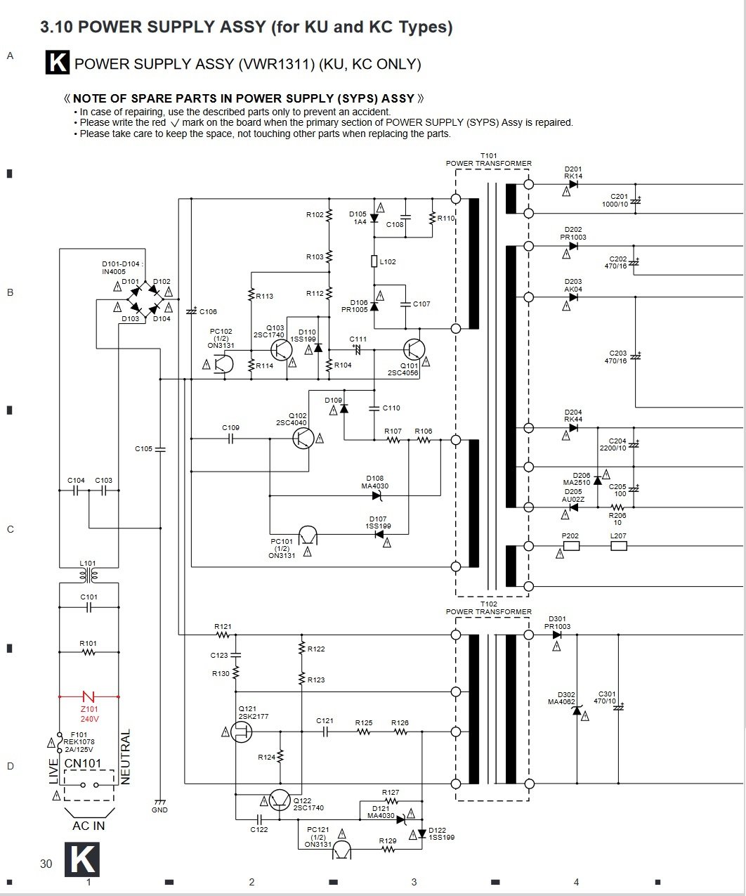

The diagram doesn't seem to say what Z101 is.
I've been trying to figure out what went on here because this is all before the power switch and the power should have been absent from the cord with the receiver off. I put a different CD player in its place for now and the receiver and outlet work fine?
There's a 241 and a 96 on the part that popped, to me it looks like a ceramic capacitor but its graphite inside, the dust it blew off was like pencil lead all over the area.

Anyone here know what the symbol is or what this is that popped?
If it's indeed a metal oxide varistor, and I also think it is, chances are that replacing it and the fuse will solve the problem. Large enough voltage spikes could trip a varistor and change it into a short circuit.

It can't be replaced by a fuse because its between the two mains coming in. It connects to both incoming power wires between the hot and neutral just past the fuse.
I've searched all over and can't find an explanation of the symbol anywhere.
Normally I'd expect the 'Z' to mean Zener Diode but its across the incoming 120v AC power leads.

If you can't get the original type of varistor, take one meant for the same voltage with the same or a somewhat larger physical size.
I still don't fully understand what happened. With a loss of neutral, the voltage can at most increase by a factor of √3. As the schematic shows that it is a 240 V varistor (I assume that means 240 V RMS AC maximum operating voltage) and 120 √3 V is less than 240 V, I don't quite understand why that triggered the varistor.
You would also have to assume that the preamplifier's relay control malfunctioned due to the higher voltage and switched on the output to the DVD player. That could be possible, of course.
You need a 275 vrms rated part for replacement if your mains is nominally 230/240 volts, I'm not sure what the recommendation is for 120 volt mains so I'm not going to even suggest anything for that but I can say that for testing your player you can just leave it out. If the player has suffered damage then there is no point sweating over replacing the MOV at this point.

I'm not fully convinced that its a varistor with that marking. Oddly the shop manual doesn't even call out that part or its existence there. The coil ahead of it is called a Coil Pulse Transformer in the manual, (L101).
Just ahead of Z101 is R101, a 1M resistor, and C101 a capacitor are before the black coil pulse transformer and neither the resistor or cap are damaged.
What gets me is how the cap survived an over voltage like that? If Z101 blew, it would only increase the load on the cap and the 1M resistor, but those are fine. As is the L101.
Could the varistor be there to stabilize in coming power to the transformer? That combined with the 1M resistor it somehow corrects any variables in the line voltage coming in?
With out Z101 in place, then it wouldn't it overload C101 or R101? But they survive, and it still blows the fuse.

The manual completely leaves out any component lists for the Power supply board, only the fuse is listed in the parts list, the board is only listed as a complete unit.

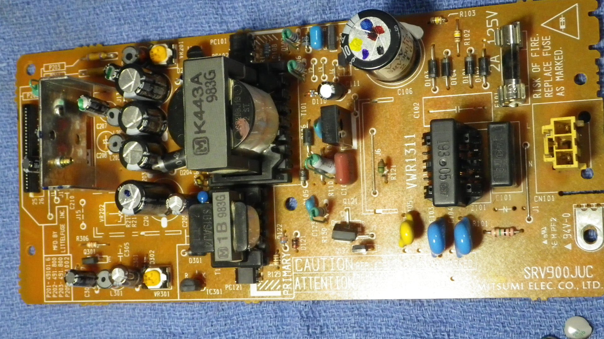

I pulled the power supply out of another 525, swapping out the board gets the unit working as it should, so the damage didn't extend beyond the psb.
Oddly enough though the other unit has a slighty different layout, but the same number on the board

Whole view of PSB

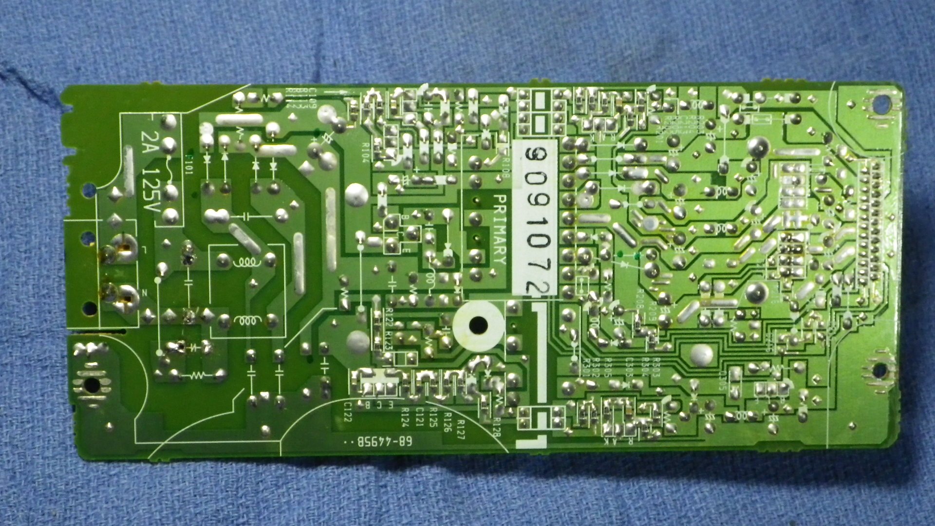

Underside, flipped horizontally from above pic.

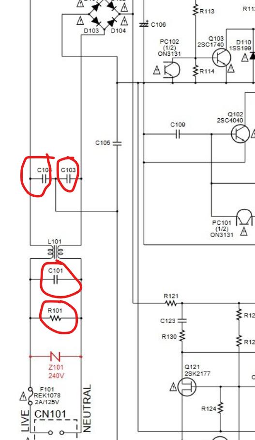

With the bridge removed make sure these caps are OK and also that resistor. C101 would be favourite. They may not read short on a DVM but could fail when voltage is applied.
You can remove and link out L101 as a test. It is a 'common mode choke' just to prevent interference escaping for the PSU back to the mains.

If I remove L101, the short is gone, if I jump it, the short is gone.
I have a DBT but I've been using it with a 60w bulb. it lights the bulb but sill blew the 2a fuse. I didn't think to try a lower watt bulb I guess. What I don't see is how that choke is shorted, it should have no direct cross to the opposite pole, its a hollow core with four loops of enameled wire.
