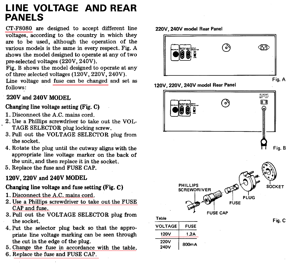

I have an older Pioneer CT-F8080D cassette deck that I'm working on and I think I blew a fuse. There is no fuse inside the unit at all. The voltage selector plug on the back says fuse above it, so I believe there's one in it. I can't figure out how to remove it though and I don't want to break it. Any help would be appreciate.
Thanks!
