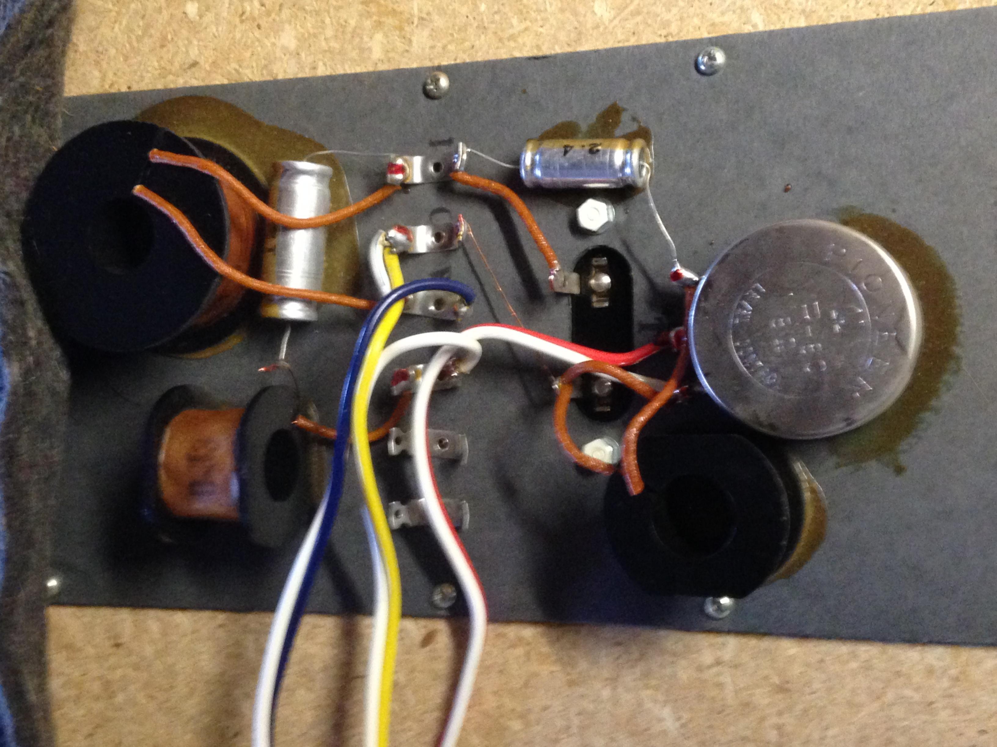

Hi To All,
I wanted to give an update on my Pioneer CS-77 crossover mods that Steve Ponsford (aka. system7) suggested awhile back. I have attached a photo of the completed work. Try not to laugh to hard, this was my first time soldering on this level. Everything turned out great. My test album Dire Straits Brothers in Arms sounded very good. Bass is much improved and overall sound is much more detailed compared to the original crossover! This is an awesome forum with very helpful members. A special thanks to Steve for sharing his superior knowledge of crossover design with me.

Hi montana1,
Make sure everything is stuck down securely. Don't trust glue / hot glue / silicone for everything. You do need those things to kill rattles though. RTV silicone might be your best bet, the high temperature kind judging from the look of the top right coil.

Thanks Chris,
I just used hot glue. Everything seemed secured to the board. Maybe not bound down like that old coil was! That was a beast to cut from the board. It was like an epoxy substance.

Hi Rich,
Well, to avoid having to venture in there again, use the Silicone I suggested. That would work really well as it stays flexible.

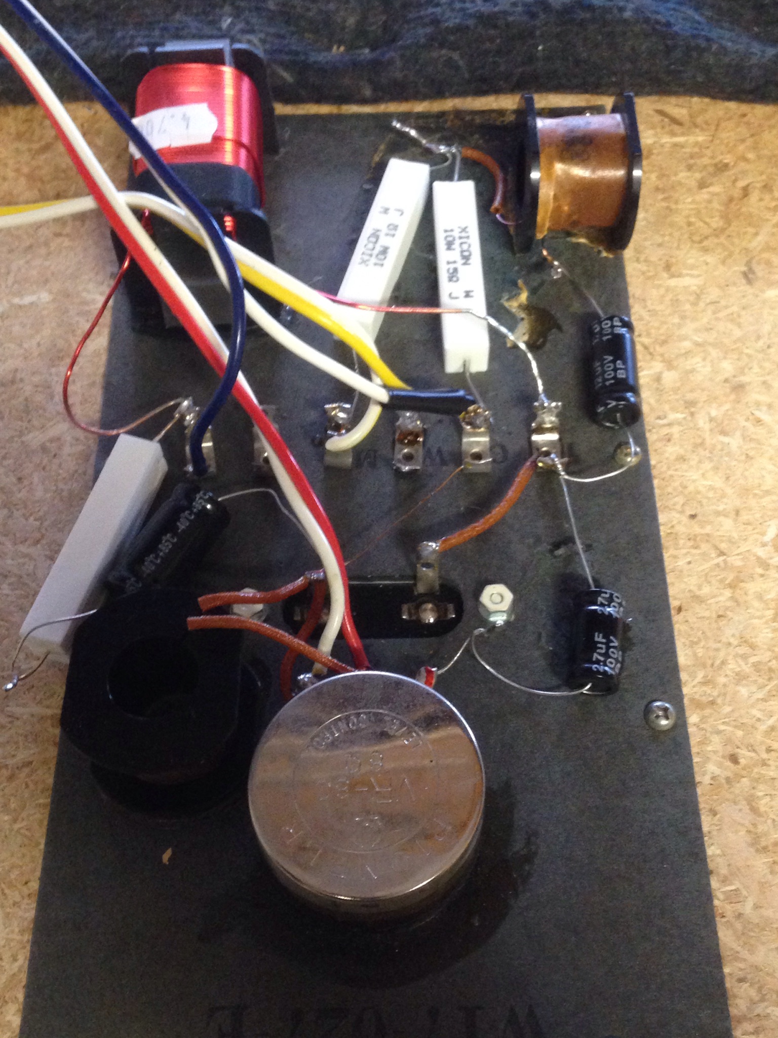

Like SO, except we changed the 33uF to a 22uF IIRC:
How does it sound? Is it balanced? I was a bit worried I might have gone overly bassy...but you can adjust things. 😎

I proposed improving the bass rolloff with second-order 4.7mH coil and 3.3R plus 22uF shunt.
Add a 1R/15R attenuator to the mid and wire it negative polarity. The rest is unchanged. See how it sounds.

Steve,
Great to hear from you! I'm very pleased with the sound. It certainly is not overly bassy. I'm thinking of further adjustments down the road consisting of a baffle change/ redesign. Something like the Seas 503 kit. That is why only cheap caps were used at this time. I have started 'The Core' two way build from Paul Carmody and once completed; I will re-visit the Pioneer baffle idea. What I really need is to acquire some testing equipment.

There's nothing wrong with using a cheapie NP electrolytic in a bass shunt with a resistor of 3.3R. See any marginal ESR of around 1 ohm just gets lost.
TBH, I don't believe in overly expensive components. Tiny differences. 🙂
TBH, I didn't want to mention it, but I'm slightly concerned you may have placed the attenuator in front of the LC mid filter rather than after it, thus subjecting it to bass energy. But it probably won't blow up. Sturdy 10W resistors. 😀

Steve,
I could be wrong but I believe the attenuator is after the mid coil. I looked at schematic probably a 100 times (or close to it. lol) . If its incorrect its not to late to change. But, I came off positive tag on right side of photo with 12 uf cap, then through .33 mh coil, attached 1 ohm resistor running to positive tab for mid speaker and ran 15 ohm resistor lead to ground tab. Wired the mid neg at speaker itself. Does all that sound correct?
