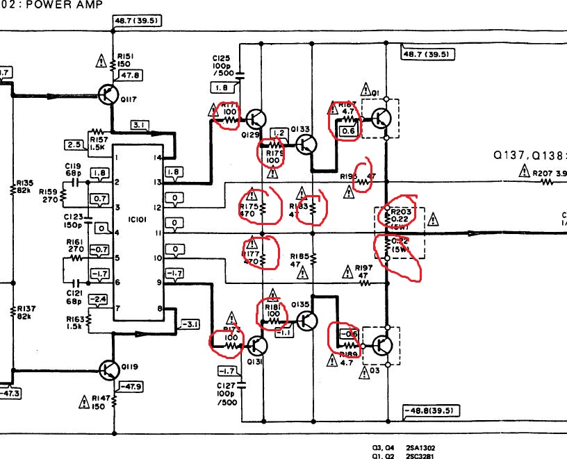

Im trying to work out a fault with this and can't seem to get anywhere. Basically there is full rail voltage on the right channel output. Output deviced have all been disconnected and tested fine but the voltages seem to all wrong. I get rail voltage on both the collector and emitter connections and half voltage at the base which decreases over time I assume due to the 6001 bias throttling down.
The left channel seems ok with rail voltage on one side and nothing on the other although base voltage is high at 3v and the predrivers get incredibly hot within seconds.
I have gone through the circuit diagram and can't work out what's wrong.
I have checked all transistors by swapping from left to right channel and the 6001 chip and everything stays the same. I have reflowed the board to eliminate dry joints. I suspect an open resistor somewhere but they all.check ok in circuit.
Any ideas, I'm thinking of the voltage divider somewhere is open but I am right in thinking that this would still show as ok in circuit due to ti the way it works?

Circuit diagram with voltages measured, I can't understand why I have this problem on both of the output device pins. One showing positive and one showing negative. Ive been at this for months!

I think we need more voltages than those two readings. Ten volts across the IC means it is trying to bias the output stage to destruction and not receiving feedback to 'turn the voltage' back down.
You should rig this up with a bulb tester to help prevent damage and perhaps even bypass the IC to force it to run as a conventional class b stage with no bias.

Wouldn't no outputs cause the IC to think there was no quiescent current flowing and so ramp up the bias voltage... which is what you seem to have. Although I can't see the full circuit, it looks to be a feedback type system similar to the LT1166 bias spreader IC.
Apologies for the brief readings, just trying to separate where the fault lies. As the fault is mirrored in both the negative and positive side of the channel is there any ideas of what to measure that is in common here?
The fault was present with the outputs attached so I removed them to avoid damage, however, the fault is not present on the other channel, which is running at 5v

We need to do a lot voltage measurements to see why the output is stuck at a rail. I also need to see the full circuit of the power amp to see how its configured.

You do need the outputs fitted because of the bias spreader IC.
Before you refit them, check to make sure all these marked resistors are OK. You can check them in circuit as long as the reading you get agrees with the value. If there is doubt then isolate one end.
Key voltages to begin with. Be sure to measure them all to confirm they are good.
1/ Collector of Q1. This should be positive rail.
2/ Collector of Q3. This should be negative rail.
3/ Voltage at the junction of the 0.22 ohm resistors
4/ Voltage on pin 13 of the IC.
5/ voltage on pin 9 of the IC.
6/ Voltage on pin 12 of the IC.
7/ Voltage on pin 10 of the IC.

Do you want Voltage ref to ground or across the resistors?
Voltage referenced to ground for these initial readings, and keep a steady hand, you definitely don't want the probe to slip as that could be disastrous. Fix the black meter lead to the chassis or ground first, then you only have one probe to worry about.
The diagram you have circled is the good channel, is that right? One point I did notice is q136 (predriver) in the bad channel is cold but does have rail voltage on all pins. The other predrivers are extremely hot, I assume due to no outputs?
Measure on the faulty channel. I worked to this one with it having all the component values marked.

Dan, the biasing arrangement on this amp is different to most in that it uses a bias spreader IC and not a traditional vbe multiplier.
If you disconnect the output stage collectors (assuming all else is good) then the drivers will attempt to deliver the full bias current via the B-E junction of the output devices. If that preset bias current (and the bias appears non adjustable) were say 100ma then the drivers would be dissipating 5 watts apiece and could fail.
