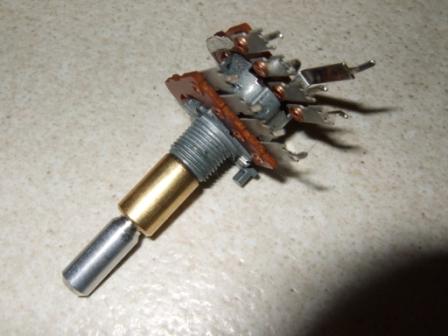

Not only do these have 2 rows of 4 pins but they also have a leg out the back to ground the pot body as they are mounted on a plastic recess. If a pot is replaced, you have to be sure to ground the pot body.

The markings are printed on the opposite side of the pot body to the ALPs Japan markings which are indented.

Edit: BTW, when I took mine apart to try fix it, I discovered what the 4th pin is for - it's another alternate ground pin - so the pot can be used with the 1st 3 pins for operation one way or with 3 last pins for operation another way. I think the difference in operation is got to do with where the knob gives minimum resistance - if you look at how the pot attaches to the front panel there are small two holes on the inside - the lug on the pot can slot into either hole - these twist the pot 90 degrees so the minimum resistance position will now be different by 90 degrees. I hope all this makes sense?
Anyway, just saying this in case somebody could use this to overcome a bad channel on one side of their pots?

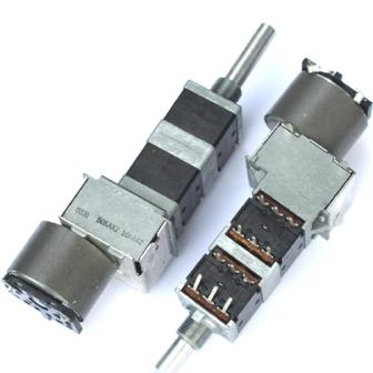

It's also expensive in comparison to this motorised ALPS QUAD pot for $15 : http://www.alltronics.com/cgi-bin/item/27P009/162/Alps-Motor-Driven-Quad-Pot

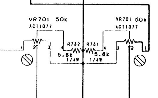

That pic looks the same to me. The 4th pin connects the wiper via a resistor to ground to do the log taper from a linear pot the same as this.
http://sound.westhost.com/project01.htm
If you have a look at the pot schematic you can see the use of pin 4 and the fake law resistor. This is done as it's a linear pot and not a log pot. If a log pot is used, then you would use pins 1,2,3 only and remove the resistors R731, R732. The body of the pot would have to be grounded and can be done via a washer and wire from the threaded area near the pot body to a ground point on the PCB.

My A400(X) schematic doesn't show any part nos but the circuit is the not the same as yours. R731 & R732 are both 100K & in series with the wiper of the 100K pot.
I can't extract the relevant section from the PDF (It's protected) & it's too big to post here. The relevant section is on page 6 at the far right & schematic is here: http://www.hifiengine.com/manuals/pioneer/a400.shtml
So my observations about the use of pin 4 are in relation to the A400(X) pots only!
Edit: Just noticed that you need to register to get the download from hifiengine so I hosted it on my web stoarge along with pics of the pot here: http://www.4shared.com/dir/9385701/7af7801e/Pioneer_Vol_Control.html
