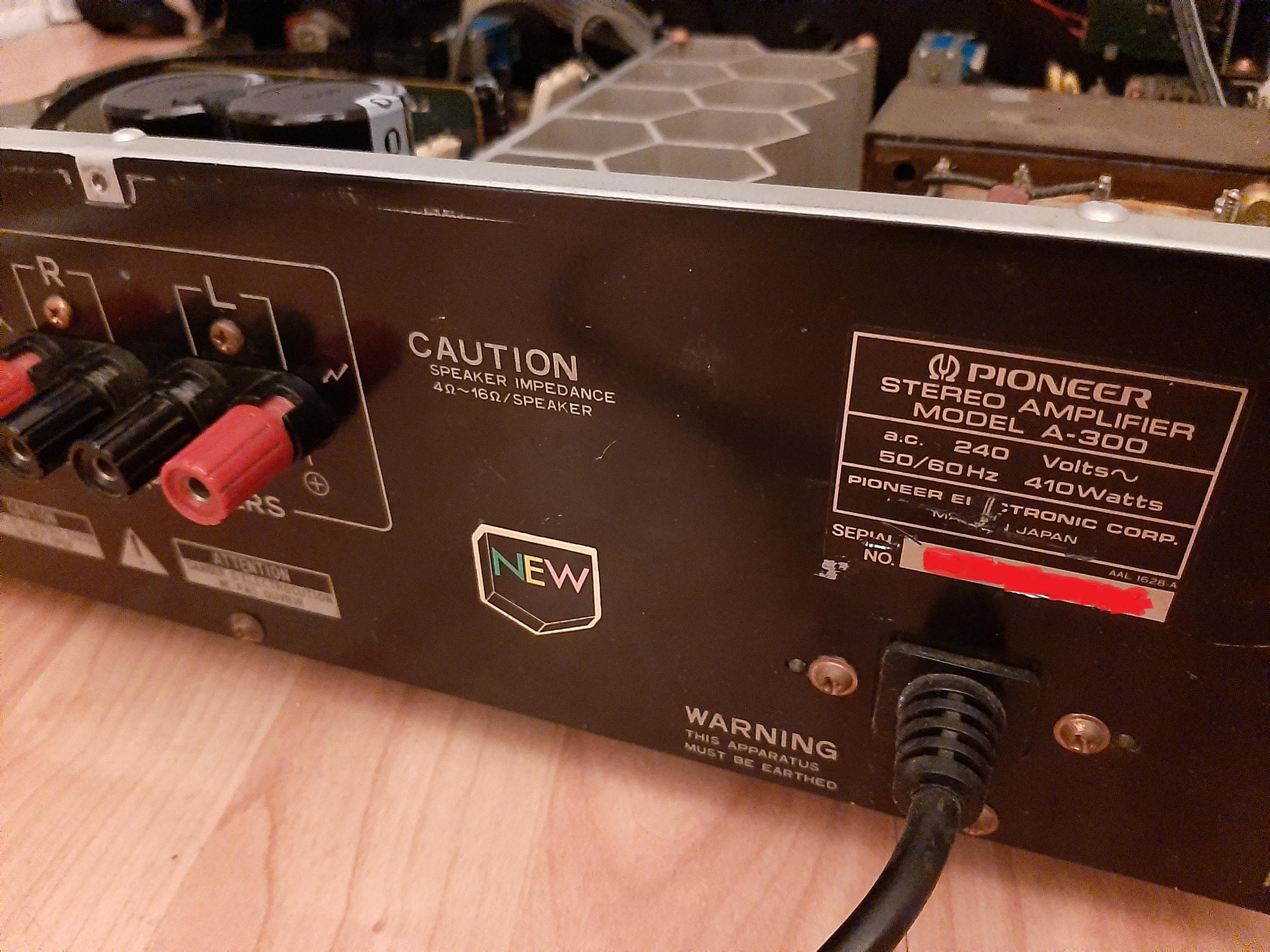

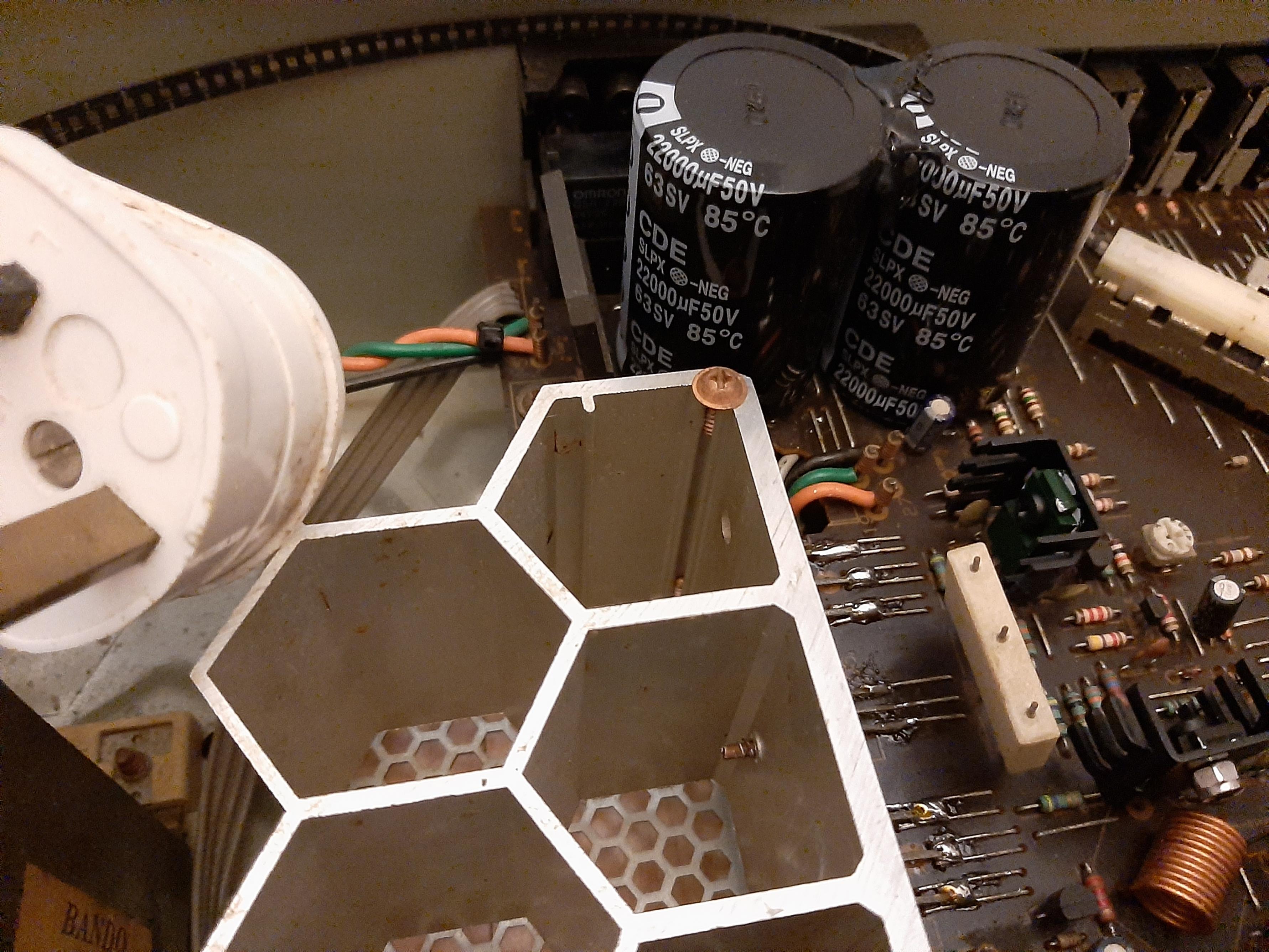

These are my 'go to' caps where space and voltage requirements allow.
Here's a Pioneer A-300 (and a Marantz PM-66SE KI)with the above caps installed;
https://files.diyaudio.com/forums/images/attach/jpg.gif
MARANTZ PM-66SE KI Signature PSU Modifications
The transformers haven't melted, the bridge rectifiers haven't exploded (although I used a beefier bridge in the Marantz) and the amps sound better than they did with the original/dead audiophool caps.
To my surprise, the modified A-300 sounded considerably better than an unmodified PM66-SE KI - astonishingly so!!!
Good luck with the A-400!
