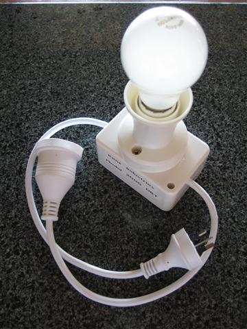

The 230/240v unit has pairs of fuses (2A) for each primary and they go into the matching 230 or 240 volt fuse clips. Check they are intact and installed correctly.
The multivoltage units can have problems with the rotary voltage switch on the back, but it's not wired in such a way that would allow two different primary voltages to be applied. That said, rotate it carefully and check it anyway.
I'd be checking the primary applied voltages to each transformer, the bridge rectifier etc.
I'd also be putting a DBT in line.
Of course, a dim bulb tester. 🙂 Anyone poking around inside an amplifier testing secondary voltages should know what one is.
If one were to type "DBT Diyaudio" into Google, one would find this quite informative thread: http://www.diyaudio.com/forums/power-supplies/167579-light-bulb-tester.html
Here's one I made up the other day for a friend who buys old gear and just plugs it in!
attachment.php
He got a stern talking to and he is now running a DBT (Dim Bulb Tester) and an RCD/ELCB (Residual Current Device/Earth Leakage Circuit Breaker) in line when powering up vintage 'finds'. 🙂
