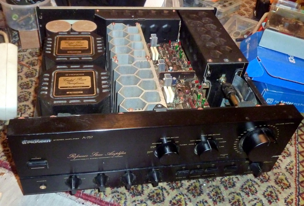

someone gave me this amplifier, which has been lying around in a garden-shed for the recent 5 years. It's about 30 years old and, if one is into integrated stereo amps, it's a nice amp to keep ( look at the specs, it's massive, powerful and even stable at 2 Ohms).
First repair was an electrolytic which was responsible for the speaker-output relais, which didnt pull. That was a known issue with this amp and I had a fitting electrolytic (ELNA 3,3µF/100V instead of ELNA 3,3µF/50V) in my spare-parts box,
Now it plays music, but only in "direct"-mode. The tone controls aren't working. I think I could repair it, with some more internet-recherche and some trial & error. Cannot be so difficult.

This thing is a real beauty. When I saw the 2 transformators I first thought of a dual mono configuration. But no, it's 1 for the positive, and one for the negative rail. It has no corrosion or any other "time-related" damages except of dust, and I cleaned it from top to bottom with Q-tips.

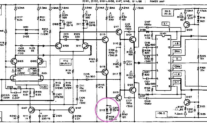

Problem is the PSU-PCB which is located "down under",and has no airflow around it. Electrolytics are dying. I measured one 100µF with 130µF, and all other 100µFs with 90µFs or less. I exchanged as much as I could, but I went out of Capacitors.
