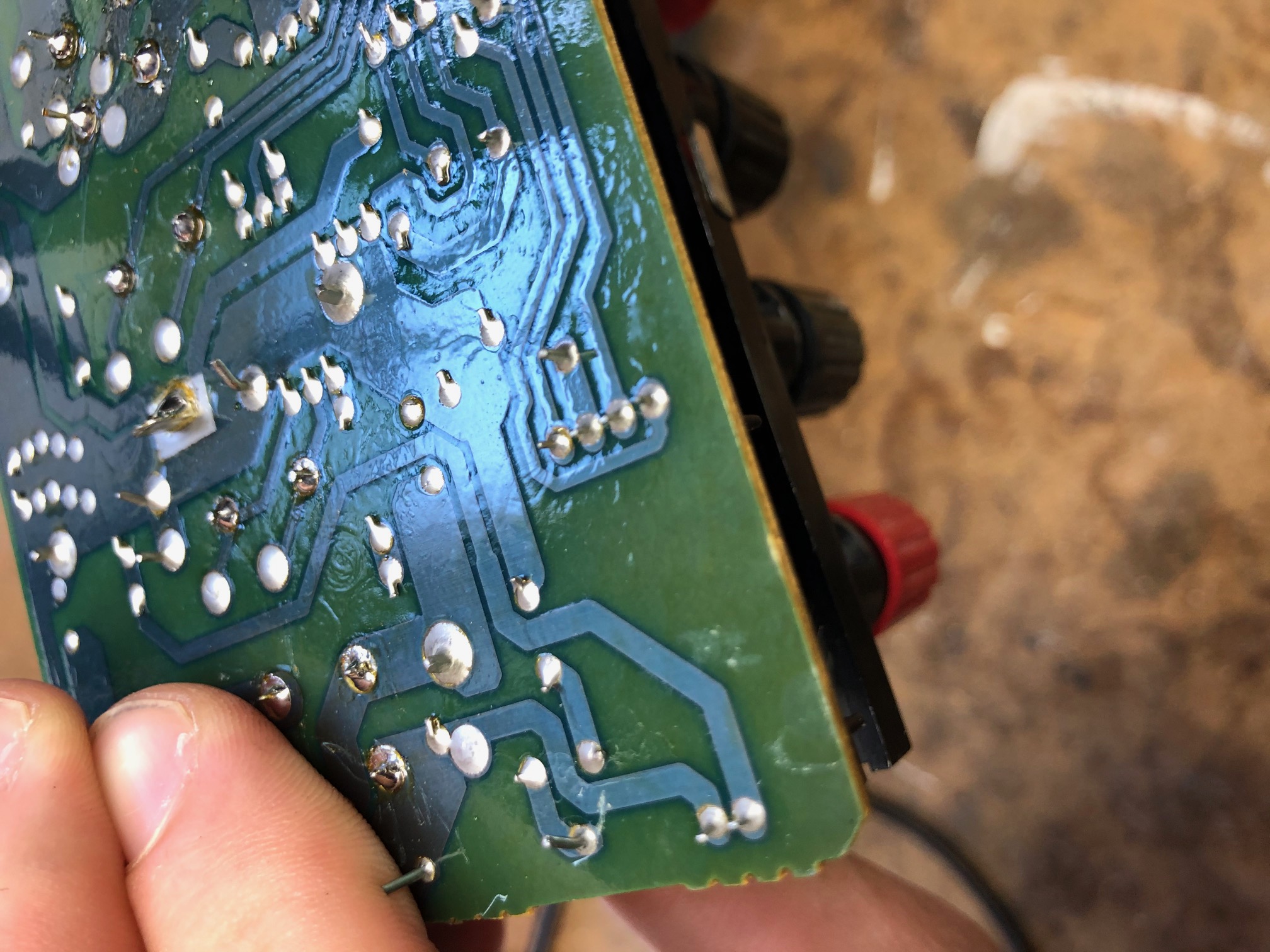

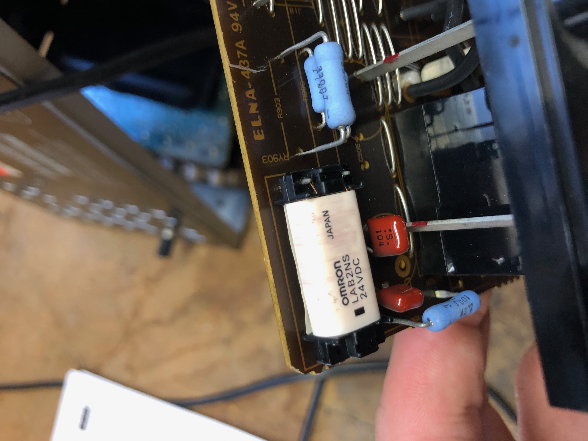

Hello there
I finally found some time to open up my Pioneer.
Seems the relays you're talking about is in fact one REED relay.
See pictures as attachment.
Can you tell me something more about reed relays used in amplifiers? My knowledge of these relays is industrial.. I know you use them for detecting nearby ferro materials but I have no idea why this is used in amplifiers..
Ps.: In the meantime I'm using my old dual cv5670 amp again and i kinda really like this one also!! Any thoughts on this one?

Hi Mooly
Thanks for the tip, will also check this. It started indeed after reassembling the amp after an earlier intervention. Could be the board was somewhat under tension assembled..
You don't believe in the reed relay?
Thanks for tip on attaching images. Didn't know you could do this. Pics attached as you asked.

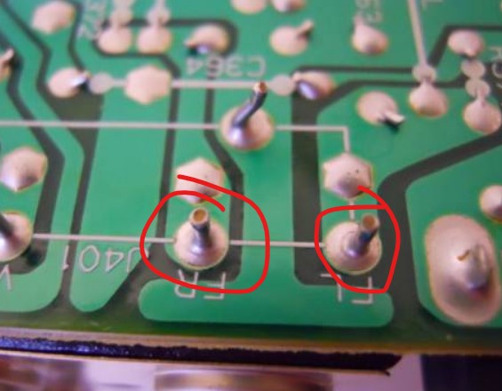

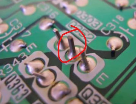

Your original fault description suggested something more than just a relay was at fault. If a relay isn't 'switching' it's more likely because it is being deliberately held in an off state rather than a problem with the relay itself. The act of disturbing it all to replace the relay could indicate a dry somewhere and the popping sound also points to something like that.
Dries can be hard to spot and typically look like this.
Another possibility is an intermittent failure of a semiconductor, usually a transistor that runs hot.
