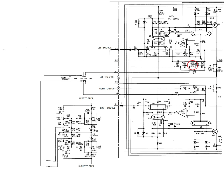

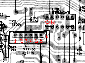

Here is a cut down representative schematic of the surrounding circuitry:
Q63 is the two channel OP Amp (It's a uPC4558C-P)
So, do you think it's the op-amp or is the problem elsewhere - what is causing R23 to smoke?

I agree that there's a short somewhere that gets introduced when the switch is in the line-straight position. But how best to find the spurious connection?
I'm gong to ask several questions, but I'll tell you at the outset where I'm headed: I want to explore the semi-radical notion of leaving the switch in the problem state where the resistor smokes, on the assumption it will be easier to locate the defect. But I want to avoid any damage to the amp other than to R23, which you probably intend to replace anyway.
I surmise the amp functions without obvious damage when returned to tone-control mode? I suspect Q63 opamp is ok if the other channel works and if the left channel returns correctly to near 0V when tone control position is selected. Please advise if this not the case.
For perspective, I note that 0.5W dissipation in 220R corresponds to about 10.5VDC applied voltage, and to make obvious R23 smoke will require even more voltage.
Is R23 surviving the smoke producing sessions? Can you make a quick measurement of voltage across R23 while it smokes? Perhaps you could install a temporary higher Wattage while you troubleshoot? But don't let me goad you into a test method that jeopardizes your amp.
If you become comfortable with pursuing this approach, I suggest trying this probing technique: tie one meter probe to the powered end of R23 and poke with the other meter probe until you find a circuit node that yields 0V. That's likely the shorted path.

So, I have the amp on a dim bulb tester (DBT) with a 100Watt light bulb.
At this point though, R23 has been toasted and is now in an open state. It does not survive puff the magic dragon if the amp is left on.
When I turn it on in NON line straight (signal going through tone control circuitry), the amp the amp settles, the DBT bulb goes dim, and the amp comes out of protection with a nice audible click.
When I turn the amp on in Line Straight mode, the DBT bulb stays bright indicating a short and the amp does not come out of protection.

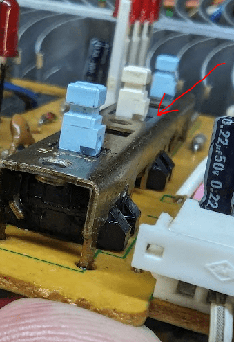

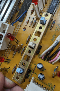

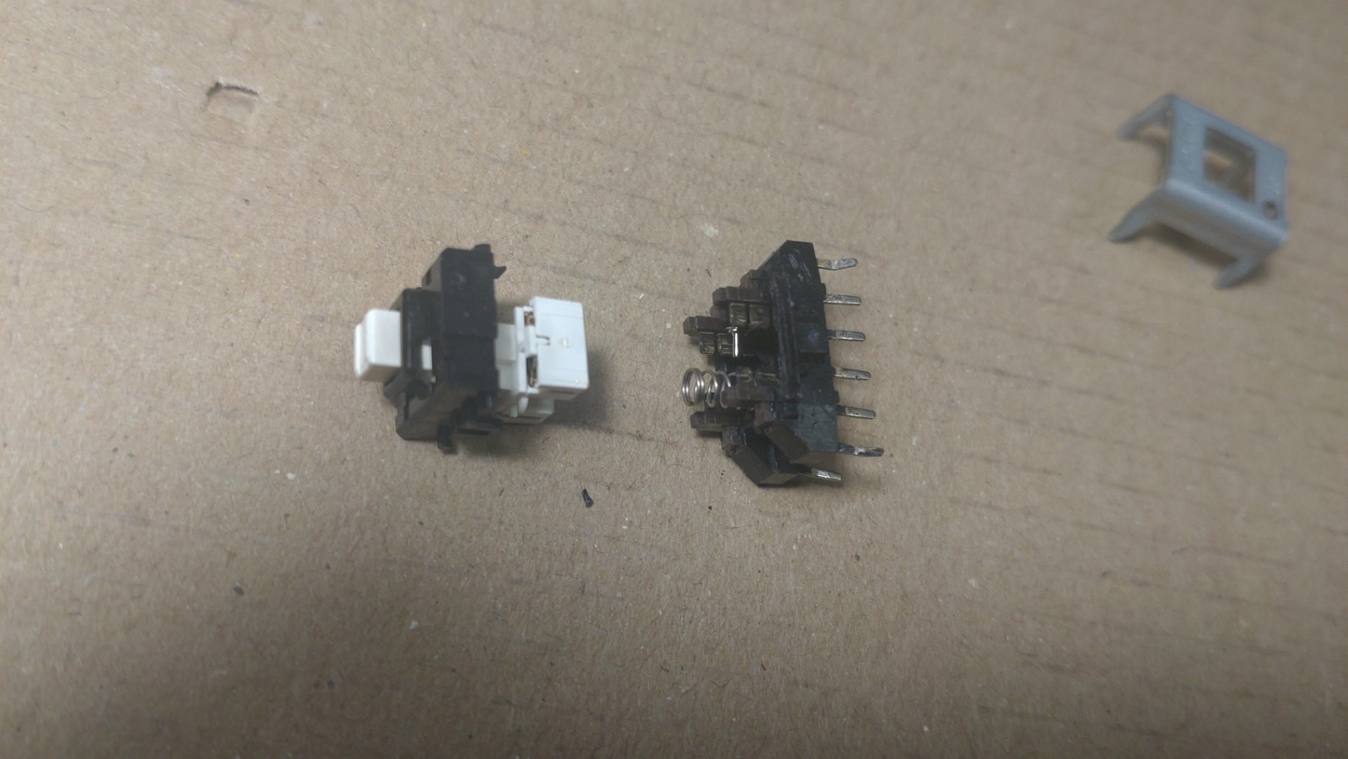

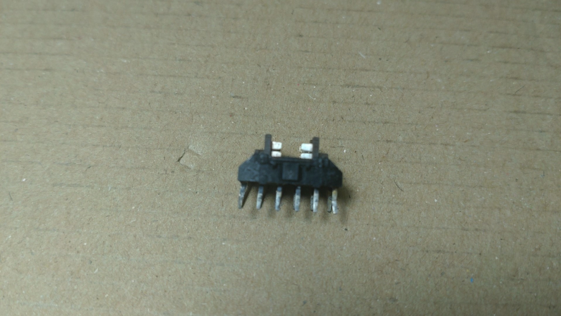

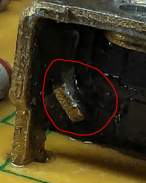

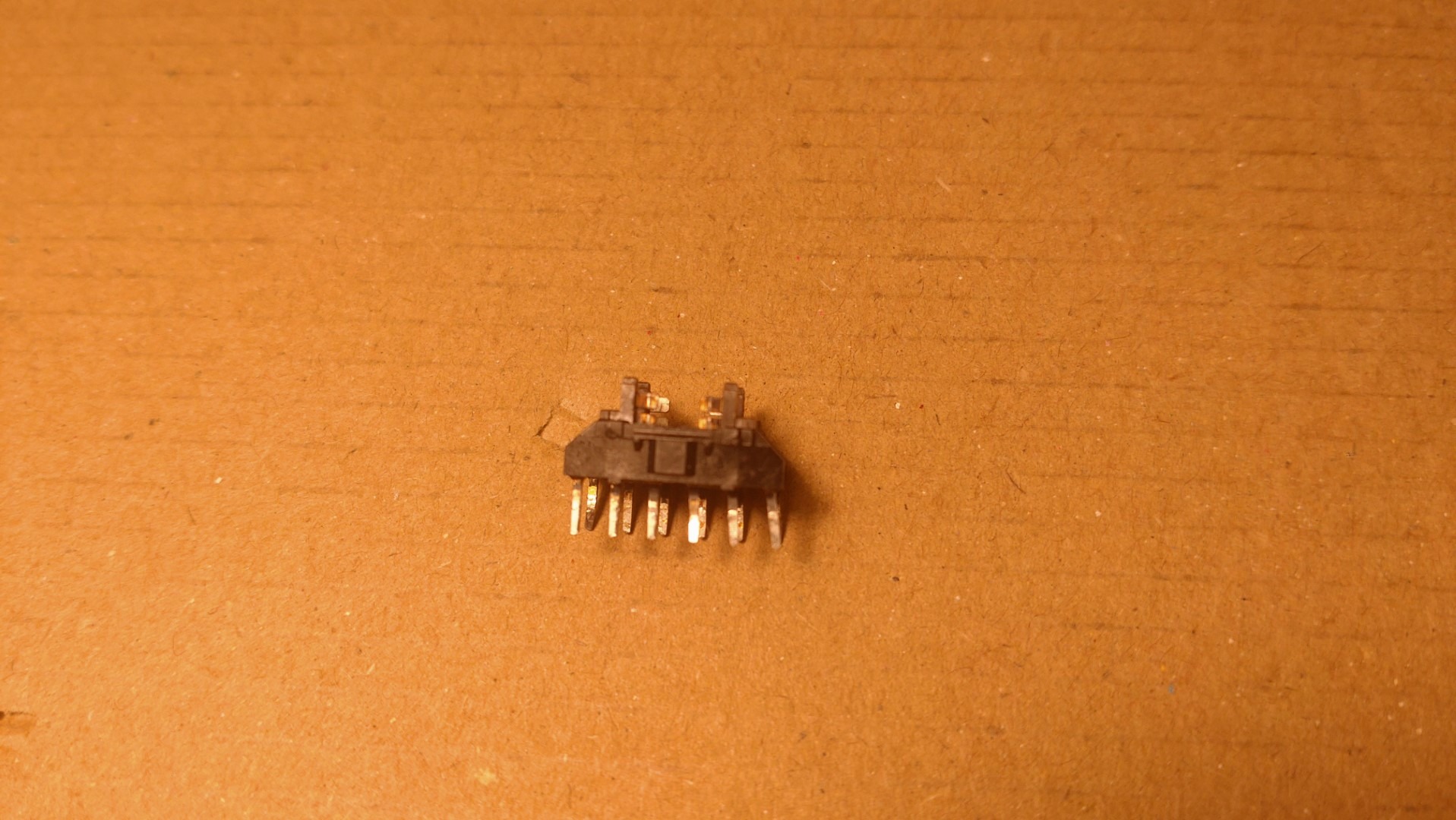

Under no circumstances whatsoever do not take the switch apart and clean it properly 😉I did another round of deoxit for the switch in question.
Not sure these are at all serviceable like the ones above. All three would have to come out for a total of 30 pins to unsolder. That metal bar is clamped onto all three. After a couple more dosed of DeOxit and working that switch it seems to be behaving now,
You are correct, I have tried to work on one of this type of tact switch but failed to reassemble it - components are too small inside and I do not have a microscope.Not sure these are at all serviceable like the ones above.
Unsoldering 30 pins is "trivial" - once you get the rhythm and hand movements correct - input selector switch sets have usually more 😉
Yes, and after three bouts of cleaning, it's still not quite right. With no input, volume all the way down, in Line Straight mode, I can hear some static noise in the left channel. It's not present out of line straight mode.

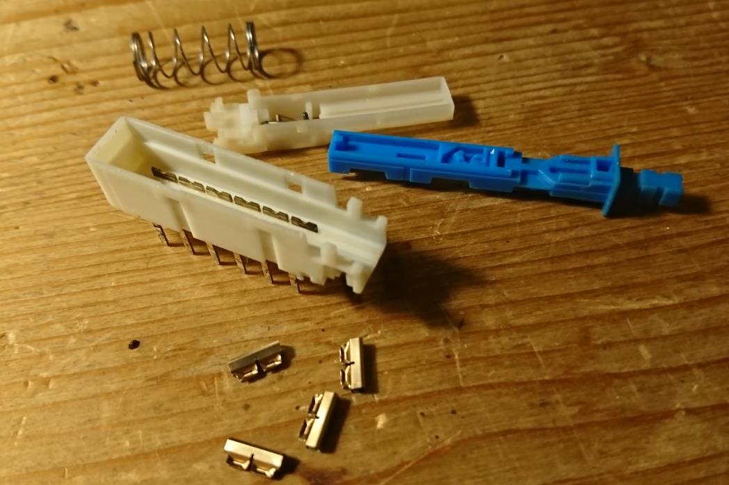

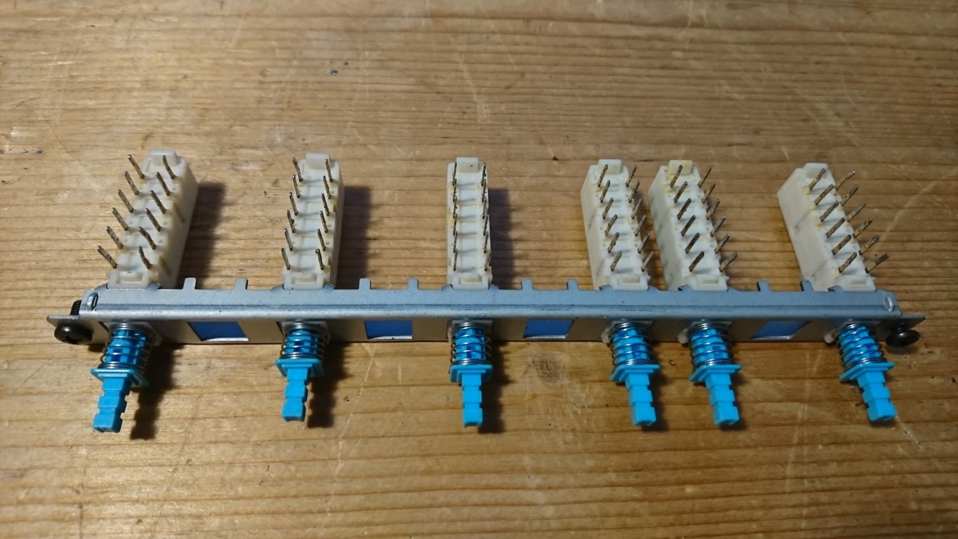

These types of switches I know at least in two dimensions (from ALPS) - the older ones I could not find, newer (and smaller) ones or similar copies can be found e.g. on eBay:I think it's going to be difficult to source one of those old switches.
https://www.ebay.de/itm/195955424750
https://www.ebay.de/itm/256276569466

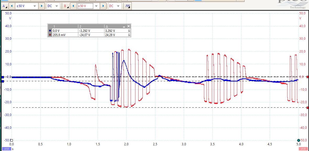

Well, I was looking around for something to use as a probe to trace signal with. I don't have an oscilloscope (and it's been way too many years since I actually used one) all I have is a multi-meter. But, I do have a pair of old powered computer speakers. So, ground to chassis and then to ground on rca jack and one end of a clip to a channel on the rca jack and the other as a probe. With the Amp turned off and a portable CD player attached to the Aux input, I can trace the signal through all of the switches. Did not have a lot of time to really get into it tonight, but it seems to be doing the trick. I'll let y'all know how it goes.
I must say, that worked really well! With the amp turned off, I could trace the left and right channel signals from input all they up to the first transistor it goes to. With this amp, it's a long trip to those transistors. The signal run from the input jacks, through the equalizer (for phono), through the function switch, through the tape1 and tape2 switches, through the sub-sonic switch, through the muting switch, through the balance, and then through the volume, and finally into the components of the DC Servo. It gets a little confusing for this novice but it basically goes from there to the line-straight switch for optional tone-control.
So, the issue ended up being the Tape 1 switch. Looks like I need to go another round of cleaning and exercising the switches.
