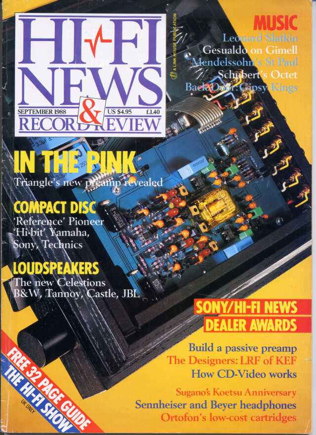

I recently searched through my attic (!) and found Paul Millers review about the PIP2 in HiFi-News, September 1988. - Sometimes it is good that we do not throw away everything "old and used".
It contains a relativly long and detailed description (which I have not been able to understand it fully) about this preamp and some photographs.
There is even a photo from the inside of the amp on the cover of the mag:
One can see quite many different transistors, some high power types, lots of LEDs, probably for current sources. This must be the linear gain stage, because the board is on top of the main board with the riaa stage(s) and the input switching. I can also see two big caps (3.3mf Roederstein MKP) and several tantal pearl elctrolytics (!), ELECTROL and SGS relays and two TL071CP (maybe for offset control).
But you mentioned a single gain stage like the the BOZ from Nelson Pass?
This really does not look like one to me.
It looks more like a all symmetric amp with current mirrors and sources and a ClassA output stage.

I may be able to help you with the Pink Triangle PIP2 The preamps were designed by my brother and the original designs were prototyped by both of us. I still have the original and have in fact just reinstalled it in my home system as an outboard phono only stage. I also have an early production PIP1. Although I am biased !! the designs were extremely good, their lack of commercial success reflecting that success in business is due to more than just having good product. Pink Triangle have struggled heroically for many years to establish themselves, but never quite made it into the mainstream.
The PIP2 took the design further by using a battery power supply to isolate the circuit from the deleterious effects of the line voltage. Although this added complexity to the overall design, the basic audio circuits still retained the original topology and elegant simplicity.
The design was certainly more than just a single transistor , and comprised of a transconductance amplifying stage feeding a passive RIAA deemphasis circuit, followed by a buffer. This configuration provided very high RIAA accuracy, high overload margin at all frequencies, and very low noise.
The multiple LED's were indeed used for biasing of current sources. They were very useful diagnostic tools when I was prototyping !!

I would like to inform you that I posted the mentioned HI-FI News article about the PIP II from September 1988 on my tiny website (link below).
