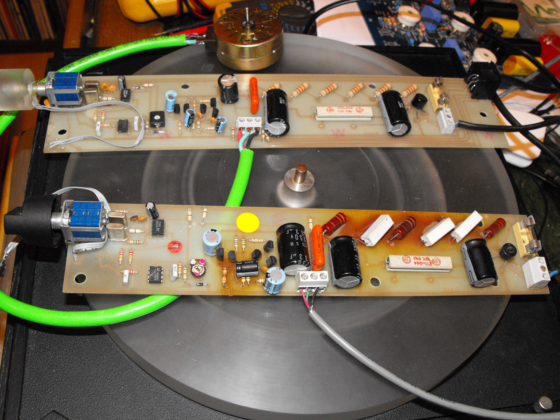

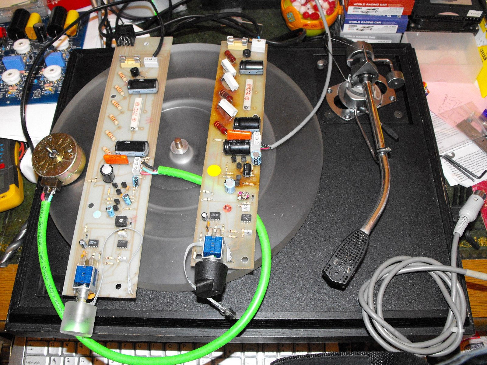

Ok
I have copied them upto my websoace and then copied them from there, I have no idea why i can't just upload them but either way they are up.
The PSU I am using is the used looking one with the heat marks and replaced resistors nearest the tonearm, this one is the same as I have in my LPT.
The other is the one that I think is an export PSU, this looked unused and I suspect was either a reject or failed early on in it's life.

Allen, they are both the same circuit, just a few layout changes/updates between them. It's a relatively simple PSU with variable speed control based on the frequency of one of the small canned crystals next to the speed dial. As long as the IC's are still available it should be easy enough to fix assuming the motor isn't goosed.
If it looks like one phase is bad then replace the larger dipped orange cap, it'll be a 0.22uf polyprop or similar.
Can you fire it up and read the AC voltages coming off the small white connector block as follows?
Red-blk
Green-blk
Red-green.
Red-blk
Green-blk
Red-green.

Ok I have had another look at the two boards
The electrolytic on the other side of the motor in the LPT is a 33uf but the one in the export was a 100uf.
All I had to hand was a 22uf of a high enough voltage so I put that in.
It now runs the motor but the speed is still slightly out, close but not quite there.
I have ordered some 33uf Caps but am guessing that it's the difference between the two caps either side of the motor that gives the shift, so if I drop the 0.68uf poly to something like a 0.47uf would that give a similar result?
Also am I right in thinking that when the motor is wired to the switch board on the top plate of the turntable and the flying lead with the din plug from the switch board is plugged into the export PSU board after the jumpers that are in the din socket now are taken out that the switch should stop and start the turntable?

The AC voltages with the motor running should be rock solid, maybe a few mV of drift but nothing more than that. Unplug the motor from the connector block and take the voltages again please.
What's the motor manufacturer and part number, i'll look up the specs for you and calculate a nominal value.
Looking through the change logs for these decks it looks like there was a number of different motors used, some with series coils which require 0.68uf and some which run on the standard 0.22uf.
Might be worth trying 0.22uf in there.
