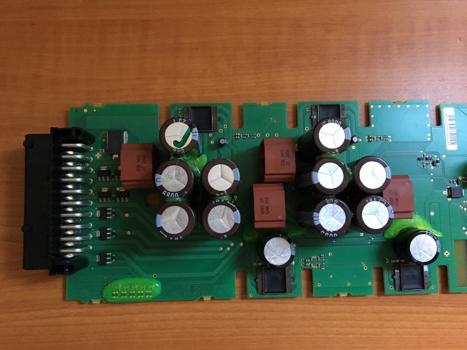

my BMW 7 series has a Logic7 DSP installed ex works. Now the amplifier ICs (similar to TDA1562 (2 pieces) for subwoofer and TDA8563 (also 2 pieces) for loudspeakers in the rear doors and central loudspeakers in the dashboard) in the DSP are broken.
The DSP consists of two boards, one with the bus connection (MOST ring) and the second with the whole amplifiers. I completely reverse engineered the second board.
So my idea now is to run the loudspeakers (connected to the two TDA8563) over a TDA7560 (4 channel) and to install an external amplifier for the subwoofers.
What do you think?
What do you think?

The DSP receives the signal via a MOST ring, i.e. optically. DSP is not just an amplifier, it is also an equalizer, an active crossover and so on. It is a Freescale 24-bit audio signal processor installed in it.
The system sounds very good! It's just the problem that very cheap amplifier ICs (ICs without cabinet) have been used and will break after a few years. Simply throwing everything out is not an option, because it doesn't work and isn't necessary.
The ICs are designed to do precisely what they're doing. There is no reason for them to fail unless they get physically damaged. If you want to take the load off of them, use line output converters and use them to drive after-market amplifiers. If each speaker is driven by its own dedicated amplifier, this may take a lot of channels of amplification.
In theory, maybe, possibly.
Becker (developer and manufactor) took amplifier ICs without housing and bonded them directly to PCB, this looks like this:
The brown/black squares on the top and bottom edges are the amlifiers...
Yes, brilliant idea, thank you! And now tell me what it's gonna do if the output is dead?
It doesn't matter if one of the exits is dead or not, that's not the point! These ICs are the weak point of EVERY Logic7 DSP in E65, they break with EVERY DSP, sooner or later... And that's what this is all about.
