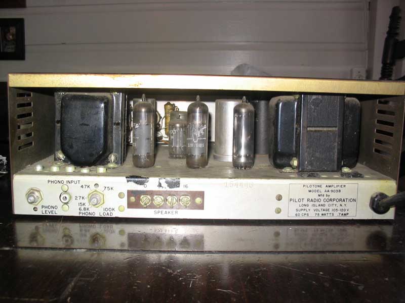

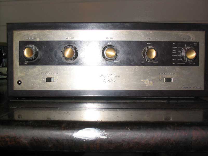

Well, I had a pretty successful scavenging day down at the local TV repair shop. The haul includes:
* 2 Lindal 12AU7s (never heard of these, but what the heck)
* 2 GE 12AT7s
* 2 Westinghouse 12AU7As
* 1 Pilot AA-903B tube amp w/ matching FM tuner
OK, so probably none of this is going to light the world on fire, but I got it all for a song.
I'd like to know if the Pilot amp is worth keeping and restoring or if its junk and should be disassembled for parts. Also, I didn't realize it until I got it home, but its a mono amp, so that means I need two of them for stereo, right (see how smart I am)?
Mrs. Annan saw me come home with these and exhaled conspicuously. I'll need to act fast so they don't wind up in an impromptu garage sale.
Kofi

I understand that Pilots are underappreciated -- meaning they are pretty good (for their day)... whether it is worth more restored or as a ginea (sp) pig i know not...
dave
dave
i own two pilot 903 amps (6v6 push pull integrated)
IIRC, the 903B is a EL84 push pull , .. not sure whether the circuits are similar (although the concievably could be), .. but don't junk that one. get it working and it should make you happy.
if it needs restoring, it will provide a good introduction to tube amp repair etc . since it is a mono amp and therefore, basically easier to understand. .. your public library may have a sam's schematics of this amp which you can photocopy.
later on, you can try tinkering aruond with triode mode, tweakign the bias etc ..

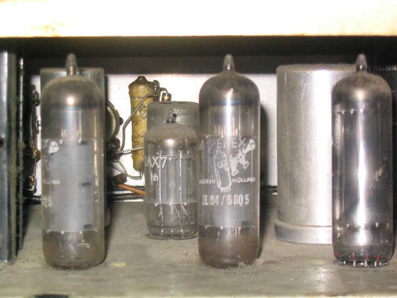

I know that the EL84 Amperex Bugle Boys are somewhat sought after and may be resonably rare (I think this is right). If that's the case, would it be worth having the tubes tested and trying to sell them on Ebay?

Kofi Annan said:I know that the EL84 Amperex Bugle Boys are somewhat sought after and may be resonably rare (I think this is right). If that's the case, would it be worth having the tubes tested and trying to sell them on Ebay?
Exactly what i thot when i 1st saw the pic... given my guess of how little you paid, they could well cover the entire cost of your purchase (and new SV83s (run within their limits) are probably better sounding.
Well, I paid $20 total for the amp and the matching tuner, so I don't think I could have done much better.

In good condition the Bugle Boys should fetch at least $40 and the TFKs $30 (sometimes you get surprised and they can go for much more)

Kofi annan i have that amp too, do you have the diagram because i want to restore it these days, please.
Pilot AA-903B
I have a couple of these amps also. I repaired mine by replacing the selenium rectifier, main rectifier tube, with good diodes, and also replaced filter caps. It is an amazingly clean amp and one of my favorites, with a very nice phono section and beautiful sounding output transformer. I'm also looking for a schematic of a Pilot 654 FMA (stereo FM receiver). I've restored it and wish to verify some values on the tuner section. This amp seems to have had a built in problem with hum in one channel,... which I came up with a solution for.🙂😎😀😱
