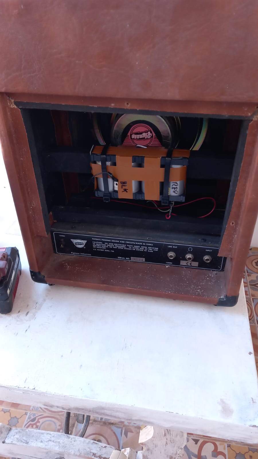

A friend of mine has pignose amp at his vacation home, but only uses it once a year, so every year the lead battery is dead. I decided to replace it by 4 lifepo4 cells 32650 5Ah each. I added an UVLO based on a seiko voltage detector chip at 1.3uA, with a big fet, and active balancer based on the ETA300 chip, good for 2uA standby.

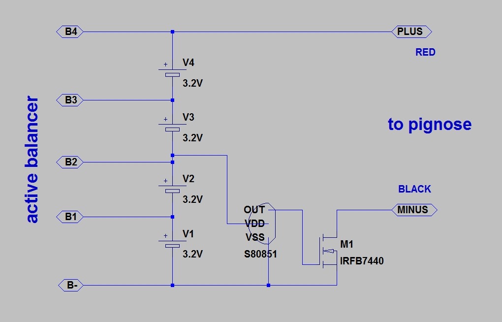

the schematic is depicted below. I have used the stackable battery retainers, in an 1x2 format , similar to this 2x3 plastics.
the voltage detector trips on a double cell voltage such there is sufficient drive for the fet. The undervoltage threshold is thus set to 2.55V per cell, giving many years of storage without charging. the cellbalancer maintains that all cells have the same voltage.

Was "lead acid" a typo? Lead acid batteries have fairly simple charge requirements. In fact you can simply trickle-charge them with a power supply with a very high internal resistance, and they will tolerate that sort of crude charging without damage for a very long time.There are circuits on the net with 339 or 358 circuits, with presets to cut in and cut out the charge for lead acid batteries. (My emphasis)
Lithium batteries, on the other hand, are extremely sensitive to charging. A lead-acid trickle charger connected to a lithium battery is a sure-fire recipe for disaster - you will almost certainly start a dangerous high-temperature fire, along with an eruption of noxious, toxic, and very stinky chemical fumes.
Zener diodes are nowhere near accurate enough for use in a lithium-safe charger. A lithium cell is typically charged to 4.20 volts. But if you charge it to 4.25 volts instead, metallic lithium begins to plate out of the electrolyte. A dangerous high-temperature fire will follow shortly.
Note that 4.25 V and 4.20 V are only 50 mV apart. Yet, the first voltage is safe, the second will cause a lithium fire! The difference is a tiny 1.2% - but that tiny difference is enough to burn down your house.
Let me restate that: An overvoltage of only 1.2% puts you at high risk of a lithium battery fire.
Zener diodes are nowhere near 1% accurate, nor do they have sufficient temperature stability (voltage can change by several percent with temperature changes). You need a much more sophisticated voltage reference, such as a band-gap voltage reference.
These days the usual approach is to use a microcontroller, with a built-in analogue to digital converter to measure cell voltage, and a precision bandgap voltage reference so that the cell can be fully charged, but very precisely, so it doesn't catch fire.

ALso worth mentioning is that I used a 5S LIfePO4 battery with a nominal 3.2V/ cell. These are much more resistant to overcharging, and are generally considered much safer than lipo.
