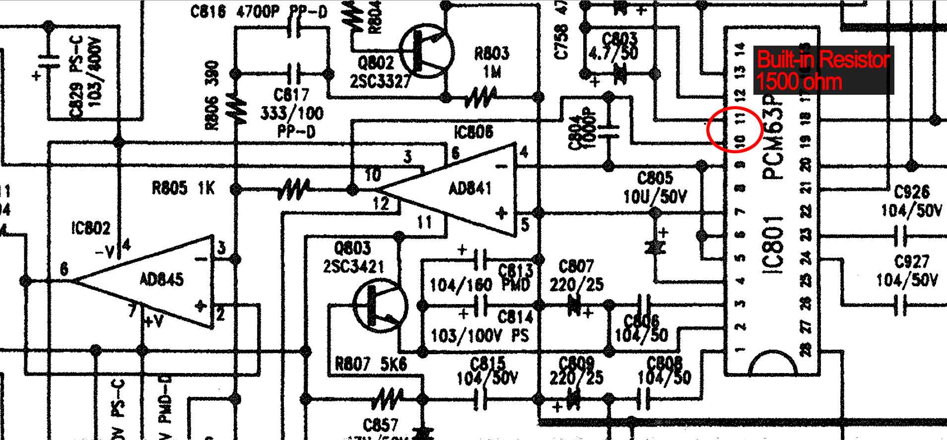

But now I need help from you guys in calculating the feedback resistor and capacitor in I/V stage.
A formula is given for calculating the I/V conversion for paralleled DACS in the PCM1702 Evaluation board´s Datasheet,
but i was always v e r y bad in mathematics. BTW, output current and impedance of the PCM1702 and pcm1704 are the same.
So here is the math:
DAC current output of the original PCM 63 is +-2mA
Output impedance is 670 ohm
The PCM63 has already a built in 1.5kohms feedback resistor for I/V conversion. Parasound chose this resistor for the circuitry and added a 1000pF capacitor.
The following opamp is AD841.
Now I have TWO PCM1704 replacing ONE PCM63.
The PCM1704 has an output current of +-1.2mA, output impedance 1kOhm.
What resistor value and capacitor value do I need to get the same voltage output of AD841 for those two 2 PCM1704 replacing one PCM63?
Would also be intersting for listening purposes to match them to get the same output voltage. As I wrote,

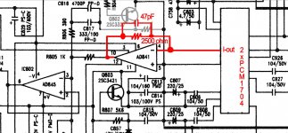

For two, the impedance will be 500 ohm (+/-2.4mA).
The application from the catalog shows a 2.5kohm conversion resistor in the I/V stage - to make 2.4mA x 2.5k ohm = 6Vpp = 4.24Vrms. The filter stage I think leaves 2.12Vrms at the output.
For your two parallel DAC's you will have to divide the 2.5kohm by 2 = 1250 ohm.
Mind that the OpAmp output current will double too (+/-5mA).

So, finished my mod yesterday. Kudos to BB-Ti, my esd-protective workplace consisted in tieing myself, soldering iron and the IC´s to the central heating of my home. I had to use simple adaptor boards, solder every cap directly on the pins. I had a simple copper sheet glued beneath the adaptor boards as ground plane. The IC´s were heated VERY often during soldering but they survived.
First I thought I grilled half of them, because signal level was too low after I/V conversion, but I found the value of the cap bypassing the I/V resistor was too high. So now I have two PCM1704 per channel, each with its own caps, current outputs connected together, using a 2500ohm resistor with a 47pF cap to get - almost - the same signal level as the PCM63.
The PCM63 provides 4mA current, sent via a 1500 ohm built in resistor and 1000pF bypassing cap. (Around 6V unbalanced line level! Newer amps using IC for volume control will clip)
The two PCM1704 provide 2.4mA.
There is still a slight mismatch in volume between the original PCM63 board and the modified PCM1704 board, so it is not easy to judge the benefit of the mod. The PCM-1704 board is a bit louder.
Maybe someone can help me in calculating the bypassing cap for I/V conversion to match volumes between the two boards?
Again, the values:
PCM63 - 4mA, 1500ohm, 1000pF
2x PCM1704 2,4 mA, 2500ohm, 47pF
Opamp for I/V conversion in both boards is AD841.
In the moment, the PCM1704 - modified board is a bit louder.
Using a 1000pF cap on the 2500ohm resistor (in fact 4x10Kohm) lowers the
voliume to 1/4. So I sticked with the 47pF cap in the PCM 1704 datasheet. But maybe this value has to be changed?

What are saying makes no sense. The capacitor over I/V resistor shouldn't affect the volume level, it is there to cut the ultrasounds - only eventually the high frequency response if it is to big.
Rather, when you changed that capacitor, you repaired a bad solder on the OpAmp.

No, I can repeat the effect. 1000pF over 2500ohm result
in lower volume. I did not measure at the resistor, just line out jacks.
The output of opamp (AD841)for I/V conversion is connected to the analog filter using a 1000ohm resistor. I will post part o the schematic tomorrow.

2500 ohms with 1000pF should give a corner frequency of 64kHz. If you hear "lower volume" something is not right... Maybe you have read wrong the capacitor value.

O.K, here are the circuits, original and modified.
I made a mistake in the left drawing: The original buit-in resistor 1500 ohm is between pins 9 and 10
As I wrote, keeping the original capacitor C804 1000pF in the modified circuit will lower the volume to 1/4th. I did now put in 47pF, but there must be a reason why Parasound put 1000pF. (in the PCM63 Datasheet´s circuit example, no paralleled cap is mentioned) So I would like to put in a capacitor with higher value than 47pF and appreciate advice on this. Maybe R805 has to be replaced as well?
