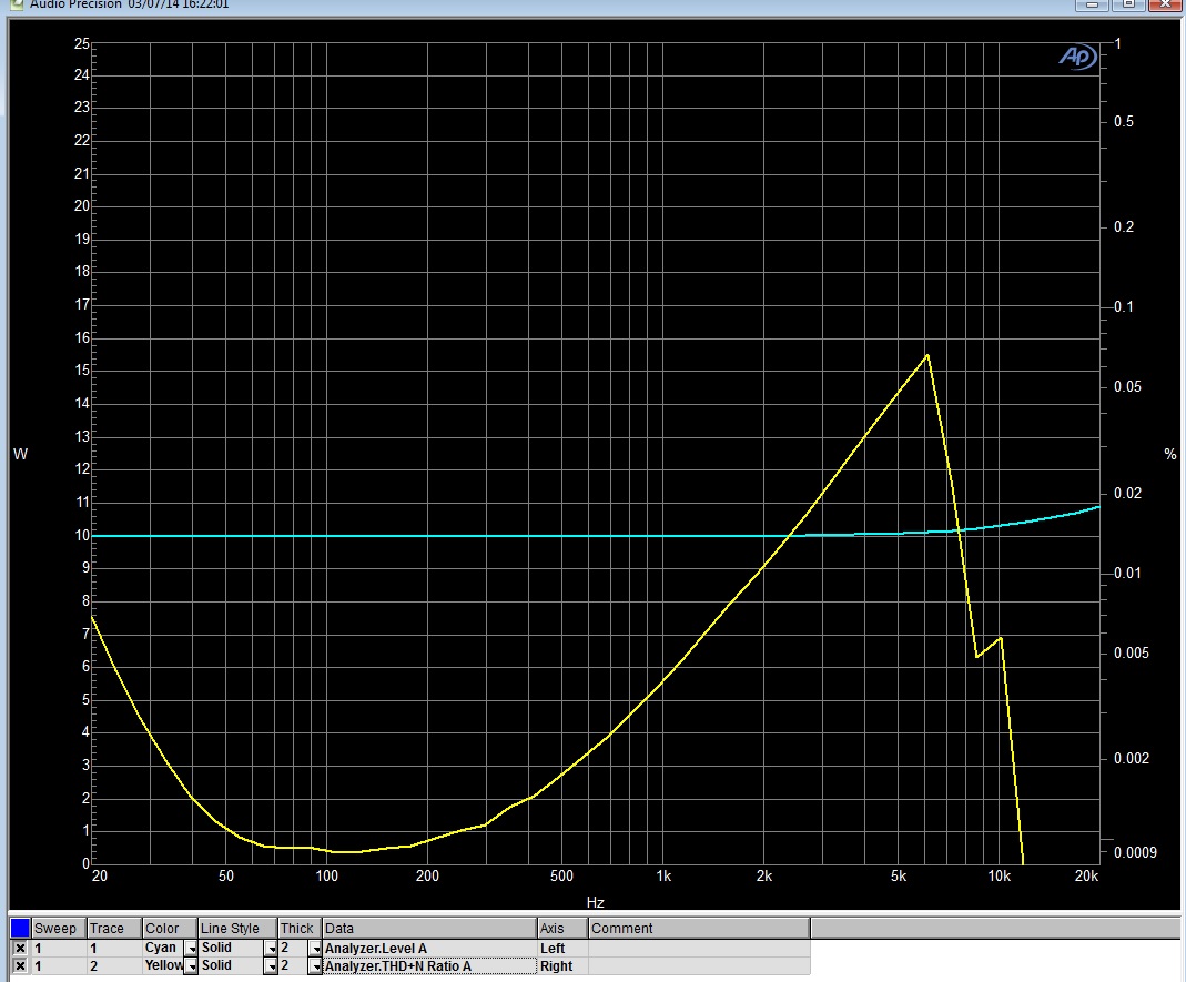

The Class-D amplifier I just designed has the piezo effect for sure every time I do a sweep and the frequency goes above 2k at full power you hear it. But will the piezo effect actually add distortion to the amplifier is my question? I ask this because also right around 2k the distortion starts to go up.
What function do the "singing caps" caps serve in your circuit?

The capacitors are being used to decouple the switching MOSFETS for the H-bridge. That is the highest current area. I have them in other places in the board but i doubt the ripple current in those locations would be large enough to cause this piezo effect.
In this image you can see the distortion of the class-d amplifier rises sharply and peaks at around 6khz. I am wondering how much of this is if any is caused by the piezo effect. Since I took that image I have been able to modify the modulator such that the peak is now at around .01% THD but I cannot seem to be able to get the peak any lower. This is why the quesion about piezo effect causing the distortion.
