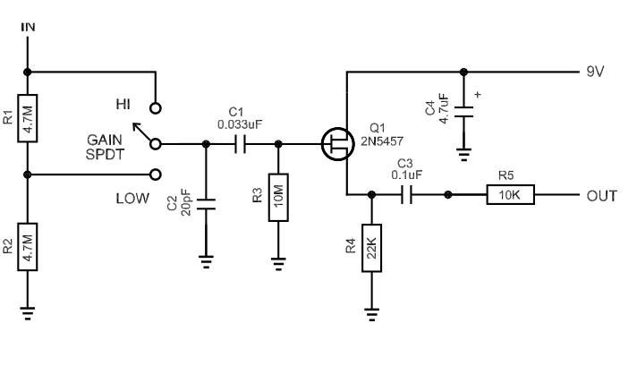

In order to buffer the piezo sensors I built a buffer circuit originally designed by Scott Helmke for bass but then adapted for guitar (see attachment 1):
http://www.diyguitarist.com/Guitars/PiezoBuffer.html
This makes the piezo sensors sound really quite good, but the level is much too low for my needs

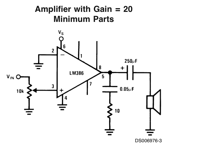

So I have simply added an LM386 opamp in "minimum parts" mode (see 2nd attachment) after the buffer. I have connected the two with the 10k resistor of the first buffer circuit being the 10 k pot at the beginning of the second opamp circuit. They share the same 9 volt source. Now I'm pretty pleased with the results except for the amount of noise in the signal. So in searching for a solution I came across this forum post:

I have attached the schematics of the two circuits I have combined thus far

hello.
for what reason did you choose the lm386? it is a small headphone amp.....;
with a 9v battery you can use low power consumtion opamps........;
if the input signal is low you can leave out the voltage divider (4,7meg) at the input......;
did you leave out the 10k pot at the input of the lm386?
and substitute it with a 10k res in series? ;
the cap's c1,c3 at the fet stage work as a "low pass filter" .
For years I have used a JFet as buffer in a die cast aluminium case feeding my stage box from acoustic guitar with no preamp for back-line feed to the FOH PA.
I use a FET, similar to your circuit with a differential output from a 5532 to send balanced line signal to my desk. I use either phantom power or the built in 9v battery.

I chose the LM386 simply because there was a lot of information online about it... and for the simplicity of it... I'm definitely open to using different opamps... it's just that... in researching them... there didn't seem to be many that could run on a 9volt battery... but maybe I'm wrong there.

mjf, I actually have already bypassed the voltage divider and used the buffer circuit in permanent "high gain" setting... but it's still not enough volume. The piezo film elements I am using are not nearly as hot as hard piezo discs or under-the-saddle pickups... so I really need a lot of gain.... the LM386 provides more than enough gain... but it's too noisy
and... I actually did the opposite, I kept the 10k pot instead of the 10k resistor at the end of the buffer circuit... should I actually be keeping both the resistor and the pot?
- also thanks for the info on the caps that control the low frequencies/LPF effect... would I change either one... or both at the same time if I wanted to raise/lower the cutoff frequency? I'm bread boarding the circuit so, I can try different values for each
You are, on all counts - the LM386 isn't even an opamp, it's a small power amp. Most opamps will run off 9V without problem.

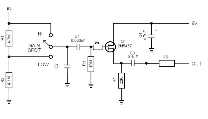

One thing bothers me about the Piezo Buffer design shown. The reason that a high impedance input to the buffer is required is that the Piezo is highly capacitive. Without the high impedance buffer input you loose bass. I think that the additional capacitor to 0V shown on the buffer schematic (at teh input) is only going to reduce the input signal by capacitor divider action without giving any worthwhile frequency shaping. This will just result in a noisier system.
Ian
I presumed the capacitor was to help prevent RFI?, not for any tone shaping properties.
However, I don't like the high/low attenuator at the front which halves the input impedance - if you need a high/low switch then stick another 10meg in series with the input, and put a switch across it (giving 10meg or 20meg input impedance).
Ah I should carify. After he posted the circuit, he suggested to use 1pF instead of 20pF... to "shunt" the RF.

As the impedance of the FET is above 4M7 then the signal from the buffered FET is around 700mV so not a lot of gain is required. Leave the gain requirements to your mixer!
