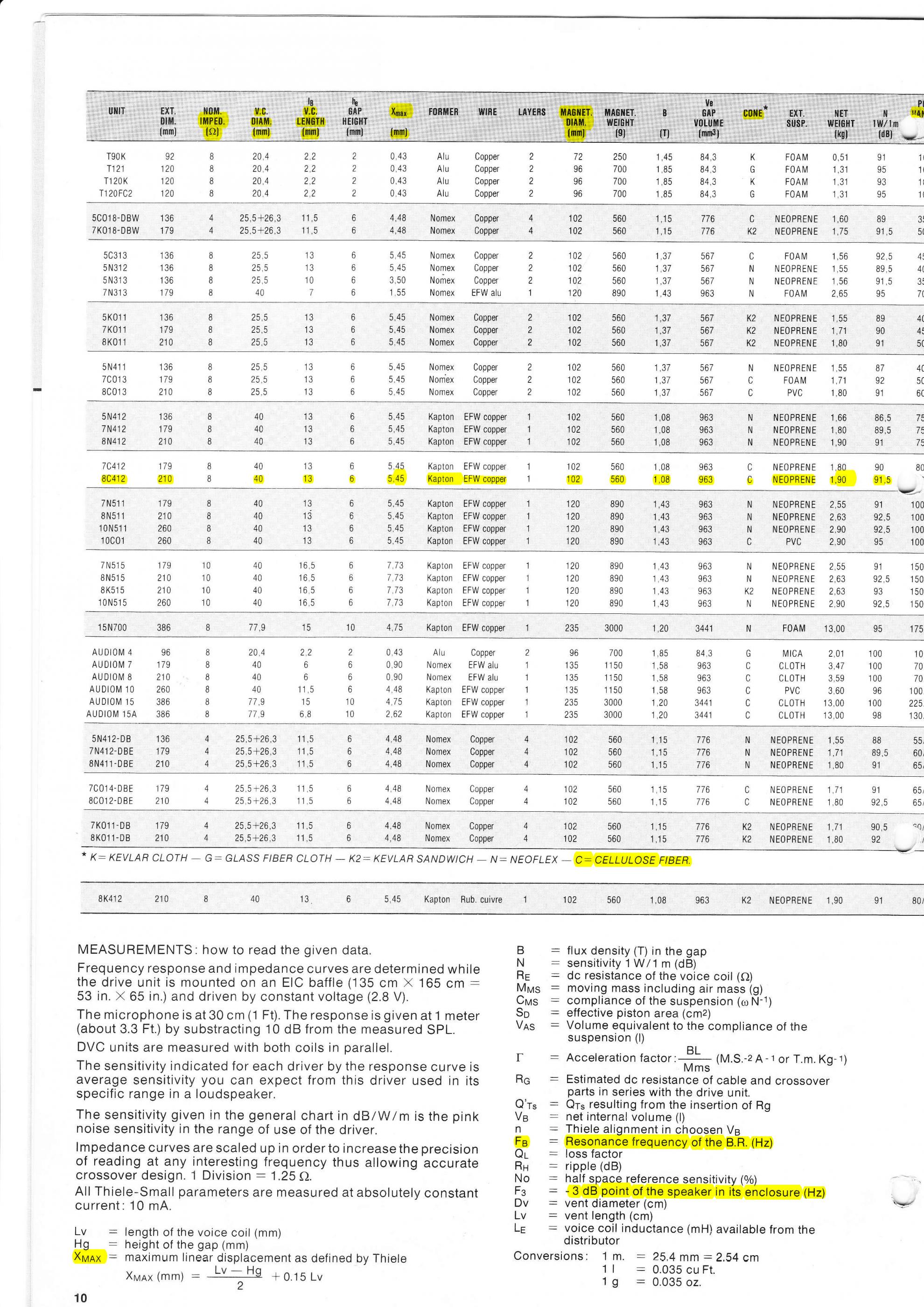

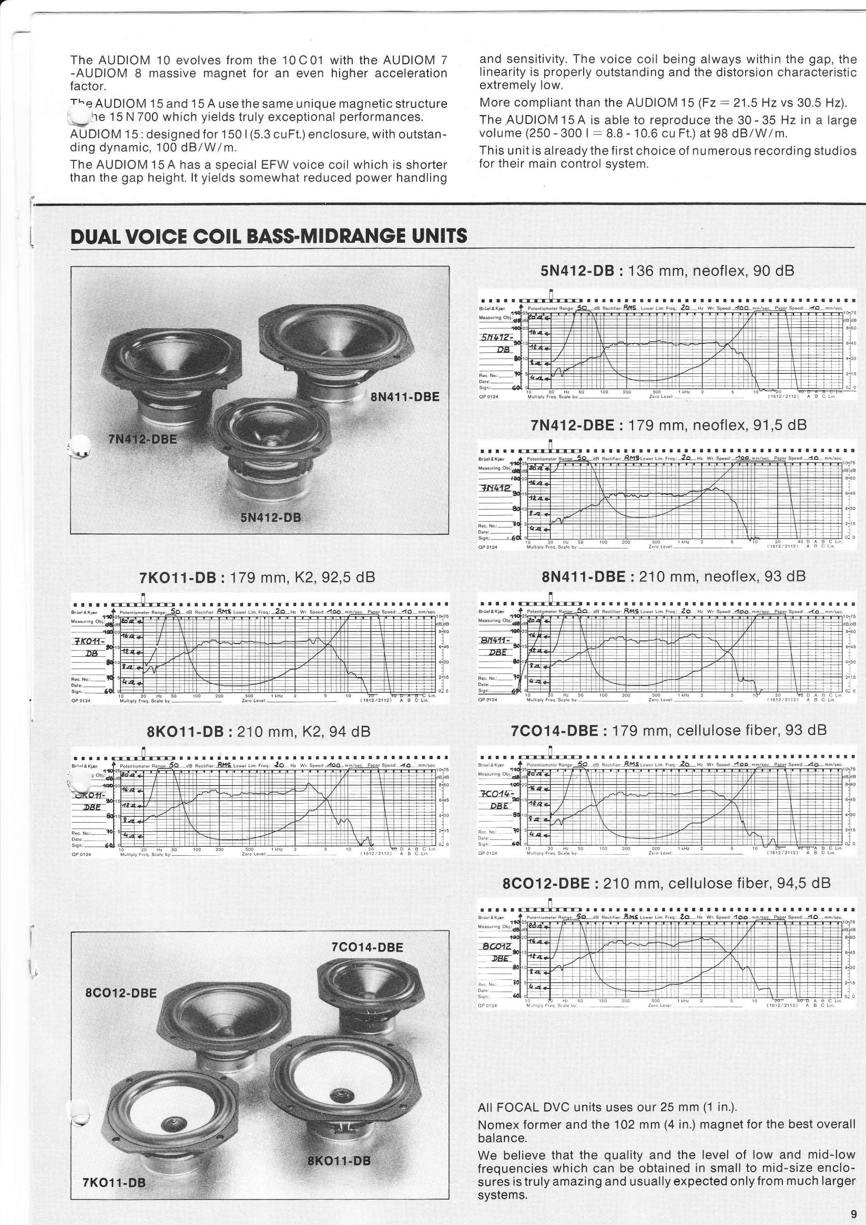

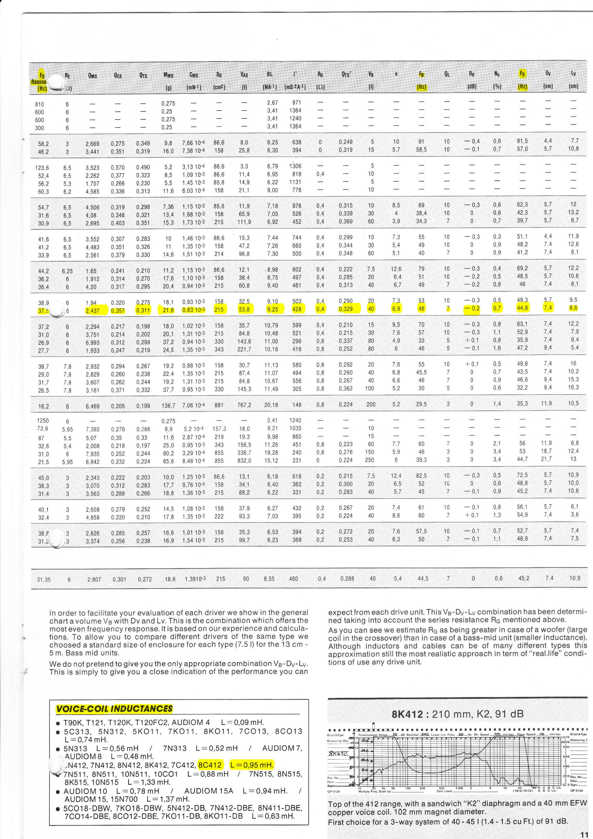

I purchased the set jstlout was looking at. I probably saved him a headache. At some point in time the previous owner replaced the mid driver and located the crossover external to the speakers. I had to refoam the woofers. Now one of the tweeters has died.
Thanks for posting the pictures! They'll come in handy if I need to tweak for a new tweeter.
