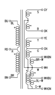

Looking through their selection, it is interesting that they have all of those faithful reproductions of juke box transformers. They are not exactly straightforward designs either, with multiple combinations of secondaries and separate winding for 70V line out. Is there such a big market for that?
AMI Rowe output traffo
I was interested because I have a chassis and the transformer is very flexible with all of those outputs, so different primary impedances can be created. But the bit I am really interested in trying is the centre tapped 70V output. Their must be a cunning plan there somewhere involving screens!

Now I look closely at the windings I think there may be a fatal flaw in my plan. The 70V secondary has its centre tap connected internally, so no way to apply any bias to the screens.
I have discussed cathode feedback on here before but the issue there is the amount of swing that is created on the cathode, so the drive requirements become too complex. But maybe a voltage divider could 'tune' the amount of feedback?
I think it is back to the drawing board. If only that CT was accessible.
