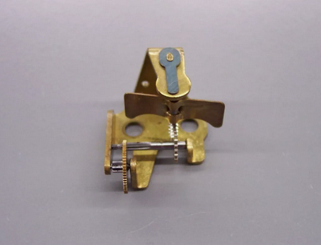

If anyone has opened a music box mechanism it has finned governor to stabilize the speed. If such finned shaft can drive a rubber pully (Small diameter to large for torque) it can work somewhat. Advantage would be less air pressure required resulting in less noise.
(Image taken from internet)
