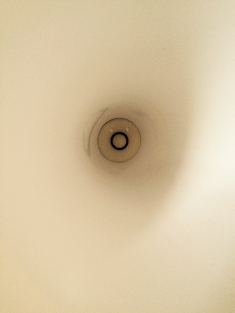

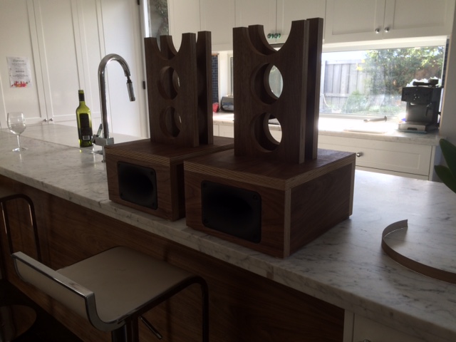

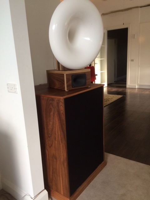

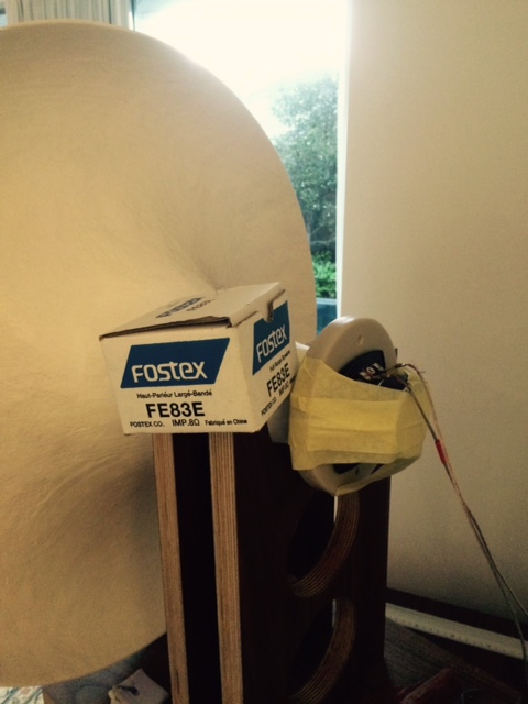

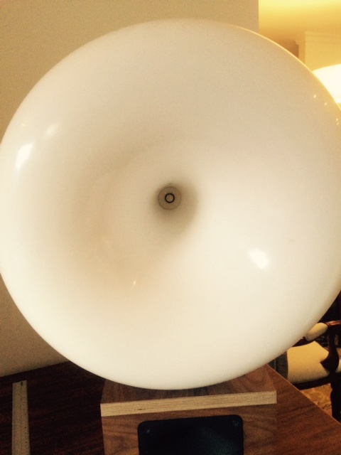

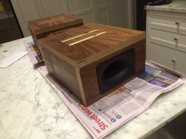

For fun, I swapped out my Faital Pro HF200 drivers and added in the baby 2 inch Fostex FE83 paper cones I had lying around.
The existing system consists of:
Tweeter: Faital Pro one inch CD with matching FP alloy horn
Mid horn: Azura 340 Hz horn with Faital Pro HF200 CD
Mid bass: 12 inch Kappalite in sealed birch box (hidden behind the large Walnut cabs)
Bass: Bill Fitzmaurice Table Tuba, with 8 inch Tang Band driver. (To be veneered.)
Amps: six channel Holton Precision audio power amp, plus separate pro amp for sub
Xover: MiniDSP 2x8
Source: Spotify, I-phone, Pure docting station, digital to xover.
Great sound, very 'big', and wide/high sound stage.
With the baby Fostex drivers, the sound is more laid back, more 'analogue.' I'm very impressed...and with tuning, I think these would/could make for a great start into horns. We're comparing $100 of drivers vs $600.
A fun project.

excellent !
Now, this is what I call a great idea !
Taking advantage of the entire flare rate !
I have often wondered why [very] large horns are constructed with only
2 inch throats (?)
2 inch throats (?)
Andrew, it is a 3" driver (80mm).
A good use for the driver. What about trying FF85wk?
dave
dave
Thanks Dave....I had the FF83 spare, so they got a look in initially.
I realised it was 3 inch after I posted...interetsinglly, the size of the actual cone is exactly 50mm (2 inches)...that's how I made the mistake.
With the FF85wk, what would you suggest are the main advantages...the power rating is ismilar...but seems to have more xmas. The high freq range is impressive...but isn't that academic as I'm only using the bandwidth of 700Hz to 3,500Hz? I guess if someone wanted to build a two way, then this drver owuld be a good contender.
Kind regards.
Andrew
The main advantage … at least in a box/baffle … is that it sounds better. They get really good when treated.
In a box they can reach about an octave lower than the FE83.
dave
