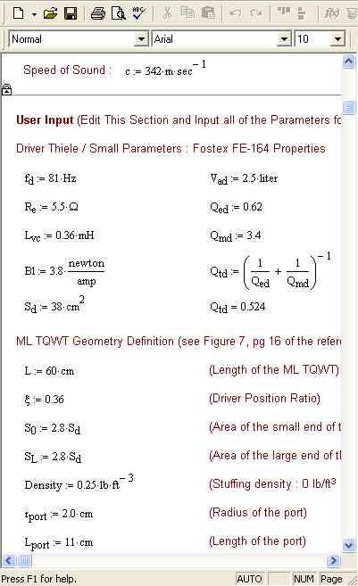

The problem is, that I cannot het a decent simulation of this tml. I used the mathcad worksheets to simulate the original design, wich can be found here:
http://www.audiocomponents.nl/speakers/vifa/xt/vifa-xt-line_eng.htm
TSP of the Vifa (according to HobbyHifi):

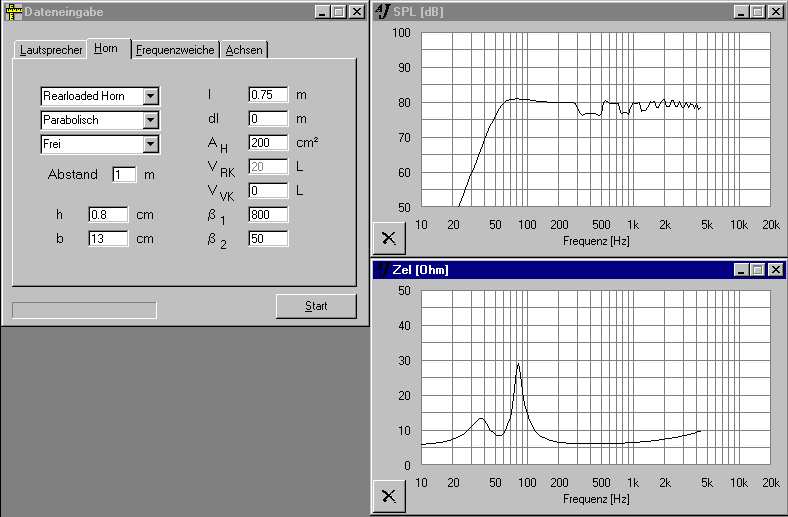

The problem is, I cannot reproduce the results that HobbyHifi has measured, no matter what I try 🙁 The steady drop starts @ about 150 Hz with mathcad, while HH has a steep drop at about 60 Hz:
They use AJHorn to simulate, and the results are very close to the actual measurements: http://deepspace9.xs4all.nl/~christiaan/10bgs-7.jpg
Sadly, I don't have AJHorn, so I'm hoping that someone can help me with some simulations, or maybe give me some other hints, so that the mathcad worksheets work...

Well, I tried again, and now, I do get something similar to AJHorn, so I'm on the right way 😀
with the MJK-sheets or another software?similar to AJHorn
would you mind posting your results?
Cheers
Cheers
Yep the sheets. I'm now about to make a 100 cm line like this:
Simulates like this:
-8 dB @ 40 Hz is not bad, and I even have room for my amp and FM receiver 🙂
