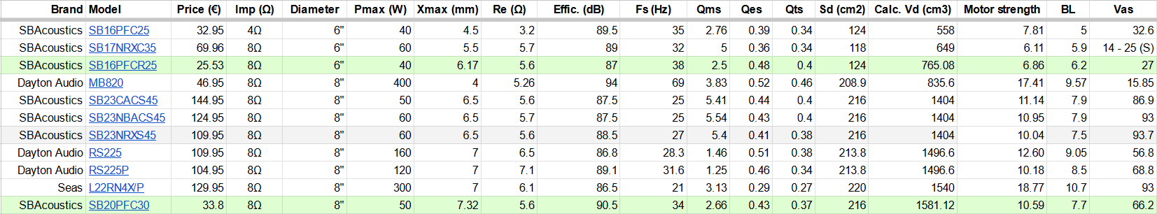

I made a quick Excel sheet to input different drivers' parameters, trying to stay below 150€, because I'll be buying 4 of these. I calculated an idealized version of electromechanical damping to get an idea of the motors' strength by doing (BL*BL)/Re. I know this doesn't account for losses, but it still gives a workable number. I also calculated an idealized version of Vd by doing Sd*Xmax.
Here are the results. The grey line is the driver bushmeister used. I used it as a reference since he stated the TS parameters were seemingly perfect, and also because I saw the measurements of his finished speaker, and that sweet, distorsion-less extension into sub-30Hz...
The clear winner based on my research is the SBAcoustics SB20PFC30. It is not only the cheapest of them all, but it also has:
The only thing keeping me from immediately pulling the trigger is this: am I missing something? What's the catch? The driver will have to deal with everything below 500/600Hz.
- High Xmax of 7.32mm (measured by third-party, not by manufacturer)
- Highest efficiency of the bunch at 90.5, giving me about 93.5db when wired in parallel. Would allow for 'easy-ish' matching with a very efficient horn loaded FR.
- Highest volume displacement of them all
- Good BL / Motor strength
- Reasonable Vas. I can live with giving each horn 60 to 100L to breath. I intend on running them sealed to get the cleanest bass transient possible.
It models really well. I even tried a tapped horn sub, and I get a very respectacle extension down to 27Hz at about 90/91dB before it rolls off. Usable all the way to 100Hz.
So I'm calling upon the Synergy boys to help me figure out if I'm making a sane decision. I've been itching to pull the trigger.
Alright, seems like Xmax is actually a little closer to 5.5/6mm than that enthusiastic calculation. Still, should be a good driver for a synergy?

I think you might have found the cheapest woofer that could work and its a reasonable choice. Faital makes a series of 8" woofers with more extension. Th e 8PR200, e.g. is rated for 8mm Xmax. and has a triple roll suspension that needs less clearance when placed against a horn wall to avoid hitting the wall at full extension. But the Faitals cost much more$
