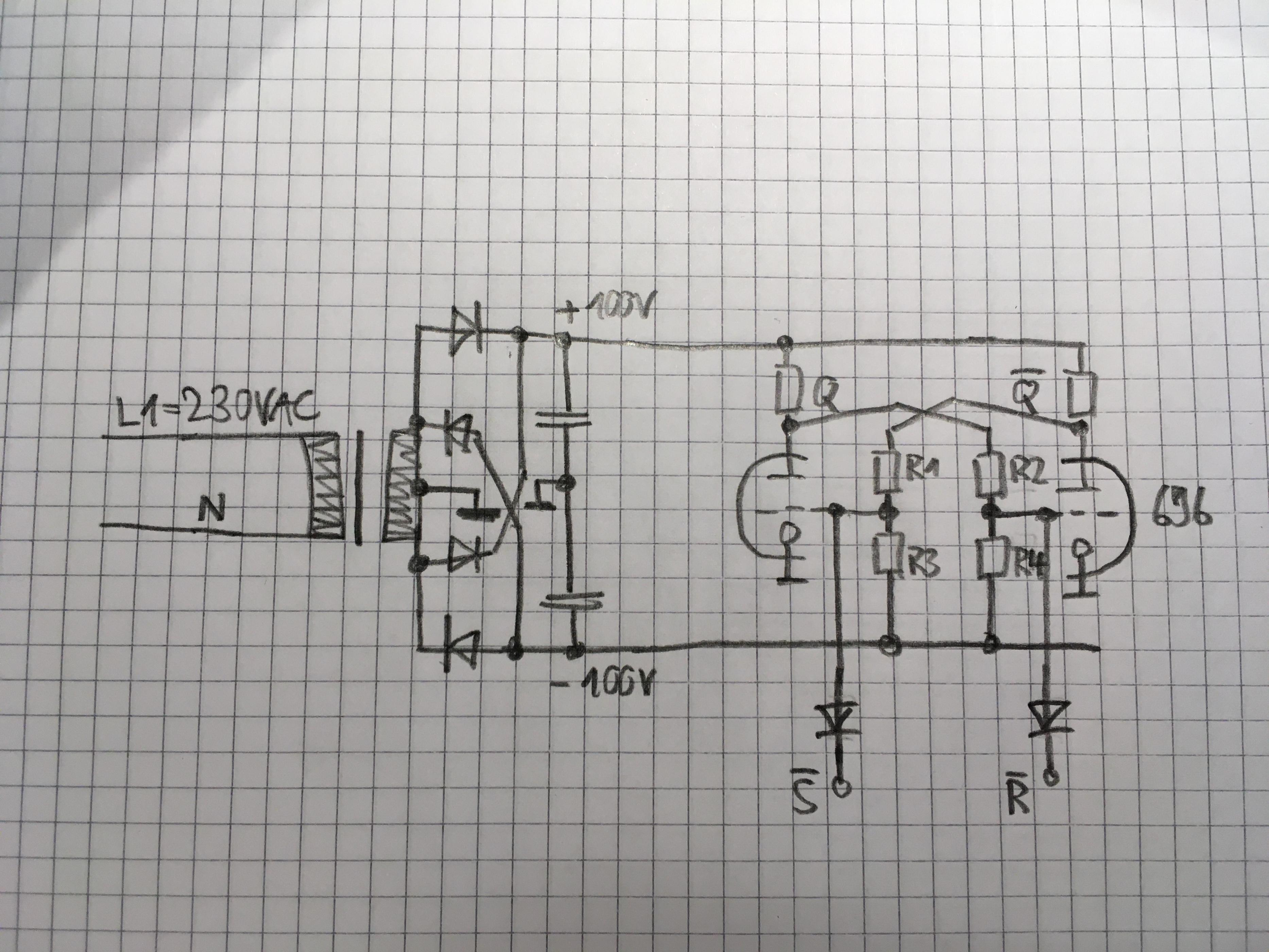

Just to explain why I asked:
I'm playing with some hot logic circuits, so something complete different than amps. A negative supply is needed for that stuff. To keep the supply simple, I prefer a symmetric one, e.g. +/- 100V or so. See attached picture.
How ever, a symmetric supply seems to introduce some risks for the tubes involved in the logic circuits in case of unsymmetric rampup time (which may be the case because the negative supply has almost no load, just some MegaOhm-Resistors) or when R1 or R2 would fail (open circuit).
But as I have learned in this thread, this would not damage the tubes because the grid current would be strongly limited by the resistors.
So all is fine 😉
all the best, Adrian
