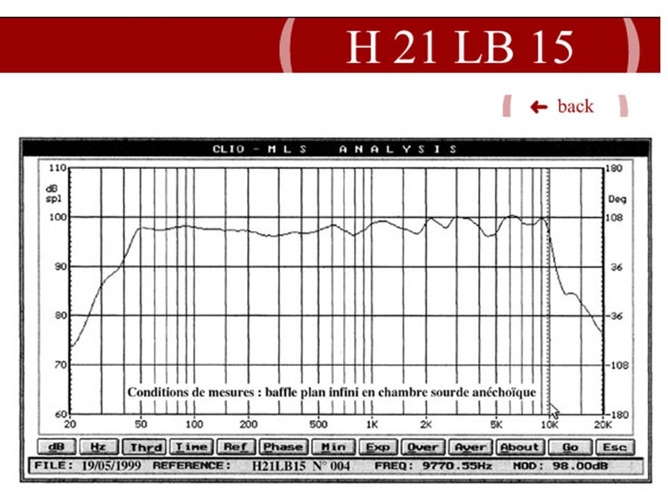

Am looking to build an Open Baffle project. Want to start with one "wide range" and progressively add a sub and super tweeter as required. Have ruled out Fostex and those with a Whizzer cone.
Short list is either a PHY-HP H21 LB or a Supravox 215-2000. I think the prices are similar, but still awaiting confirmation from PHY on their current price.
Anyone use both of them, or can add their experiences to this decision?

As both are Alnico magnet, choose by the price or QTS(very important for OB panel), PHY-HP QTS is higher (0,59) than SupraVox.
AT the PHY-HP Site, 8inches is 522euros and the 12inches H30LB15 12 inches ''just'' 300euros more at 815 each, the 12inches do not need subwoofer, just a tweeter (PHY-HP have a coaxial crossoverless woofer line with a tweeter in center-good value-)
The SupraVox I do not know but it have a QTS very low for a OB, surely need a woofer and xover.
Just a idea.
P.S.: PHY-HP drivers have life warranty. Good Luck

I have only listened to the PHY-HP H21 LB in a 3 way Dipole and the music was wonderful. Female voices were rich in detail and powerful in dynamics. At reasonable SPLs, solo piano dynamics were also impressivly real in timbre and decay. He used Audio Research tube amps. I brought over a pair of Krell KMA100s that added more life to the bass with equally smooth vocals.

In and of itself for an open baffle and for "fullrange" use, the 165 is NOT ideal.
What it does have going for it is good linear decay, low Mms for its Sd, and relatively high eff. for its Sd and a usable (fairly extended) pass-band.

The 165GMF is quite a bit "cleaner" than the others (with respect to linear distortion). It was also conceived and built well *after* the others. It also should cost less than half of what the others cost. Of the Supravox line - the 215RTF64 is also rather good, but because of the larger diameter it "beams" a bit more than the 165 series.
Again, the 165GMF (of these drivers) for this particular application. It's not Alnico, but..
Note however that much of the praise for Alnico from various drivers *usually* relates to freq.s in the mid-to-midbass region, say 500 Hz down to 60 Hz. So the 165GMF doesn't necessarily preclude the benefits of Alnico (or a field coil) for your application (..which could come from an Alnico driver).
As to the description.. between Alnico and Field Coil.. Again, it's really all about the particular driver, BUT:

The 5" in Supravox (135LB) doesn't look good to me. Substantial problems with linearity between 800 Hz and 2 kHz. 🙁
The 165 in the field coil (165 EXC) version specifically at 30 degrees off-axis isn't as "clean" as the 165 GMF, but has better overall freq. linearity and could well "sound" better than the the GMF version. It's also half the price of the 215 EXC, and a little less than double the 165 GMF.
