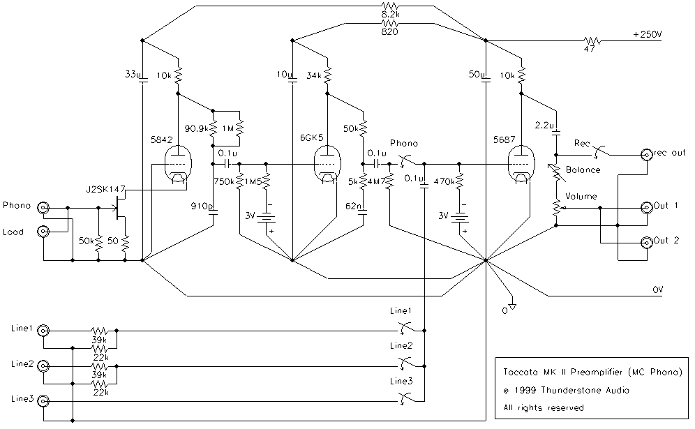

I'm trying to decide on a tube phono preamp to make, and I think I want to have one optimized for the DL-110 and DL-160, since I like them a lot.
A preamp using two 12AX7 stages with an all-in-one-go passive EQ between them, with a cathode follower or source follower on the output, seems like it should work well. LTspice is saying I'll get about 48dB of gain. The high input C of the 12AX7 should not be an issue with HOMC's.
I was also toying with the idea of using a 6SN7-LSK170 cascode for the first stage (100X gain), with a 6SN7 (15X gain) and a source follower afterwards. But that will yield about 43dB gain, which may not be enough for the DL-110.
Hence the question.

I think there are ways around that problem, such as splitting the EQ sections, with the 2122Hz pole between the first two stages, and the 50Hz - 500Hz shelf between the 2nd and 3rd stages. You'd have two stages supplying the gain at 50Hz. T. Loesch's Toccata preamp is an example of that approach, but I would remove the first stage cascode and use the 5842 as a plain old common cathode amplifier. Or maybe use a 2SK170 under a 12AU7A.
I'd delete the selector switch and other controls, and I'd change tube types to keep the gain down to about 50dB in total. I'd also use LEDs to bias the tubes instead of battery bias. Maybe 2SK170-12AU7 cascode > 6SN7 > 6SN7 with a MOSFET source follower on the output, or something along those lines.
Any ideas how I can use LTspice to predict headroom at 50Hz?
