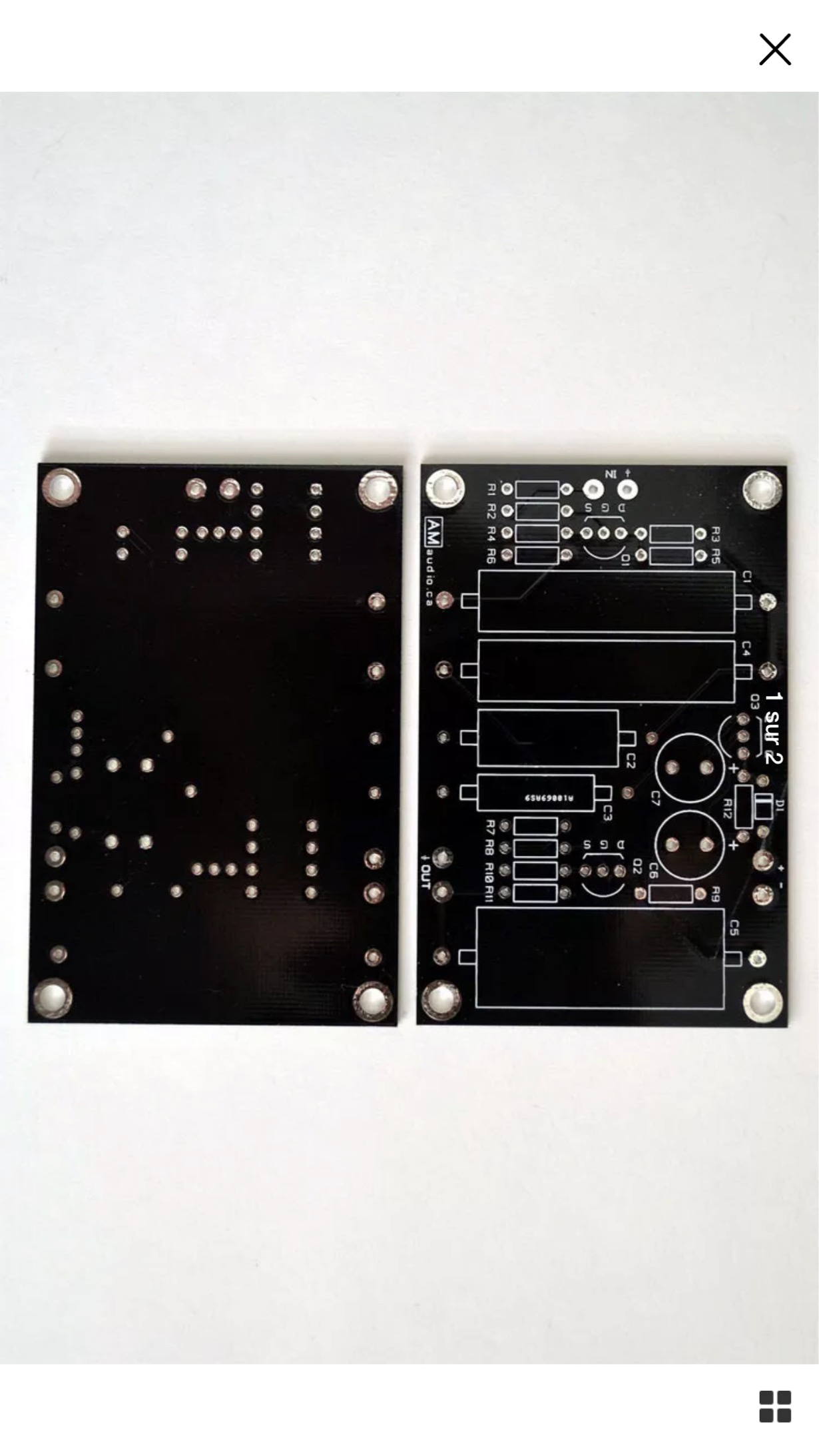

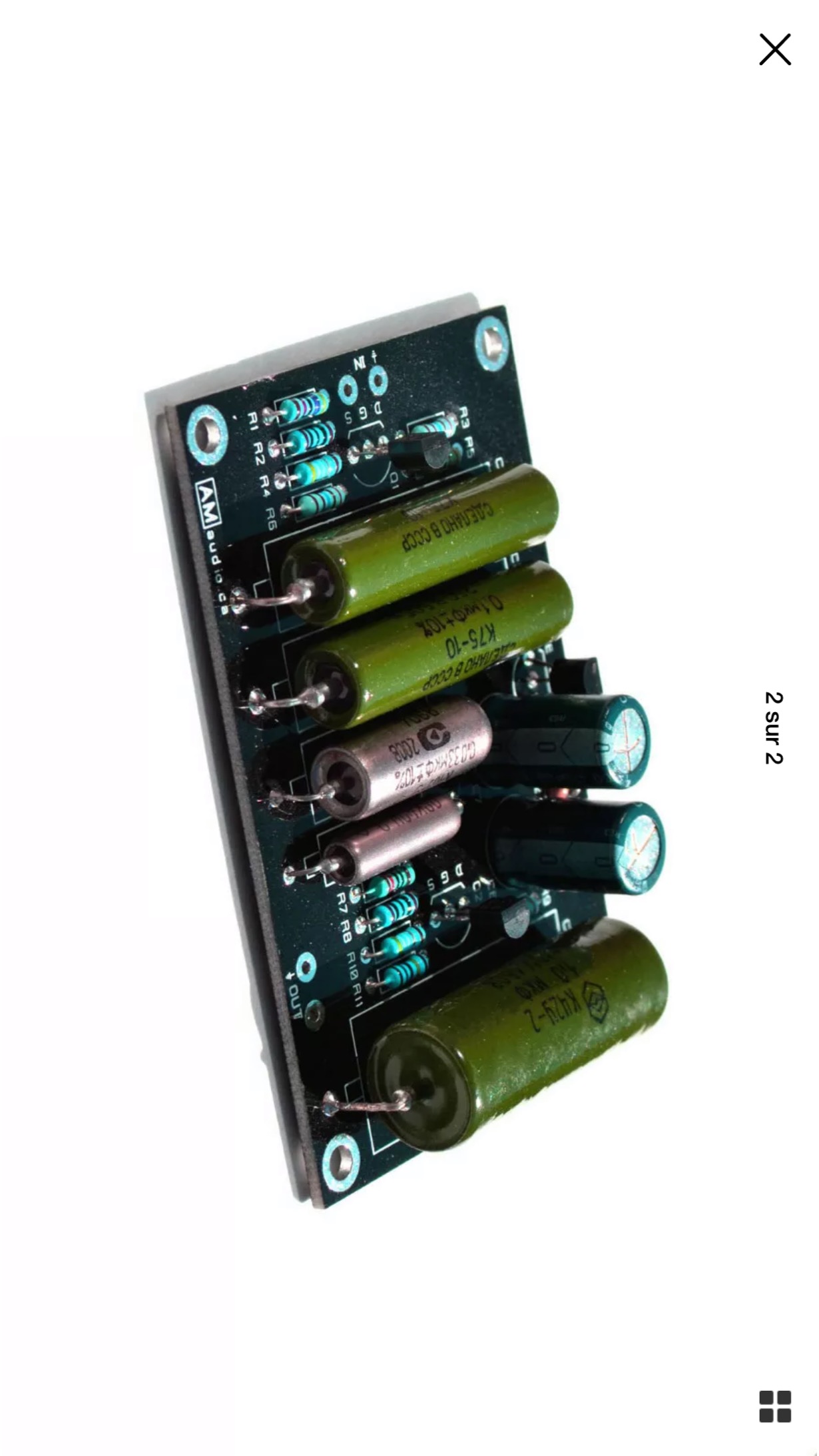

I’ve bought a pair of boards to build a dual mono phono stage based on the "Le Pacific" circuit. Here’s a link to the ebay ad :
PCB for RIAA JFET Phono Preamplifier Dual Mono - Two Boards only | eBay
The seller is from the toronto area and does it’s own designs, so it’s no chinese unknown circuit. (It looks a lot like the boozhound lab phono stage though...)
While i’m waiting for the boards to arrive, i’m starting to plan the power supply. I asked the seller for some recomendations regarding the power supply. Here’s his answer :
"Hi Gabriel,
General rule is: stay away from any 3pin regulators as LM78XX LM317, LM350 and so on, cause these are noisy.
Better results you will have with old, good uA723 / LM723, plus passing transistor.
By the way, my variant of the phono preamp has modified power section to improve filtering ripples and some noises from power supply.
I have a plans to design quiet power supply dedicated to phono preamp, unfortunately, right now I'm very busy with my day job.
Thanks and happy DIY-ing."
Btw, the boards need 18V to 24V.
Does anybody have experience with the LM723 regulator ? I looked at the specs and it’s clearly less noisy than a LM317, but a lot more complicated to me. I would like to know if it’s worth the trouble. My first idea was to use an external power supply in the style of a laptop charger, but couldn’t find one rated below 100mA, wich is the max current according to the seller. Could this kind of power supply be adequate considering the added filtration on the boards ? Could it be more appropriate to just use a 24V wall wart, and filter/regulate the supply inside the chassis on a third board ? I really want to stay away from batteries for this project.
Thanks in advance for your answers and your time !

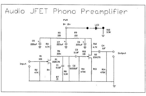

The schematic is not the best that will warrant a special super quiet power supply.
This is the original schematic. The circuit of the board i’ve bought is supposed to have some added filter to it. But i’m really not sure it’s enough to simply plug a laptop style power supply directly into the boards.
From what I understand of your comments, I should go for the less noisy options. Is there any other way to build a silent power supply without using ICs ? I’ve seen some examples on ebay using only discrete components, but this is above my actual understanding of the subject.
