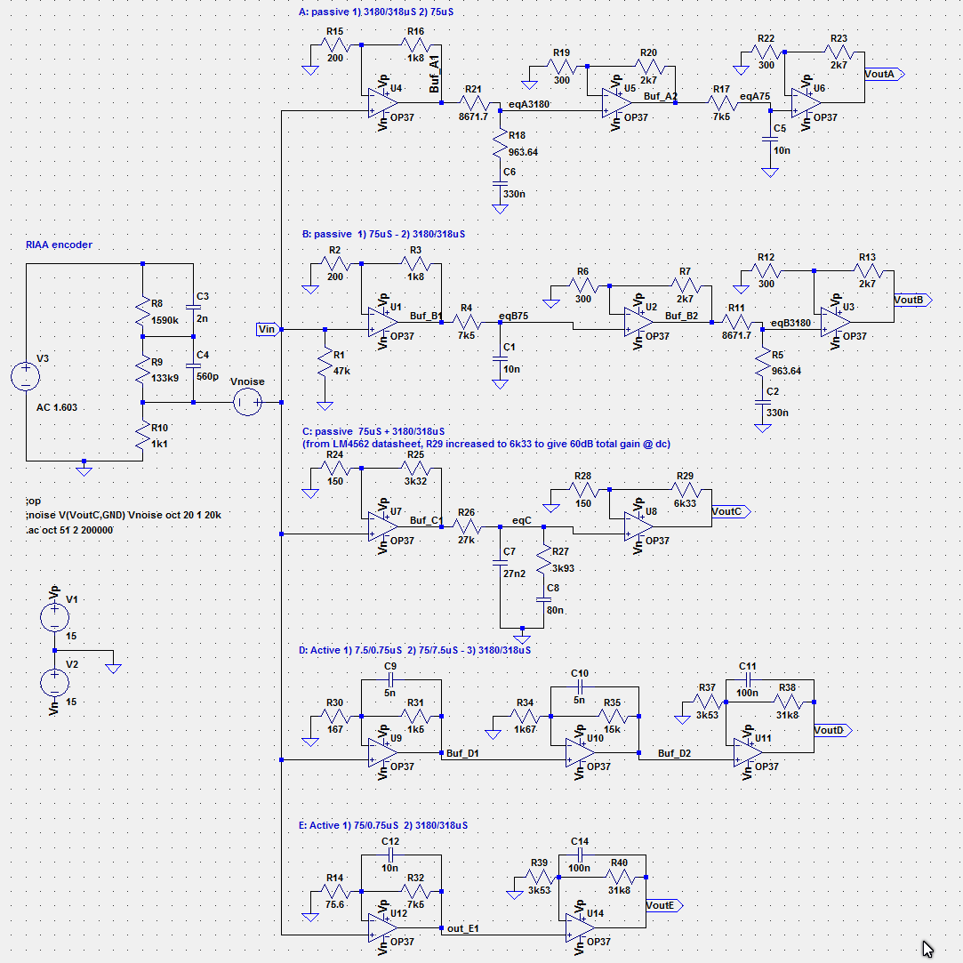

Passive or active?
1, 2 or 3 gain blocks?
In what order?
Noise vs head-room?
Lately I have been pondering about these and other questions, and to answer at least some them I have made a LTSpice analysis (see attached schematic and ltspice file)
A few comments (in no particular order):
1) I have decided to use a total gain of 60dB (1000x) @ DC. A little higher than is the norm, but it brings the output closer to the output from say a CD-player.
2) I have used OP37 throughout, not out of preference, but simply because it comes with LTSpice. (don't use in active topologies, as it may become unstable)
3) Looking at circuit A) and B), then the B) version must be preferred, as more of the signal is amplified earlier= less noise 4) Circuit C) (which is found in the LM4562 datasheet) is really the worst of the lot, from app. 4.5kHz the input to the second amplifier is *lower* than the signal from the cartridge(!) i.e. there is a noise penalty!
5) My reasoning for using three buffers/gain blocks comes from the fact that if looking at OP amps specs, you will notice that the more gain is required, the more distortion you'll get. Keeping gain low (20dB) you can use modest (audio) OP amps e.g. LM833. I've even tried xx4558 and it actually sounded OK. I allways use xx4558 for testing as if they get zapped the loss is minimal.

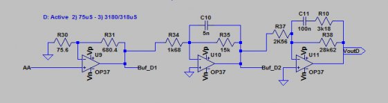

6) About circuit D): I like this because of it's simplicity and minimal parts-count (for a three OP amp RIAA that is). The last amplifer takes care of the 3180 and 318muSec. The second takes care of the 75muSec, a sideeffect is that it also produces a 7.5muSec zero, hence the extra cap on the first, which then produces a pole at 7.5muSec (cancelling the former pole) and a zero at 0.75muSec (212kHz) which is of no consequence in my book.
7) I have trimmed the RIAA encoder, such that the final output is 1V - or 0dB in LTSpice.
8) About noise: as far as I can see, the only elements that matters are
A) The cartridge (by far)
B) the first resistor in in the various feedback networks (R15, R2, R24, R30
and R14)
9) The impedance level is high enough to allow just about any audio OPA -
from MC33078 to AD797!
I have not attached any curves, as there just is too many combinations.
Go play with them!

since you like D, i will mention it is likely you will get lower distortion if you change the 2nd and 3rd stages to inverting. opamps generally have lower common mode distortion in inverting mode and the net phase at the output will still be correct.

I listened once to a good DENON poa preamp in a fairly good setup, but
I didn't try many values for capacitive compensation of the cartridge, just the classical 100pf(silver mica).
I could not complain of the quality of the capacitors...i used the best possible all throughout riaa network and coupling.
i think that i can make some real improovements to this circuit but the sound was really good and i compared that sound to a lot of other active preamps.Unfortunately i didn't came across the best of active riaa and if i am really curious how the active phono preamp found in Kenwood L-02A sounds , which i think should be the best in active riaa world.I wanted to build it as a stand alone unit myself, but i didn't have the time and resources for a long time.
I would really like to try all the versions described by @LLPe but in balanced configuration with ne5534 as i had a handfull of original signetics.
Sorry - no can do. I'll miss the 318microS zero, i.e. shelving at 500Hzsince you like D, i will mention it is likely you will get lower distortion if you change the 2nd and 3rd stages to inverting. opamps generally have lower common mode distortion in inverting mode and the net phase at the output will still be correct.
