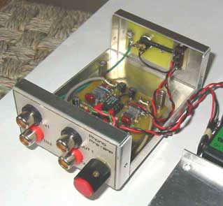

I have recently had need of a free-standing Mag PU preamp, and resurrected a design I have often used in the past. It is based on the NE5532 dual low noise IC, includes a 25Hz 12db/oct HP filter, and may be powered by a couple of PP3s. It performs extremely well, despite the design being rather long in the tooth, and does not cost an arm and a leg to produce.
I thought it might be of interest to some of yous, and I have zipped up a set of files (324Kb) including the schematic and PCB layout. I'll be happy to send it on receipt of an email request. I can also provide a (higher) res image of the PCB track layout, or Gerber files (if you don't know what those are, you don't need them!) on request.

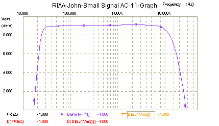

I simulated the circuit with a cartridge modeled as a 500 ohm resistor and 0.5H inductor in series.
The response error ( deviation from RIAA curve) is attached.

Second graph.
The vertical scale is not in db's away from RIAA. The deviation away from 1Khz is what I looked at.
I changed the rumble filter values from 100n/150n to 150n/150n and the RIAA feedback cap 3.3nF to 3.4nF and got the following result.
All this just for tweaks !!
About the rumble filter. It does introduce phase shift .I do not find much low frequency flutter or intolerable rumble in my playback system without a rumble filter. So if you have a similar situation maybe you should try to defeat the rumble filter and see if it sounds OK in your system.
I am sure that many people do not have systems that can reproduce audible sounds down to 20 Hz . Mine surely doesn't.
It would be interesting to know how this preamp sounds without the filter in your system.
The error graph with the modified parts is attached.

Hi Ashok
I hope we're not boring the rest of the community with this ping pong play.
I said earlier that I could not remember being concerned about the out-of-band response, and I now remember why. The design was put together in the days when simulators were the provence of large companies running IBM 360s (or even its predecessor) and with the oodles of money needed to develop the s/w. I would have put it together by trial and error, and when it looked halfway like it worked, I would have stopped!
The change from 3.3n to 3.4n leaves me totally unmoved .. !
However, the filter change to 150n/150n I would regard as a retrograde step, as it does away with an (unintended) advantage to my mind. On my last set of loudpeakers (17w75XL in16L - now mothballed as standbys) I used a resistor bypassed inductor in the xover LF section - 1mH/2R2 - to produce a gentle bit of lift at the LF extreme, bolstering the baffle step compensation introduced by the design of the main LF xover section. It operates pretty much over the range of LF lift introduced by the filter Q highlighted in your error graph. Neat, eh .. !
But, joking aside, it is well known that most LPs were cut with increasingly steep filtering below 30, or even 40Hz, so the error-induced lift from the 100n/150n combo might not be such a bad thing. I think that integrating an LF filter into the RIAA preamp was probably something I just wanted to try out, and since it worked well I was happy to leave it there. The actual turnover frequency is a really just a matter of personal choice. My Thorens TD160 does not produce much in the way of rumble, but some records do, either because of poor pressing onto poor quality vinyl, causing warping or rippling, or because of rumble induced by the original cutter platform.
I don't know why I have got caught up in this, since I am not a member of the Vinyl-is French-Baguette-but-CDs-are-worse-than-sliced-bread brigade. I have to say that the sound from many of my LPs sounds significantly compressed when compared to the best of my CDs (but I do also have to say that some of my CDs are grim!), so I'm staying put!
Over to you!

I must start off by saying that the box you used looks really nice. Did you buy it off the shelf ? How come it is so shiny ? Looks cool.

Boxes
Hi Ashok
Oh yeah, the box ......... forgot about the box ...... (do that a lot these days .... mumble ..... mumble). It's from Maplin, ref AB9, but you won't fit one o' dem 12v batteries in dere (an' I'll get more brickbats for dat, an' dis too!)
Regards
JohnT
Hi Ashok
Regards

ashok said:Hi John,
You are right about the unity gain limit causing the error at HF. I had overlooked that till I tried to tweak some parts and looked at the actual stage gain.
That information about the electrolytic caps is interesting and reassuring. I used to get Wirless World regularly till a few years ago. I must search out the past issues .
About tweaking the parts, I am sure the improvements will probably not make any audible difference as you so rightly pointed out. Additionally deviating from standard component values is of no help as it will mean using more than one component value at one point.
However I have been working with some RIAA circuits recently and hence the "urge" to tweak spilled over to this circuit !
The RIAA error on this circuit is pretty low and as I said earlier the improvements will probably make no audible improvement.
