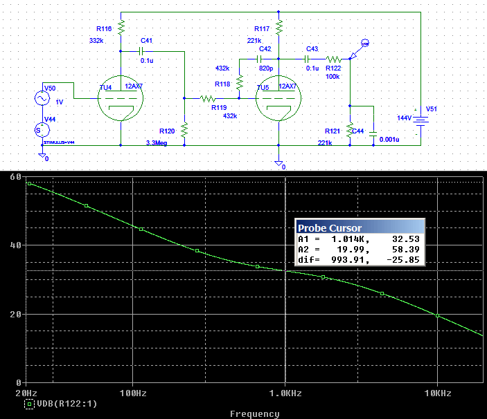

I have a Mapletree Ultra 4A phono preamp that just doesn't give me enough output. The question is can I modify the linestage section for more gain or replace it with something else? Possibly just use the phono portion with a different linestage that has more gain? I'd consider dumping the whole thing but I like the sound of it and the fact that I have a dozen 12SC7 tubes and a box of 50) 1634 tubes.
Since the phono stage has about 50dB gain, you must be using a low output mc cartridge.
The phono stage gain cannot be increased, but you could try a step up transformer.

I'm using a MM cartridge with a output of 2mv.

_I_ would say the Phono gain is less than 32dB; I get 32.5dB at 1kHz with a 12AX7 model which is a bit higher gain than 12SC7. See attached. That's the extra gain from Phono to Line, the way we used to figure it.
The Line gain is rated 18dB and looks like 20+dB. Added to phono gain this offers maybe 50dB gain from Phono to output.
50dB is 1:316, so a 5mV needle signal comes up to 1.58V which "should" be ample for most power amps, though the Volume knob has to be full up to get loud. (In this topology there is NO objection to running VOL as high as it takes.)

How about using a little silicon? Build a tiny pre-preamp having 5X gain and flat frequency response, from a super low noise opamp chip like the LT1115 (for moving magnet cartridges) or the AD797 (for moving coil cartridges). Install this between the cartridge and the existing phonostage.
Since 5X == +14dB, your new phonostage gain is (14 + 32) = 46dB , and your phono-to-output gain is now (14 + 50) = 64 dB.
The RIAA networks could be changed to avoid/reduce the significant loss of gain in the resistive divider R121-R122
