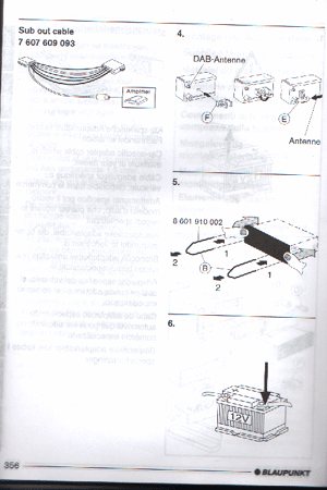

give me 5 min, i'll get the manual. its got all the information about the back of the head unit and what each wire is.
Cool - Do you hace the plug to go into C1?
Thats the interesting bit. It's a nice unit looking at the specs - on board x/o's ? nice!
I reckon if you try a decent car audio shop they'll have a lead that plugs into C1 and gives you the phono outs you are wanting.

Sub out-
I'm assuming the head unit has its own x/o and will send a sub bass signal out of socket A, to allow you to either use the speaker outs for mains, +1 amp and sub for sub use, or the pre outs + amps for mains, + amp and sub for sub.....
Re-read the manual as I'm not familier with this unit...
I'm guessing you don't have subs..
Usually they give you the sockets with a 'standard' connector at the other end when you buy the unit..
If you got them all you can just hack them up, or spend £20 ish to get the adaptors....

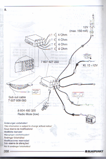

My system is the following.
I have the Front Speakers Running using the wires from the back speakers. The front Speaker wires are currently running the Subwoofer.
The Speakers are running on a Alpine MRP-T130 50Wx2Ch RMS The subwoofer is running on a Alpine MRV-T707 70Wx2ch RMS
The sumwoofer is running on 2 channels as its running off the two front speaker wires. As all the normal speakers are running from the rear speaker wires coming out of the head unit.

What about the crossover? - are you using the sub out from the head unit, or the front speaker out with no filtering?
My advice looking at your pics is:
buy the first lead and connect the front left/right to your Alpine amp, and your front left/right speaks...
Do you need rear speakers? - I only use a pair of infinity 6 1/2" in the front, and with a sub this is plenty - I've always found that rear speakers mess up the sound rather than help.
If you want rears, use the rear left/right speaker connectors from your head unit, and the fader to keep them quieter than your fronts.....
Then buy a lead for the sub out and connect that to your sub amp, and your subs...
If your head unit has a built in x/o then use it! - set it as low as you can, according to how loud you want to go and how loud your front speakers can go..ie: my infinitys are loud enough crossed at 90Hz, but my old kenwoods needed to be crossed higher as they distorted in the bass more at lower volumes..
If your head unit hasn't got a x/o then you really need to look into buying one...
Rob
