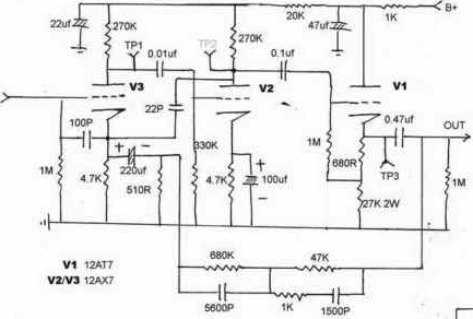

I have arriving PCBs with the following schematics (see attachments), one is for MM only, the other is for MC or MM.
Now the tube amp I have to feed is the Sweet Peach FU50 which has an input impedance of about 100k (this will be 'arranged' for phono input).
For my MC cartridge (Ortofon MC20 sII) needs to step up about 10X gain, so I was thinking of a cunning plan.....
Looking at the (left hand) 3 triode MM schematic (2 + CF buffer) I was thinking if I convert the cathode follower to a 10x gain stage it would a) be ok for MC, b) reduce the filament/cathode voltage and c) convert the CF buffer.
However the NFB EQ would now be the wrong polarity (PFB!) and 10x too big, so can anyone suggest a simple change to make that work?
Also any ideas on the plate and cathode resistors for 10x gain for that tube?
Oh - and views on my cunning plan please 😉

I don't think it's as cunning as you think - 100K Zin of your amplifier will load the last stage and drastically change its operating point (all other things remaining equal as shown on left picture). That buffer stage is probably there for a reason.

Perhaps not so cunning...
The noise figure of the tube at the input is not going to be low enough to provide very satisfactory snr - I would use that transformer and leave the rest of it as designed.
What you propose requires a legitimate redesign of the entire phono stage.
Why not exchange the input triode for a cascode with a few 2SK170s below and an E88CC on top? It will be a some work to redesign both input stage and EQ. Also I doubt noise will be low enough, though. About CF you could as well go sand.

Your picture shows common cathode stages with 270K anode load. 100K in parallel would change the parameters of operation significantly. This is what I meant above.

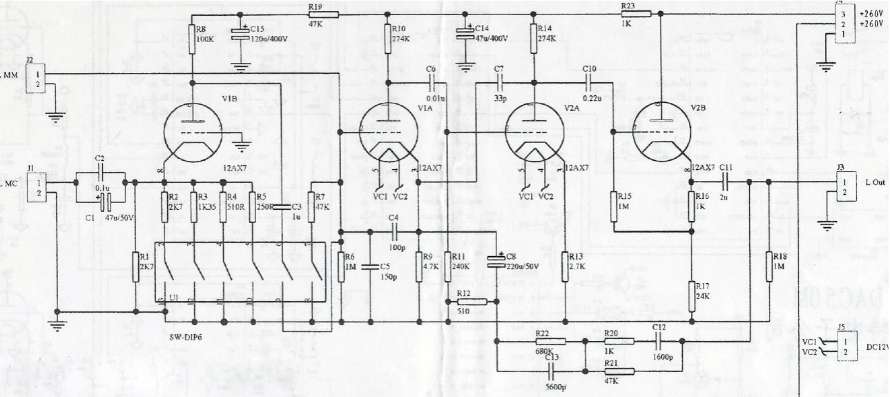

So... as I have an MC cartridge and no SUT I will end up using the 2nd all 12ax7 schematic (a populated PCB is on its way). I realise the S/N is not great but I do not think I can do much about that here.
....BUT I have heard that the AX7 makes a lousy CF stage (as used in the right hand MC schematic), and I have a drawer full of nice ECC88 tubes (BVC, Mullard etc). So I'd like to use the ecc88 in place of at least the final tube if not all of them - which means the final two triodes will be ecc88 rather than ax7.
First Q - is this a good idea?
Secondly:
So I have to modify the heater connection and the biasing - could you suggest any good values to use (i.e what changes for using ECC88s)?

Necessary, but not sufficient. Here's a few other things to consider:
1. The tube- as you've surmised, a 12AX7 simply can't be made into a decent CF, no matter what. What you want is transconductance, making ECC88 (as an example) a far better choice.
2. The load- in order for a CF to have good linearity, the load has to be considered in the design. For a feedback RIAA stage, think about what happens at high frequencies when all of those capacitors have a low reactance... As a good first approximation, you can calculate what a tube's distortion will be if the load were in the plate circuit, then divide that by the gain when going to a CF configuration.
3. The operating point- this determines transconductance, distortion, and load tolerance.
The heater issue is a bit tricky- you have to balance heater-to-cathode voltage ratings, account for differing voltage requirements (12V vs. 6), pay CLOSE attention to noise injection to the cathode, and accommodate the current requirements. And on top of that, the circuit needs to be insensitive to variations in current requirements from tube to tube; the ECC88-oids are notoriously variable, with some being 300mA, others 365mA, with almost no attention being paid to what the spec sheets call out for a given type number.
I've said it before, but it bears repetition- design of a good phono stage is the hardest problem in audio electronics, and for that reason, it is almost never done well. However, it will be a VERY educational experience as you peel back layer after layer of the sonic onion.
What is wrong with the 12AX7 as a cathode follower. Obviously a 6DJ8 will give a much lower output impedance, but who cares if the 12AX7 follower provides an impedance which is low enough for its purpose? The output impedance will be less than 1kOhm which is low enough for MANY applications.
Torben
Torben, the problem isn't just small-signal output impedance (though that's still an issue in most applications), it's the very limited drive capacity. A 12AX7 can't swing more than a tenth of a milliamp and maintain linearity. And even that tenth milliamp is pushing things, especially when there's any capacitance in the load that needs to be charged/discharged at high frequencies.

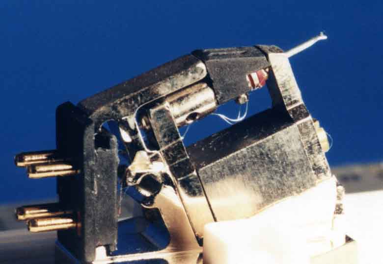

Slightly off topic, I know, but have you dared take the body off the Ortofon? I used to have one of those and really liked it - but it sounded even better with the body removed and a tight-fitting wedge of balsa wood pushed between the magnet and base plate. It's a terrible photograph, I know, but you should just about be able to see the white of the balsa underneath the white of the photographic flare.
