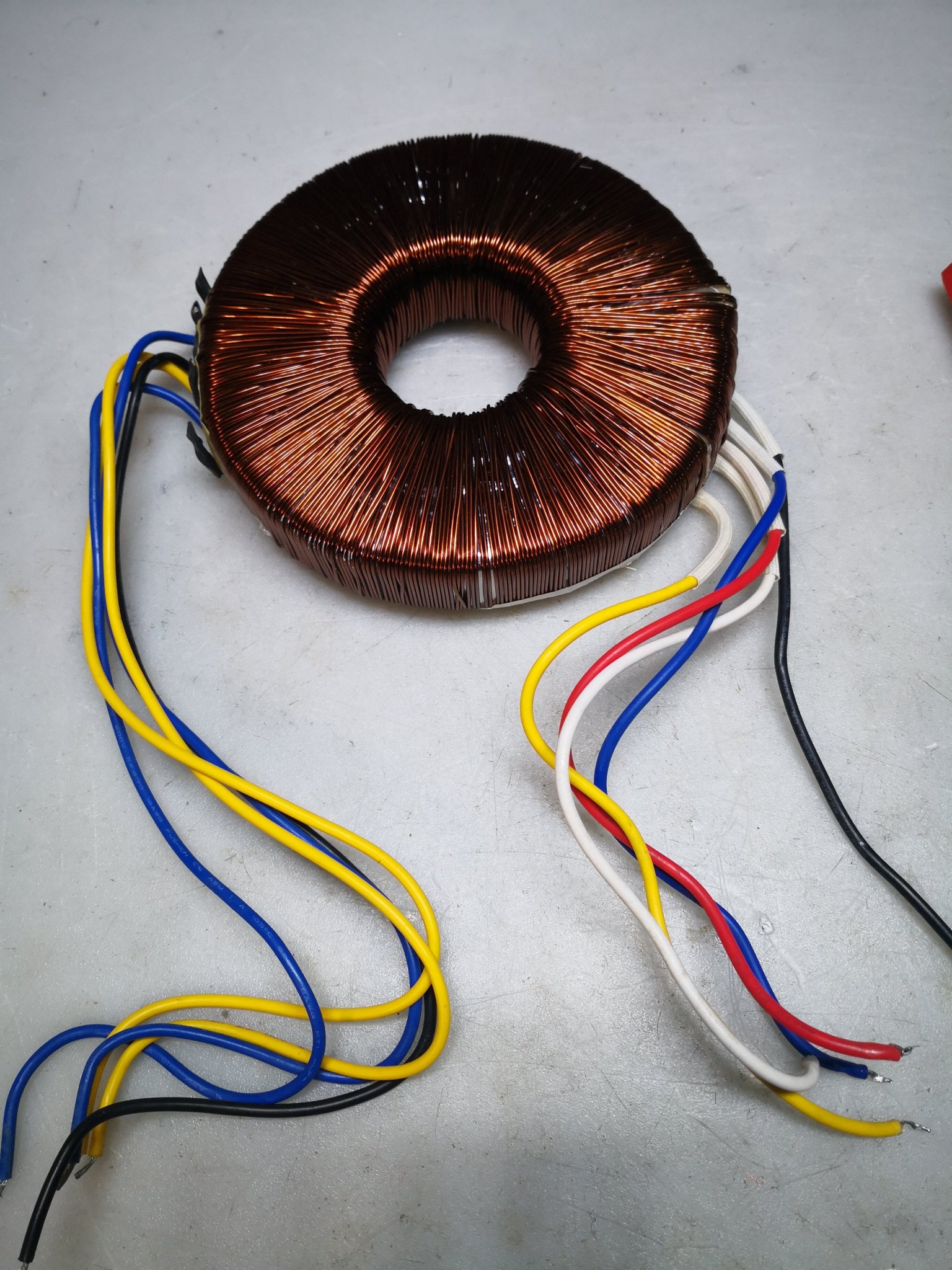

huggygood this is not the full manual.i have the full one and is no info about transformer output.
look at the power supply diagram, with your measurements directly on the transformer, you can deduce which goes where.
And if you have 63v capacitors, you already know roughly the AC secondary voltage, +/- 32 to 37 Vac
No i think is not worth to repair but if i know the output voltage i have few extra transformers and may be fit one or get one for high voltage and another one for low.or i send the old one to winding repaire shop to repaire.new amp cost 180€.
guys i have done the test with one samson servo 300 transformer 35-0-35 volt and it works.the only problem is not space inside the case i do extra separate box for trans.the amp is not for my mobile jobs and stays allways on studio for 1inch high frequensy drivers.thanks for answers.maybe later i by one smaler for 55euros
I also think that you need to start with the power supply diagram! This is the starting point and there are already further dealt conclusions!look at the power supply diagram, with your measurements directly on the transformer, you can deduce which goes where.
