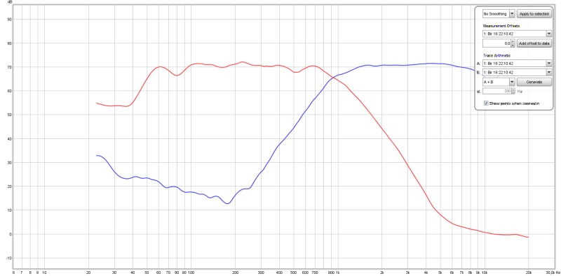

  • The crossover was all over the place, I have the transfer function of xovers, see attachments. Obviously the "24dB/oct LR" is a bit overstated in the specs. Not to mention the ridiculous 15dB boost at 20kHz.

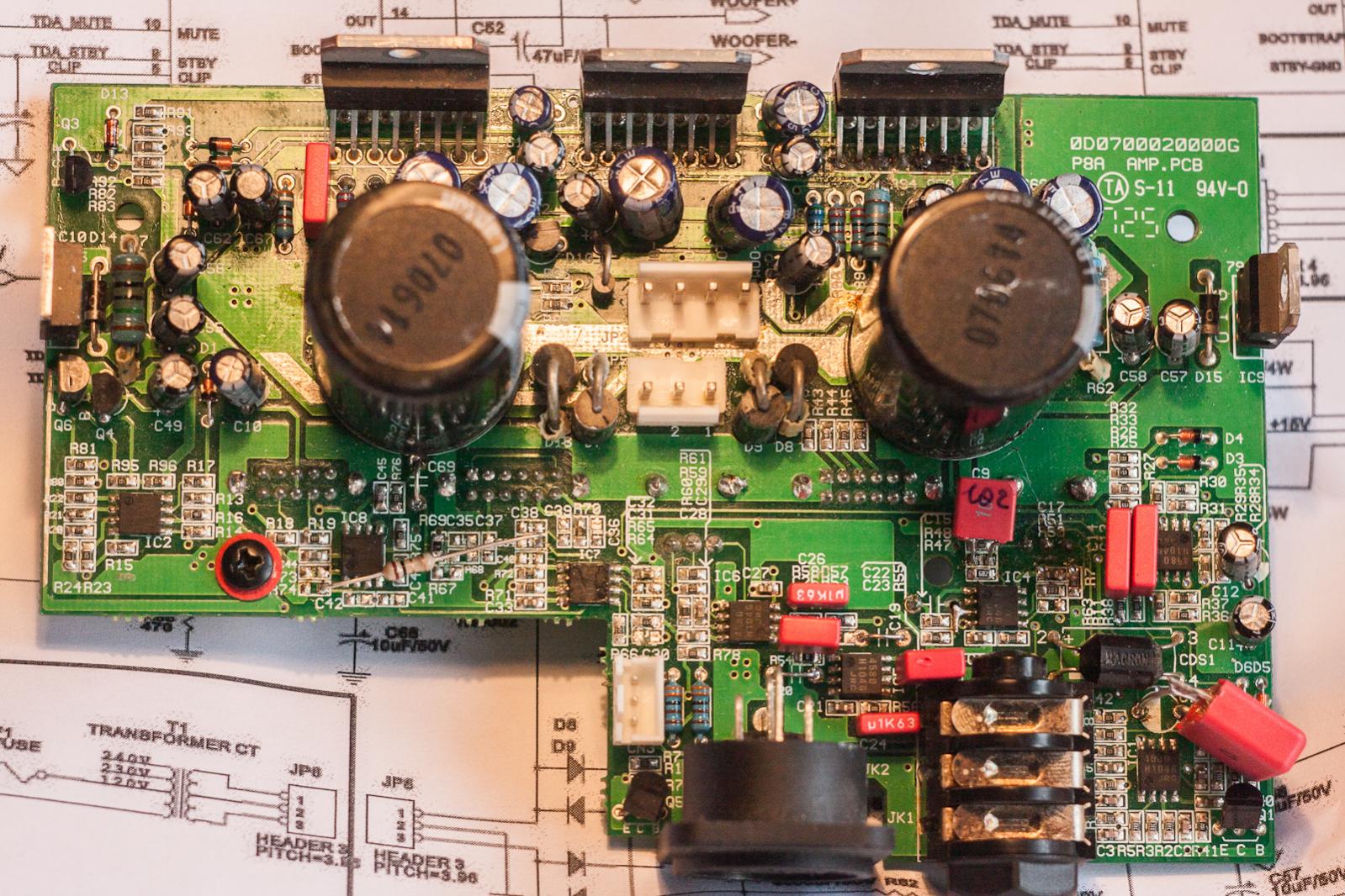

  • Very nice and compact amp design with toroid transformer (I'd estimate about 250W), all enclosed in nice metal casing.
  • Plenty of circuitry to play with (2xTDA7293 for bass, another one for the tweeter, auto-off circuit, overload protection, plenty of opamps in the signal path to play with)

See attchments 2 and 3 for what I ended up with. I'm very pleased with the sound and new appearance of the speakers, it was a long but very interesting journey to this point, with some quite radical design choices. There are things I'd do different now but that's probably the case with just about any project.

Hi, I was looking around for some way of replacing the internal board of my Phonic P8A with active/passive x-over and external ampli to retain the speaker.
My PCB is dead after power surge: power comes in, leds turn on, and I checked circuitry and voltages all the way to stabilize power ICs, yet no sound at all.
I read your article and I was thinking of maybe converting this to a passive monitor using an external ampli + passive crossover (I welcome suggestions) or use an active x-over with 2 ampli, one per way.
How did you do it? Any suggestions?

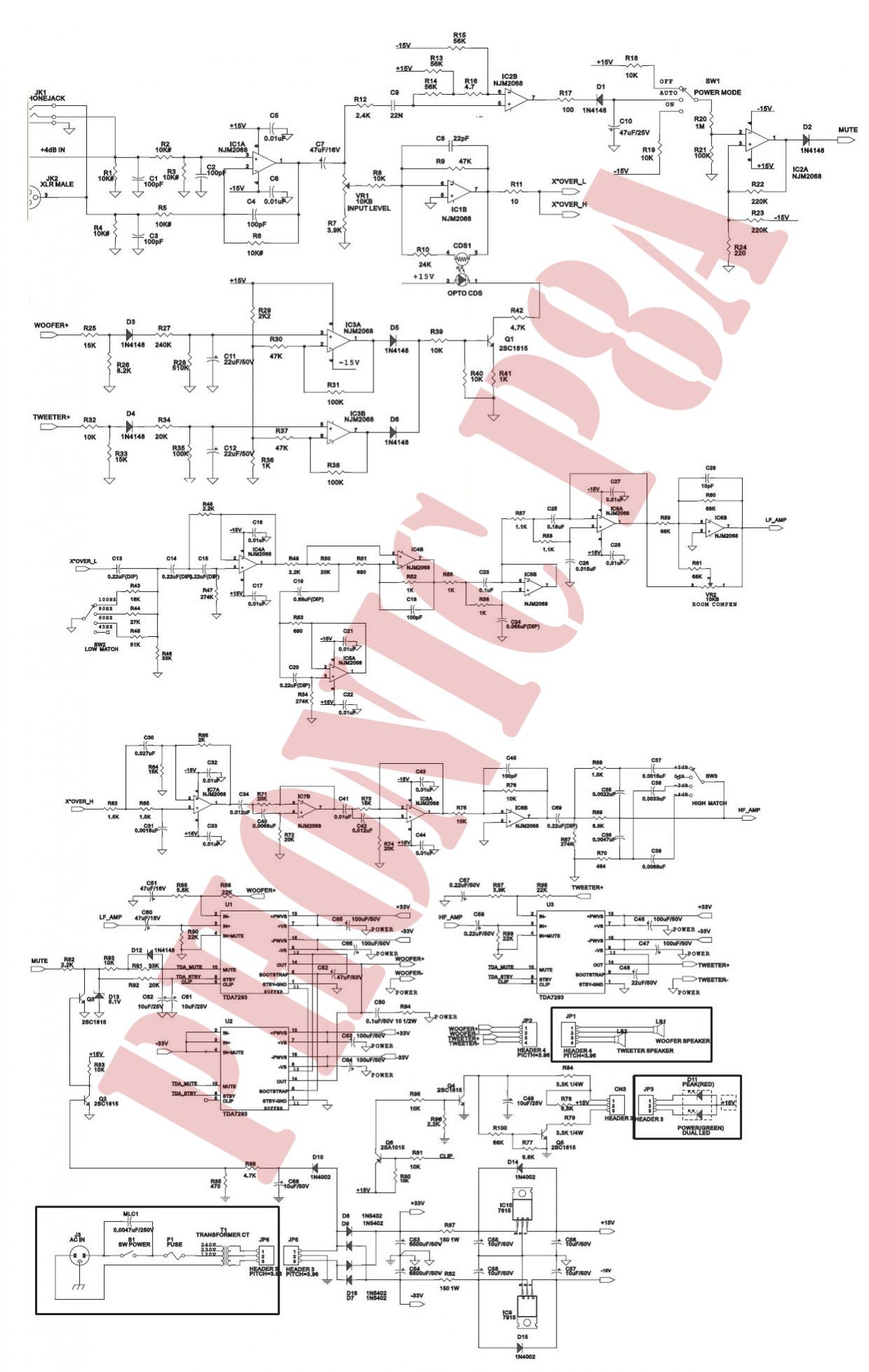

Just posting some stuff for archival purposes if anyone is interested.
The waveguide added several dB boost to the 27TFF in higher mids, improved directivity and and decreased distortion (good). To make it match the woofer I added a 10uF caps in series with tweeters, which corrected the boost nicely and also allowed for lower order high-pass on them to perfectly match woofer in LR4 arrangement, phase and time-wise.
I changed all the signal caps and probably some if not all 4580 opamps to NE5532:
Also attached the schematic for anyone wanting to tinker with it

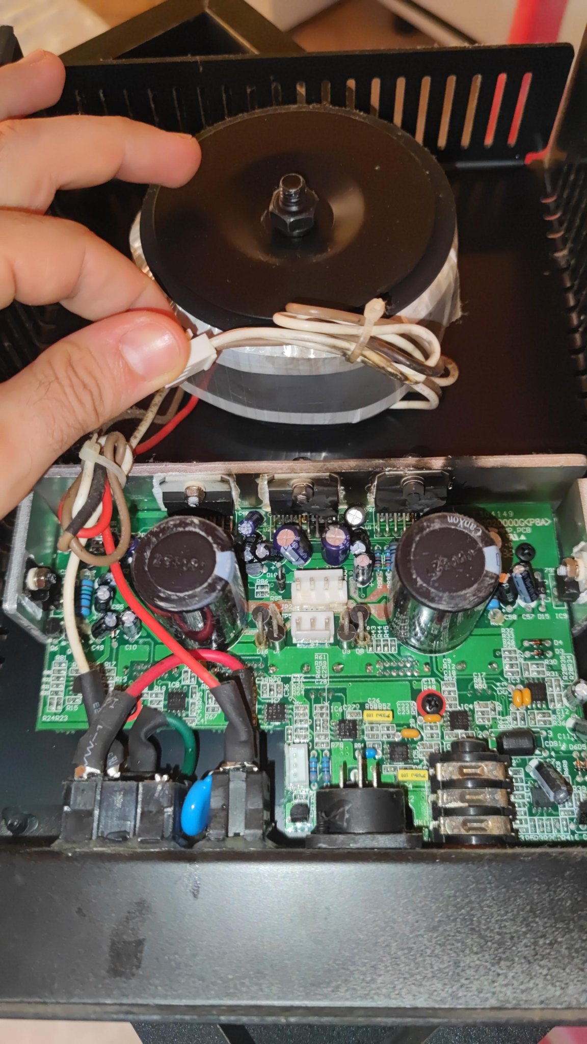

Hi everyone I'm Alfonso.
I need help, my P8A monitor smoked yesterday.
I can't explain how it could have happened: after 2 hours of use the speaker was in on but without audio input (it was only powered). I opened the back and from what I see is that the power cord is loose at one point.
The cable touched the TDA7293's heat sink, (the heat from the heat sink melted the cable and created a short circuit).
Design error or assembler's error.
I have dealt with power amplifiers but never had such a bad situation.
I hope I can fix the circuit.
Do you have any advice? I saw that you have posted the circuit diagram and this helps me a lot (even the amount of damage).
I am attaching a photo of the damage. the two TDA 7293 of the woofer are cooked.
I await your precious advice.
Thank you very much.
