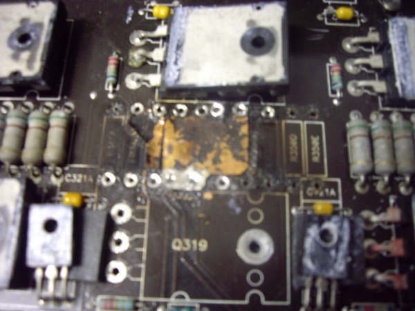

I'm on a mission to find the output stage schematics diagram for a PG Titanium 500.4.
My repairer is just about finished replacing the burnt components but there are a few fine traces on the board he cannot trace to a location due to the burnt board.
Please help me help him. Thanks in advance.

I don't have the schematic but he shouldn't need one on a 4 channel amp. Generally, when someone lays out a board, they produce one channel and copy/paste the rest of the channels. If they're not an exact copy, they will be a mirror image. Either way, it shouldn't be difficult to trace the circuits.
Could you post a pic of the area you need? I have two working 500.4's on my bench.
Plus I must admit, I have never seen a burnt board on these that was so bad it could not be traced easily. The Brown solder mask is opaque, but if the trace has lifted or melted its usually easily visible...PG uses fuse type resistors throughout the main amp stage of each channel to avoid such things from happening, so I am surprised that such a situation could have occurred. And I have been repairing PG since they came to market....🙂

That section is the same as the ones beside the burnt area. It is composed of 10 each 0.51 ohm 1 watt resistors and 5 of each are paralleled to make a single large wattage Emitter resistor array for each output of that channel., times 2..of course. They may not be traced exactly the same but the circuitry is the same for all four sets of outputs for each channel.
I suggest that your tech remove the 10 one watt resistors to the left or the right of the burnt area. they will be exact circuitry of a similar layout. Just like Perry said they would be.
If the copper traces are not easily visible because of the Brown solder mask some simple ohm meter checking should show the way. E-mail me your email address so I can send you a simple layout of this section of the amp....🙂
