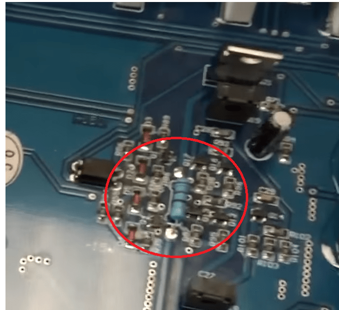

Thank you i have done some research online and could only find one video of some one taking the lid of the same amp how ever I carnt get a clear image of the area but it looked like the resister was a biggish light blue metal film resister kind of looked like brown black brown gold or as I seen it gold brown black brown it was hard to tell but the track runs strate to tip42c emitter leg I did put a 100 ohm resister there and the amp powers up fine but plays like ots under water muffled sound
Post a photo of the entire board and another close-up of the area with the resistor and nearby components.
here is a picture i found online the only one i could get my hands on doing research

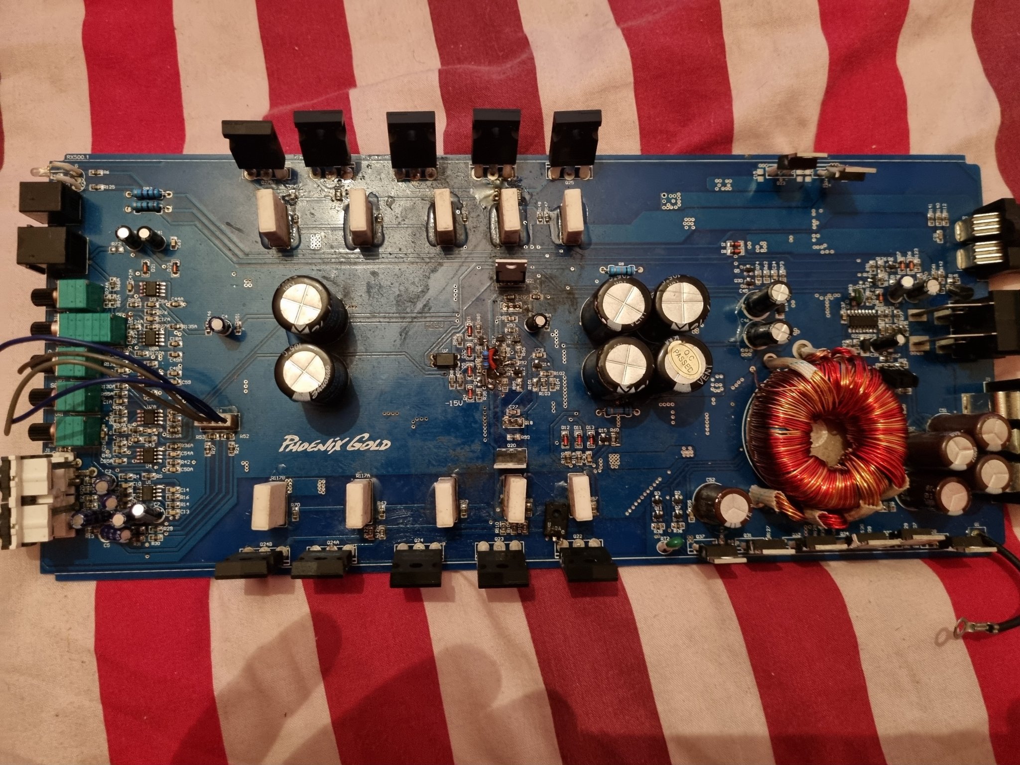

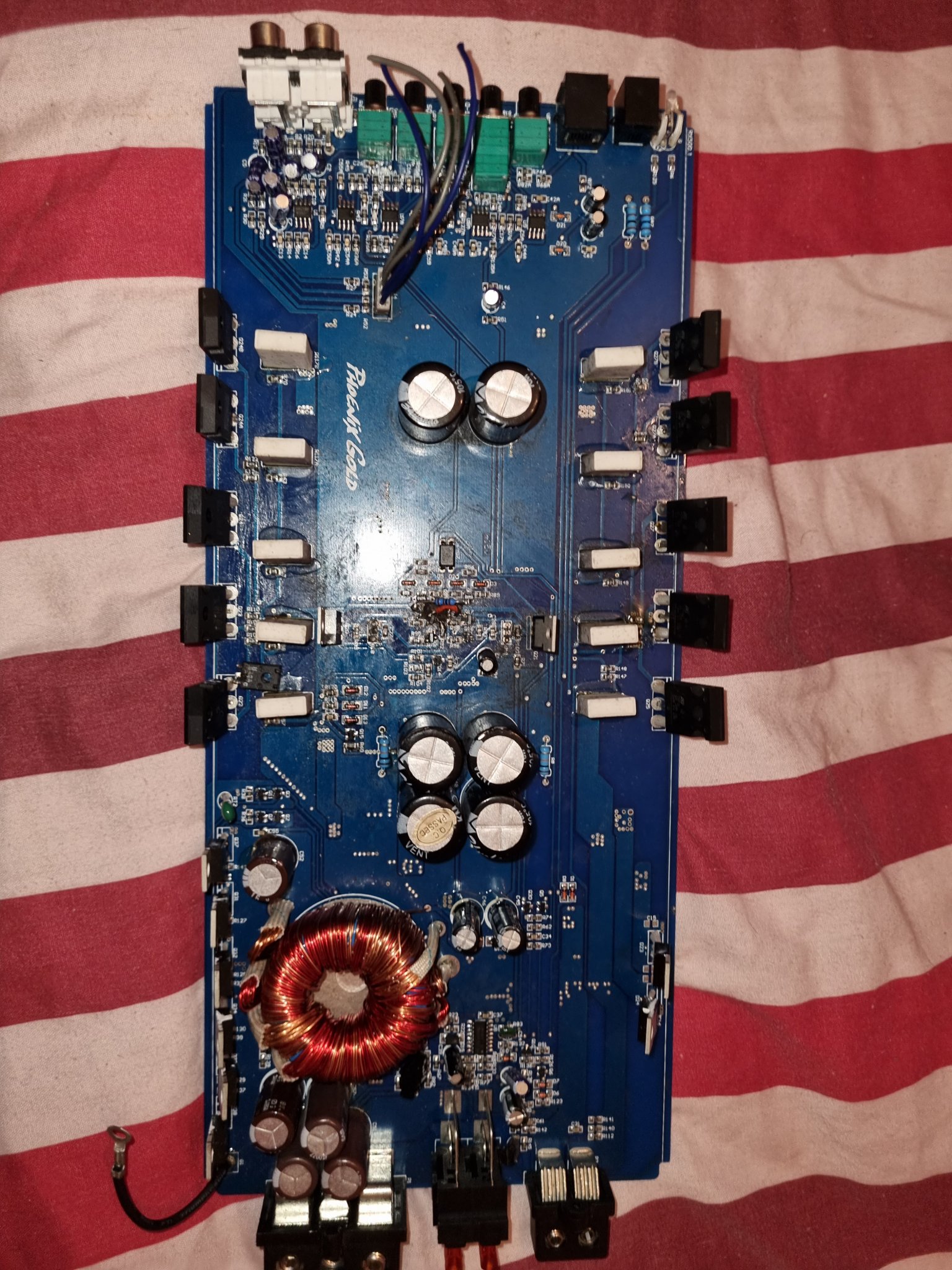

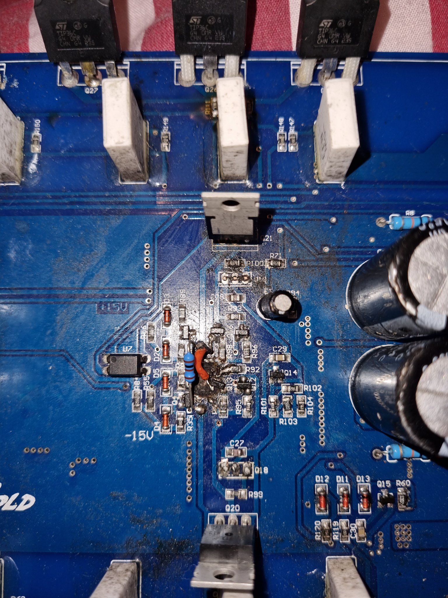

HI sorry i wanted to show you a picture of a whole board mine currently as the 649A and 669A resisters removed awaiting my replacments also the red wire you see is where i had to repair a damaged track from the blown area here are some of my board thank you for your time

as with any amplifier output section failure.
sometimes damaged components are replaced
and amplifier will resume working.
but other components might have been damaged.
the amplifier likely has current limiting / VI limiters
which could be simple single slope or multi slope.
point is there is usually multiple diodes/resistors in the limiter that could be damaged.
or often VI limiters will have capacitors to slow the response when operating.
I cant tell exactly by the board, but can see some diodes and few surface mount
capacitors / resistors which were likely part of the limiter section.
looks like the VI limiter transistors might have been removed.
which could solve the problem. but if any diodes or resistors have failed closed
they could still cause issues.
you would have to repair the VI limiters, or lift/remove any diodes/resistors/capacitors
involved with the circuit.
likely there is diodes / resistors/ capacitors failed closed in the limiters. so removing VI limiter transistors
would not completely remove the failed limiter section
transistors are more likely to fail closed. but can fail open.
be good to check all output devices for open
also check large ceramic emitter resistors for high drift or open.
looks like tip41/42 driver transistors and tip 35c/36c output transistors
