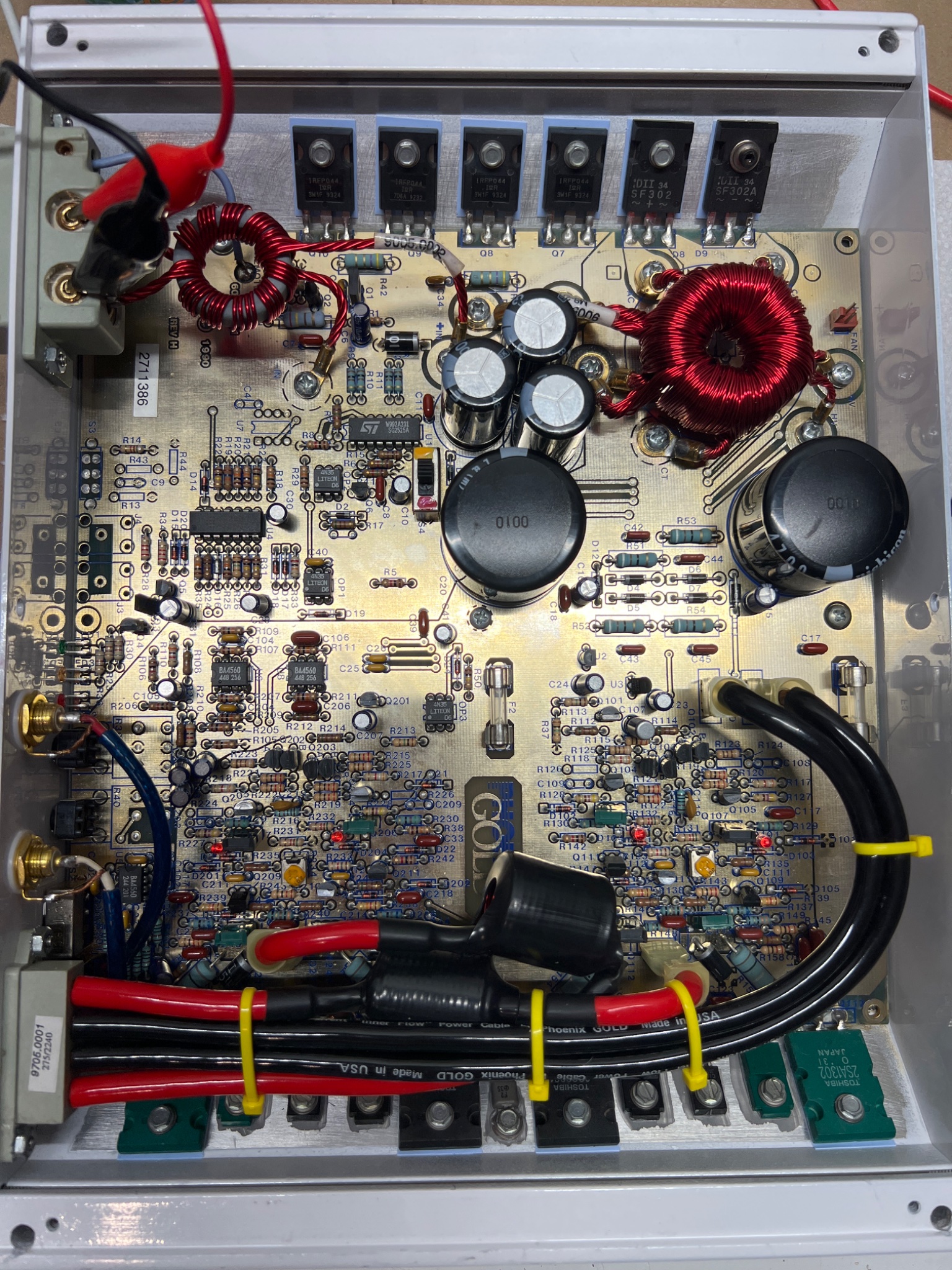

I have a MS-275 that came in for repair due to leaky caps. I have replaced pws caps and rail caps. I also had to replace U8 (BA4560). I went ahead and replaced U6 as well.
Currently the amp powers up the driver circuit leds light up for a second and cut off. The audio outputs have shared rail voltage. I read no voltage across the bias control pot.
