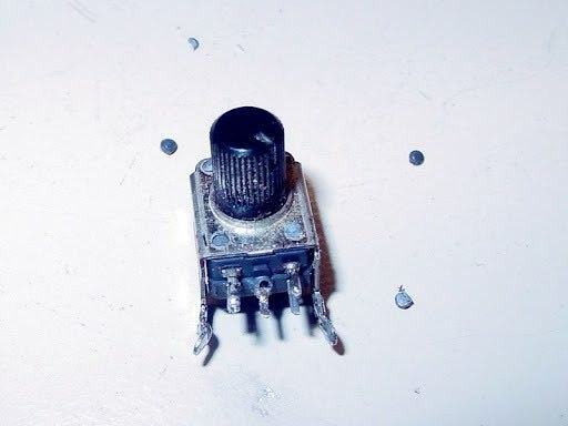

Gain pot of my PG M50 amp is not working properly. I am trying to find suitable pot instead of original one. Nobody makes that 50K c taper pot anymore.
Gain pot has 5 leg in PG M50. Now, It's very hard find to it.
The reverse log pot is difficult to find but you can use a linear taper pot. It may not work precisely the same (output level vs rotational position) but it will work.
Perry Would we have to connect the pins with wires Bourns instead of Gain Pot of PG M50?
Bourns PTV111-1420A-B503 Potentiometers
See attached.
How large is your pot?
https://www.bourns.com/docs/Product-Datasheets/PTV09.pdf
^^^ that's a 3 terminal pot.
Another option may be to use a standard trimmer pot and use a screwdriver to adjust the gain. If you can't get a reverse log, use a standard log pot facing the opposite direction.
I am not certain how to express my gratitude for this wonderful attachments you shared.
I think it was impossible for me to find this.
Thank you for your effort and time.
If we can salvage the M50, it will be on this board. Can't wait to hear back. I'll keep you posted.
