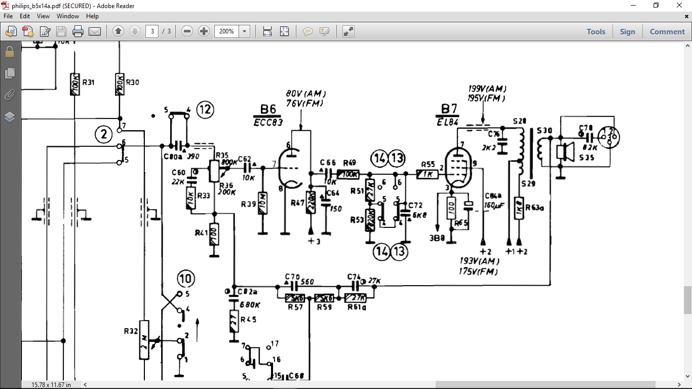

I have a couple of 1960/61 Phillips hi z amp radios that both use the hi impedance little 6" octagonal speakers with the high voltage to the speakers. one model uses small OT's and el84's the other has no OT and el86's.
I have some 10" hi z 800 ohm speakers with no OT's attached i wish to connect. the extension speaker out plug has 3 pins. please see schem. do the extension speakers ment to have OT's with them as well and will they work on both models and how is 3 pin wiring?

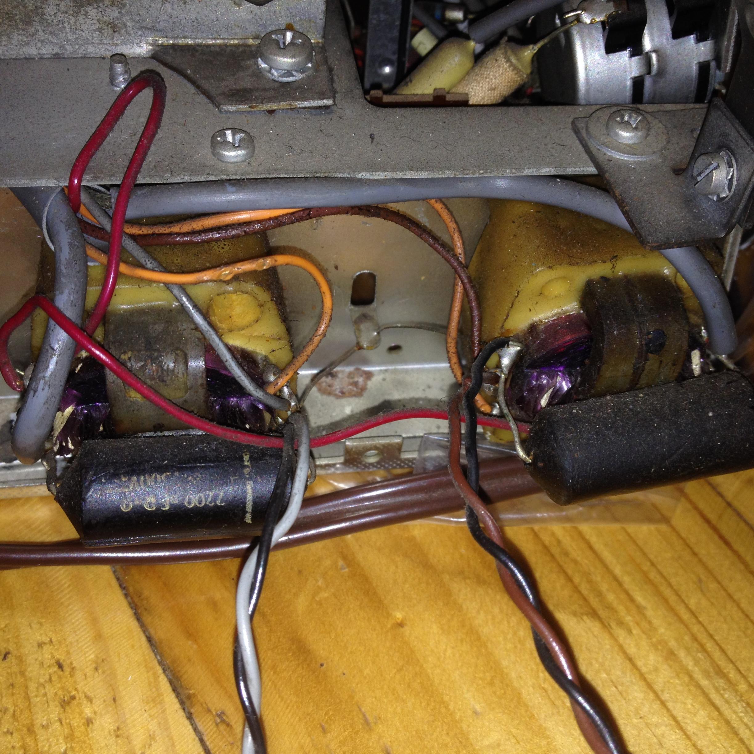

hi, these are slightly different style of OT's i have had the speakers running as mains, am not sure why the 3 pin output for extension speakers.
The EL84 SE also seems to be for 800 ohms speaker. The output transformers have some 2.5 turns ratio (5k to 800 ohms).
Extension speaker should be connected between pins 2 and 3. Pin 1 (to 3) seems to be for extra tweeter only.

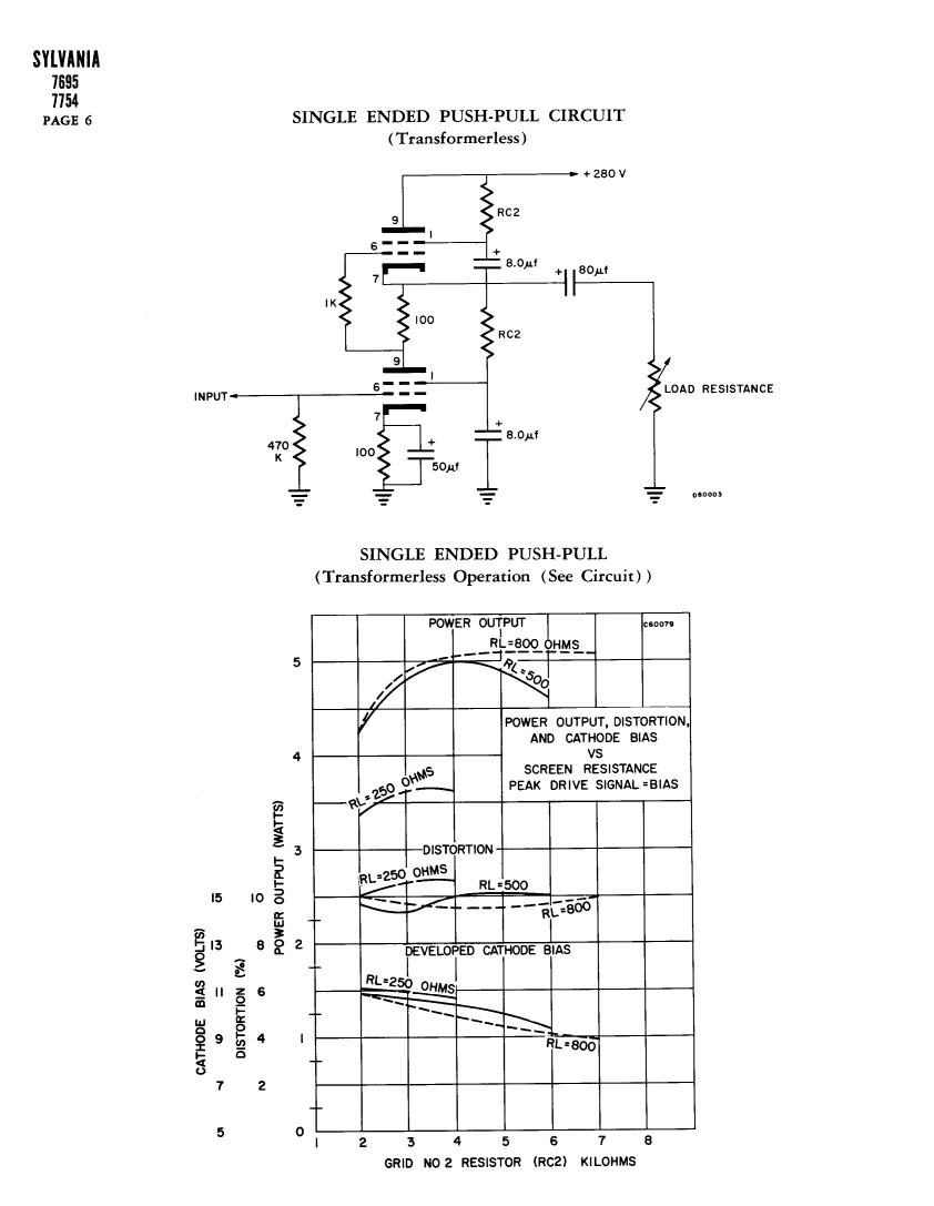

I have not seen this sort of output stage for 800 ohms speakers before, only the EL86 single ended push-pull.
Thanks , I got confused too when i saw the output transformers at first. the other model uses four el86 and has none.
