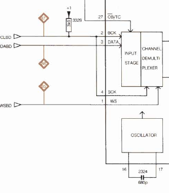

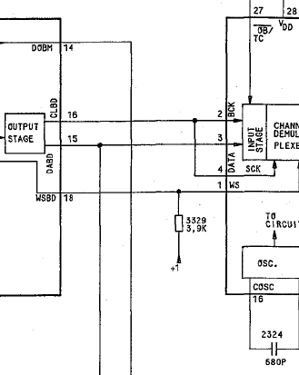

I've got a question about Philips CD-s based on TDA1541 DAC. Some of them have Pull-up resistor 3.9k (3329 on "typical" Philips PCB) connected to pin1 of TDA1541 (WS). Some - to pin2 (BCK). Which option is right? How does it works here?

TDA1541 can receive input data in time multiplexed or simultaneous mode and this is determined by the connection of pin 27 to -5, +5 or GND. Consequently, pins 1 to 4 change their assignments and the pull-up resistors (they can also be 4K7) are applied.

First pic. Its Grundig CD-9000. Second - Philips CD650. Both of them have +5v on 27 pin. But pull-up resistors are not the same. I am confused...
It doesn't actually require a resistor, certainly not a specific value - read the datasheet. And for example, Naim TDA1541A-based players just apply full+5v supply to pin 27 to set I2S input.
