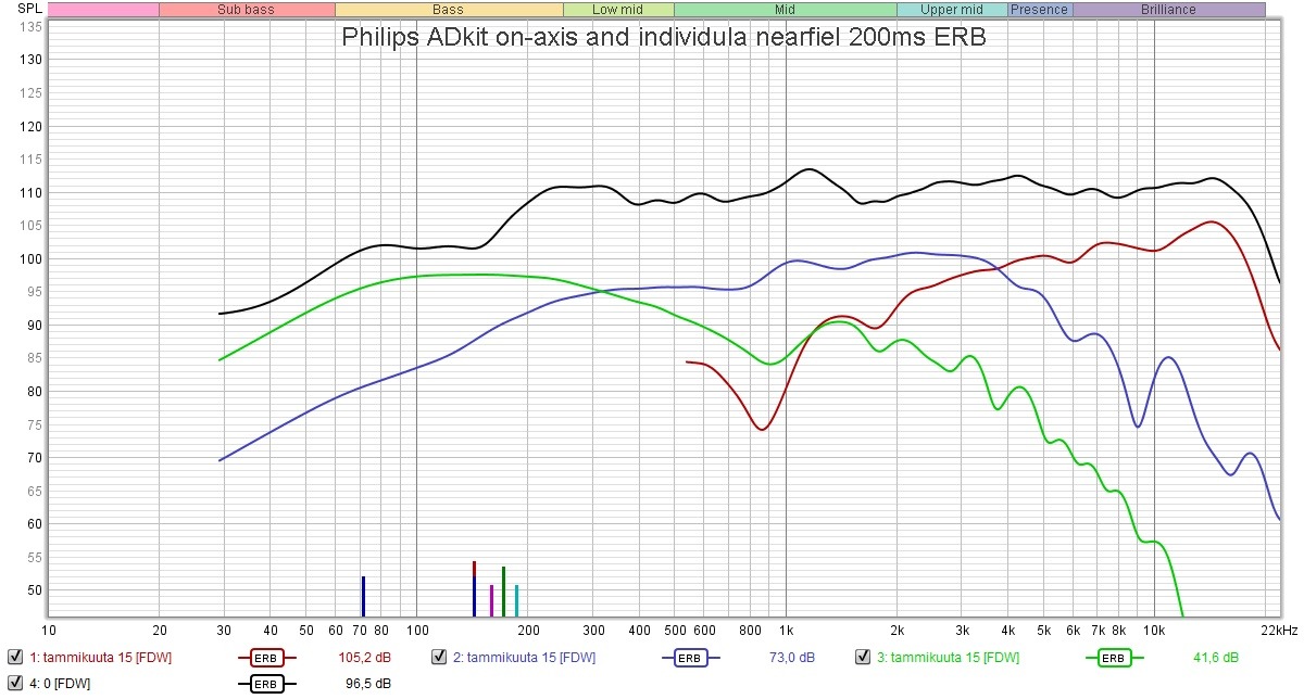

My Philips AD2525 kit from 1972 - 50th Anniversary
My diy hifi started at age of 12 with this speaker! Actually this one is the second speaker I assembled in 1974, to make a stereo pair. I used them until 1988 at my parent's house in my room, in corners. I had to set bass level to max, and now I know why. I have had them stored since, but now I'll get rid of them! I made bigger 3-way kit speakers for my own apartment in 1882, which are now at my son's apartment! DiY hobby re-incarnated around 2007, after busy family years.
Please, tell about your own Phips kit memories in this thread!
More pictures and measurements here https://photos.app.goo.gl/7SpdVrRZknaJF9Ah8

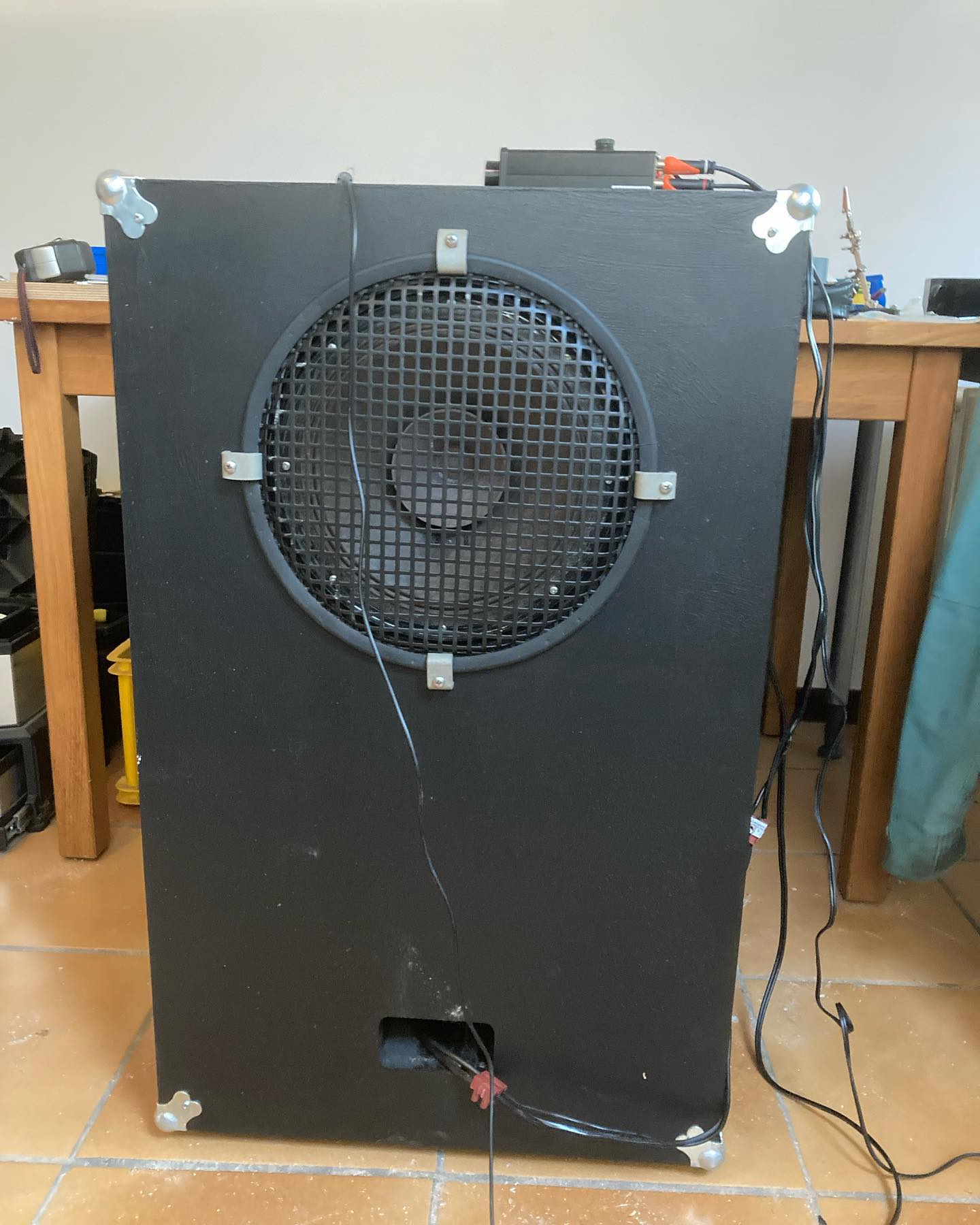

It's a very recent memory, but i did get some old Philips AD1065 fullrange drivers saved from being trashed and i put them in an old subwoofer box (150L ported) to be used in my workshop as speaker. And it's actaully a great fullrange speaker like that, with real bass. I knew these drivers were great, but not that great in a "not designed for the driver" cabinet...

Given both pair's parameters, low-mid Fs, middling Qt and high Vas, waxx's choice of a large enclosure makes a lot of sense to me.

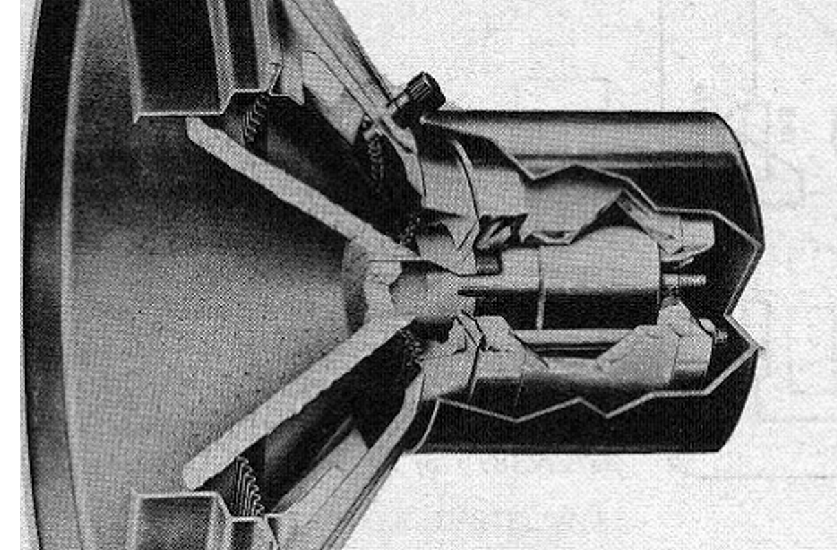

I made enclosures for my two AD5201A. I combine them with the 9710AM in open baffles, using bi-amping (2 x 2 channels). There are many reports on Dutch forums of the three brass bolts that run through the magnet breaking (and by doing so, destroing the coil). So that is why I supported them with an additional wooden structure. A link to some photo's on my site:
i dont understand the quoted, what does it mean? speaker has some problem with the excursion? so i need to remove bolts? can you share more details about?

About the problem with the AD5201: There are three brass bolts running through the magnet. They are there to attach the magnet to the spider/rest of the loudspeaker. These brass bolts tend to break in time (for instance when the enclosure the AD5201 is in is being moved). If all three bolts break (or even when only two bolts break), the shifting/falling of the magnet will cause damage to the coil/conus. So these bolts should either be replaced by stronger bolts or the magnet should be supported, like I did in my enclosures, so that the full weight of the magnet doesn't bare down on the bolts anymore.
I don't think you need to touch the cone at all. There's just one possible caveat: If the three bolts don't end in threaded holes, but with nuts instead, which I don't know, replacing them is either impossible or will lead into some major surgery (dissolving the outer spider glue and lifting the spider to get access to the nuts, removing the dust cap/whizzer cone to allow for centering the VC during re-glueing the spider...).
Best regards!
thanks PFL for such a valuable information! mine speakers are still in great shape, after so many years. i was running them last year shortly and they are still ok. i will try to do the same or try to remove at least one bolt to see it how will go, thx again
