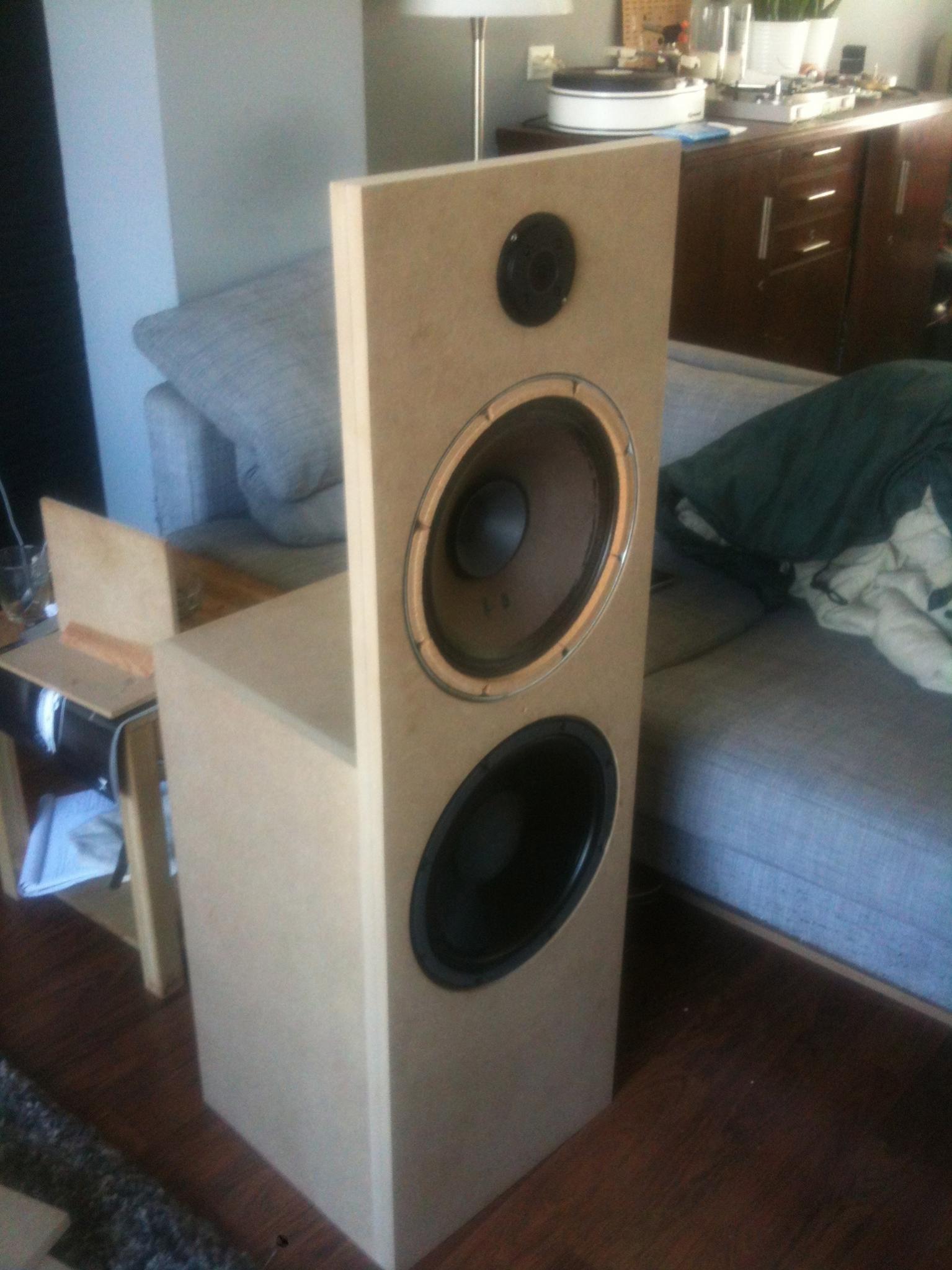

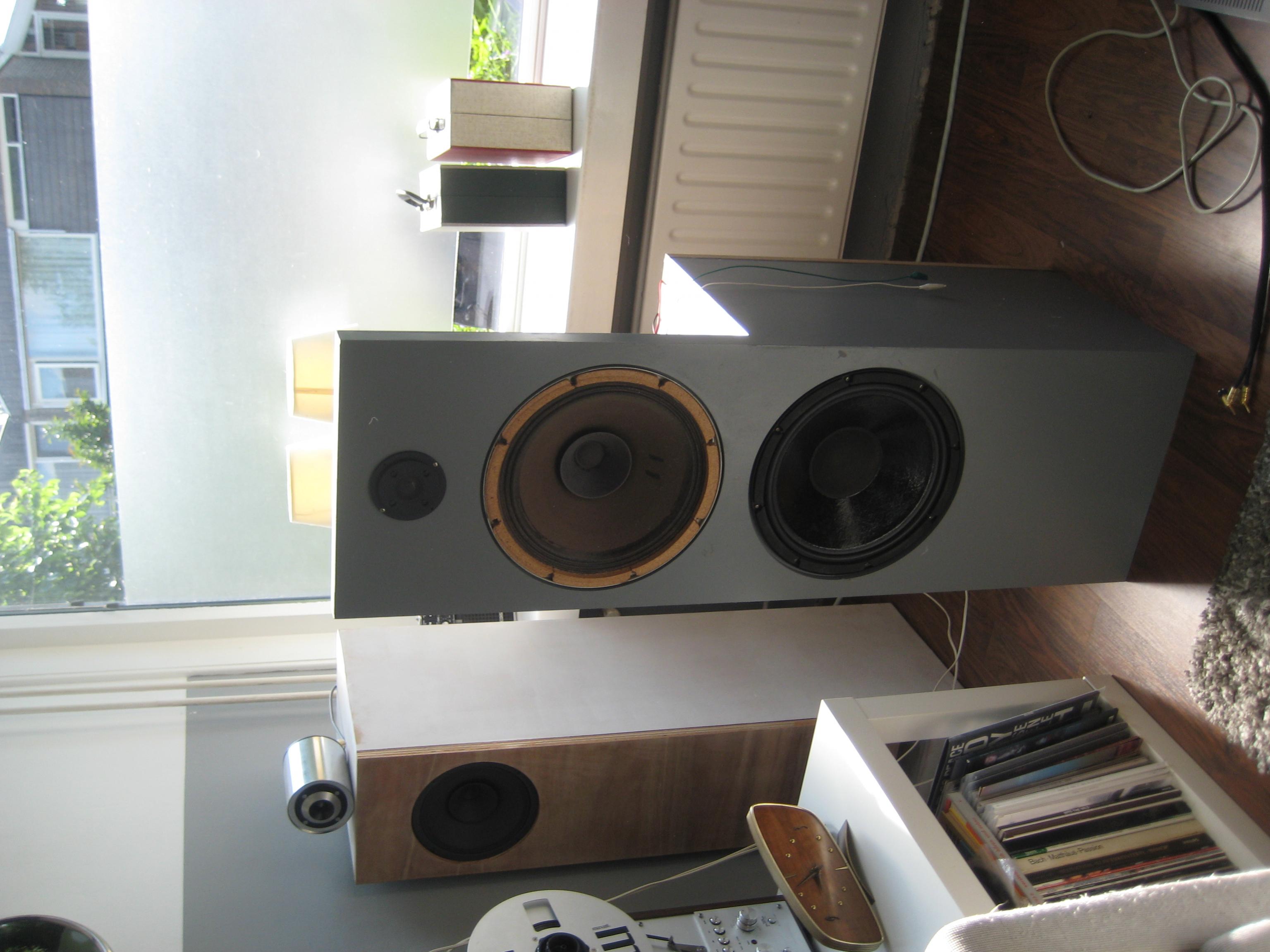

Last year I build a semi open baffle with BR sub. This is my first serious build.
I used Philips to units to build it. The units are:
AD 121000M/8
AD 121000W/8
AD 0160T/8

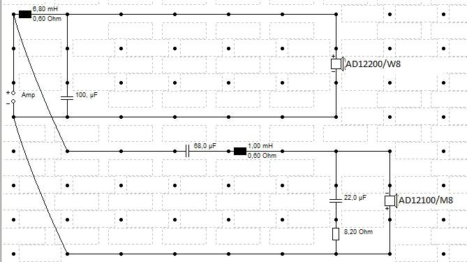

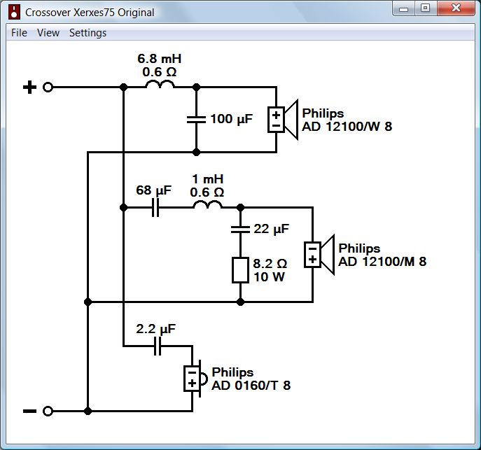

(see attachment for filter)
The sub has a 85 litre (about 82 litre without filling/ lining) BR cabinet.
The baffle is 38cm /15inch wide and 120cm/47.2 inch wide
On a Dutch forum I found someone who could help me since I don’t have any experience in building speakers. Size wasn’t that important but I wanted the wide as small as possible. The result is seen in the pictures.

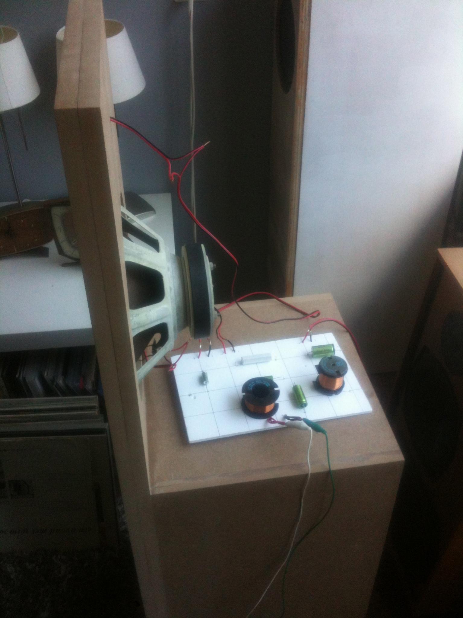

It sounded great! But after a while I found it something dull. So the simple experimenting began. I changed the cap on the tweeter (2,2uf), removed the coil on the AD121000m/8. And the sound sounded much more “fresh”.
I added straight wings, first extending to the rear after that I widened the baffle to 60cm/23.6 inch using some thin floorboards. This improved the sound even further. The Bass was far more prominent and a bit clearer/deeper.
This improvement got me thinking that there must be ideal design, since ideal isn’t always practical my question(s) are:
1. Must I build another design (I am open for that)? Or
2. Do I just increase the wide off the baffle (and how much)?
3. Now the speakers (except the tweeter) are flush with the baffle, if I add another layer to widen the baffle this is no longer the case (say 9mm/0.4inch).
4. The tweeter now has its place on the baffle is this right or do I place this in a separate small housing, or do I place it somewhere else on the baffle).
5. Do I lose the BR cabinet all together?
6. Or is it “pretty” ideal right now? (or must i forget it all together...🙂

The tweeter AD160 is a decent tweeter but it needs a proper crossover. But it need more than a cap as a crossover. The black line is the tweeter with no crossover. Red is with a serial cap cutting at 6 kHz. At 3 kHz it is 6 dB down as it should at 1500 Hz -10dB instead of 12 dB not bad. But at 750 Hz It should be 18 dB down instead it is only about 3 dB. This is terrible and will add a lot of strain on the driver even if it adds "brightness" to your speaker
-18 dB would mean that the driver would get less than 2% of the power at 750 Hz instead it gets about 50%.My guess is that the AD160 has to low sensitivity to keep up with the 12" unit and that you need a more sensitive tweeter. If you have a 4 Ohm unit you get 3 dB more for the same voltage.
In order to improve your speaker, you first have to find out what's good and what's not. Otherwise the chance to succeed is not very big.🙂

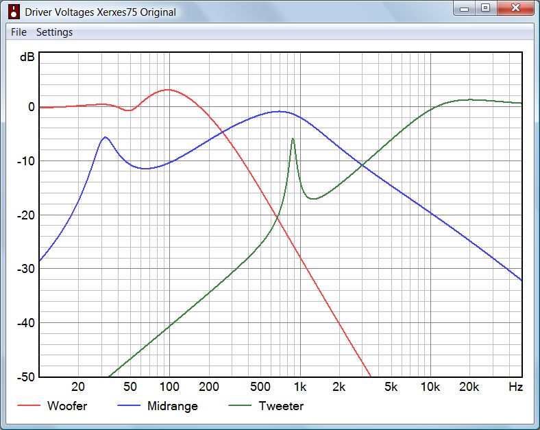

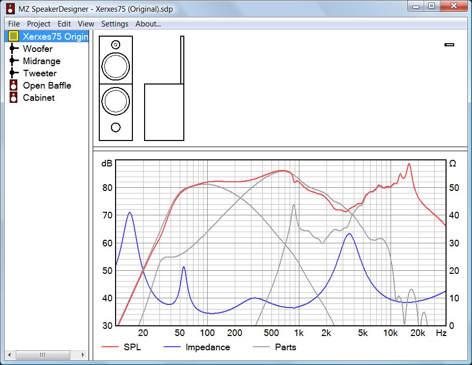

Attached is a simulation of your current setup (microphone distance 3 m). The simulation is not meant to be very accurate, because reliable data of the drivers (TS-parameters, impedance and SPL response) are missing. But it gives a basic understanding of the actual situation anyway.
The woofer section seems to be OK and the low-pass filter basically works. I did assume a port of 70 mm in diameter and 100 mm in length. What are the actual dimensions of your port? A free air impedance measurement of your woofers is absolutely necessary to definitely say more.
The tweeter section doesn't look good. It certainly can be improved by proper flush mounting of the tweeter and by a better crossover. Check the report of Troels Gravesen: WWDT. However, the sensitivity seems to be just sufficient.
Finally the midrange section is the biggest unknown in your speaker. Clearly the crossover is poor. The first order high-pass filter causes a peak at the resonance frequency (same problem as in the tweeter filter) and the 1 mH coil cuts the frequency response much too early.
From that I conclude that you don't have to build a new cabinet, but you have to focus on improving the crossover.

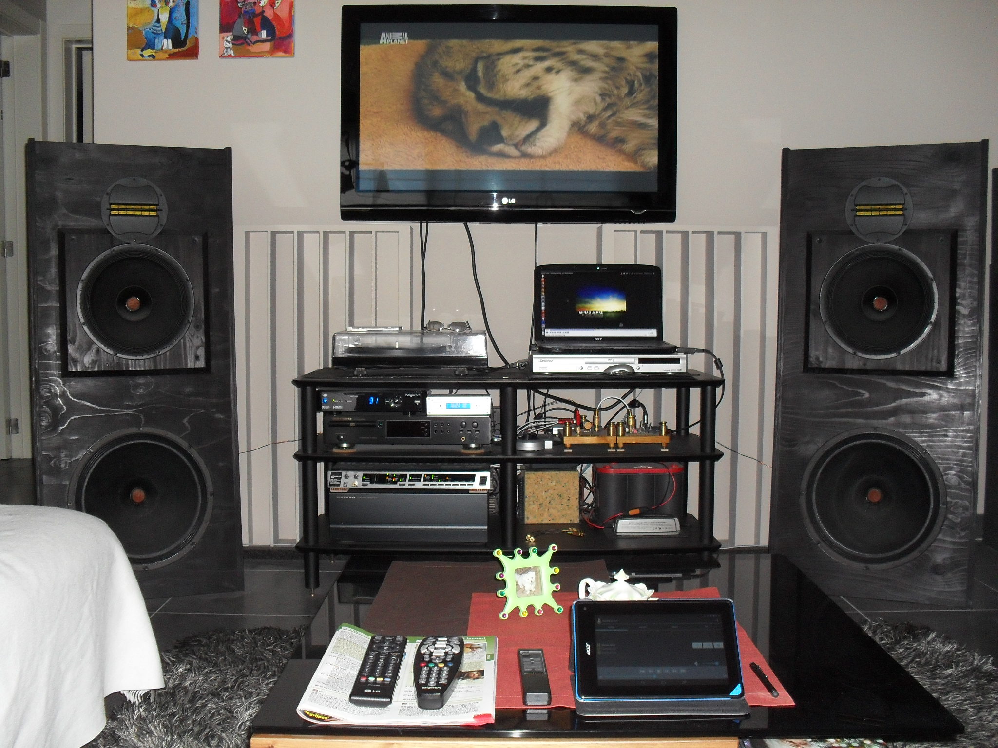

Philips AD12100m
Hello Xerxes75
Your speakers and cross-over look similar to open baffles from the Lampizator site
I have been using vintage fullrange drivers on open baffles for years now and i like them alot Also started with Lampizator clones and missed some highs and lows
You could use the AD12100m8 as fullranges (no filter) in your speakers and
add a helper tweeter with single cap (1.5uf to 2.2uf) to assist the highs Look for same 93db eff.
Similar you can add the AD12100w8 in the same set-up as a helper woofer low pass crossed at (80hz to 100hz)
Myself, i ended up with a Visaton Nobox open baffle design 52cm wide, 122cm high and the following drivers
Philips AD12202m4 fullrange
Swans RT2-C ribbon tweeters with single cap 2.2uf
Emminence Alpha 15A with DSP module low pass at 90hz
End of trip Nothing more to be desired
Succes and enjoy

Hello Adason
The tweeter sounds better to my ears in this position and blends in perfectly with the Philips AD12202m4
I should also mention that all the fine tuning of this speaker was done by ears
No measurements taken
Enjoy
Ronny

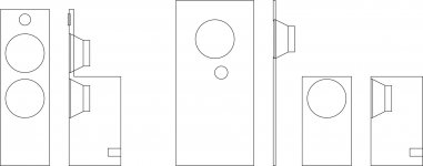

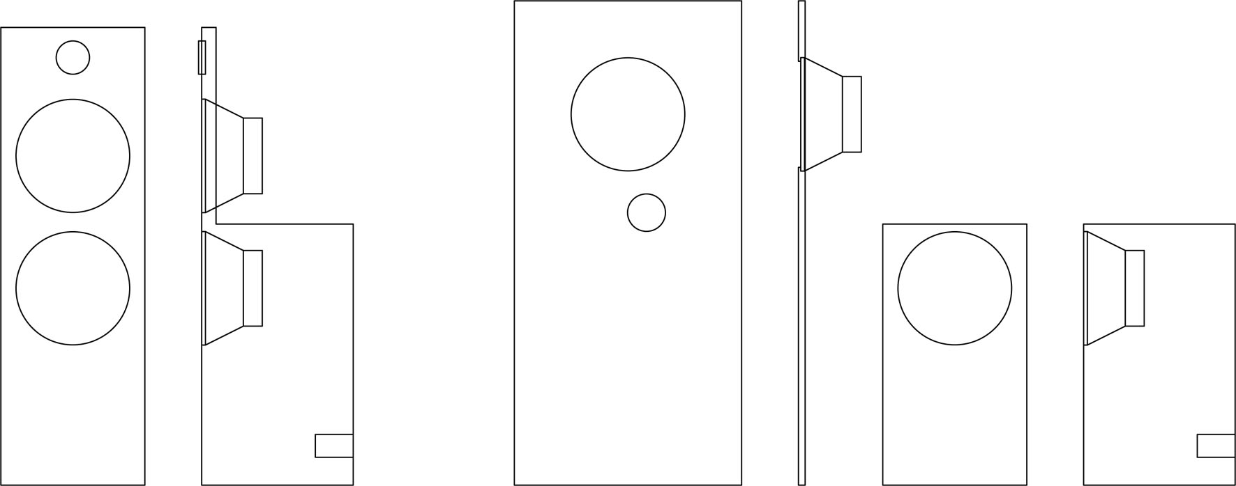

Well listening to only the full range driver for a while, and reading the replies and other threads in the meanwhile.
I want to give the full range driver a special place in it's own (shiny) baffle with the tweeter (maybe a different one) placed off centre and keep the bass driver in it's one enclosure but placed more to the background. In the near future I will give the bass it's own amplifier(s).
So I came up a new plan... The new baffle is 600 mm wide and 1280mm tall (I am thinking on how to keep the baffle upright).
In the attachment you can see the old on the left and the new on the idea on the right.
Maybe this is just a stupid idea so I like to hear your ideas.
