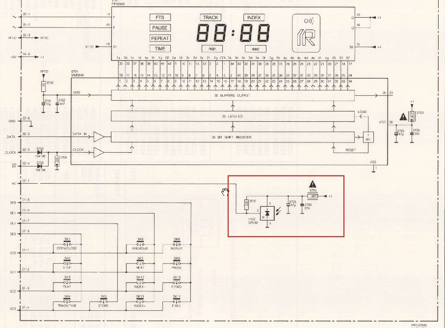

If you don't need the exact matching remote, any Philips CD remote will work because they use the same RC5 code. They do however have different function sets. If you can see what you're buying, just make sure it's for a CD player and has the buttons you need. Other European and US machines also use the same code, such as Arcam and Mission.

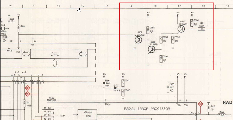

Your bigger problem is whether or not the Magnavox CDB471 has the IR remote control receiver hardware fitted.
I assume that it's a re-badged Philips CD471; if it is you're out of luck.
Motorola's ZC93486P uses not different software. Thus it is unlikely that different IR receiver hardware parts are used - so I think.Your bigger problem is whether or not the Magnavox CDB471 has the IR remote control receiver hardware fitted.
oops.
I assumed from OP that a receiver is fitted, as did tiefbassuebertr I guess.
I can't see provision for it on the main board either, which is unusually unlucky. Perhaps that entire range of machines was non-remote?

Are the players' parts interchangeable? Do they use the same processors (MABxxxx?)? Do you have a remote? You may be able to salvage the IR receiver from the 473 and transfer it to the 471, or swap the other way somehow.

If it is just a rebadged Philips CD471 then it's just a matter of fitting missing parts to display and main boards to make it CD472. All PCBs are IDENTICAL in these two players. You'll need a Sony or Sharp IR receiver, a few transistors, caps and SMT resistors.
I've fitted remote to various remote-less Philips players numerous times in the past, even to lovely little CD371.

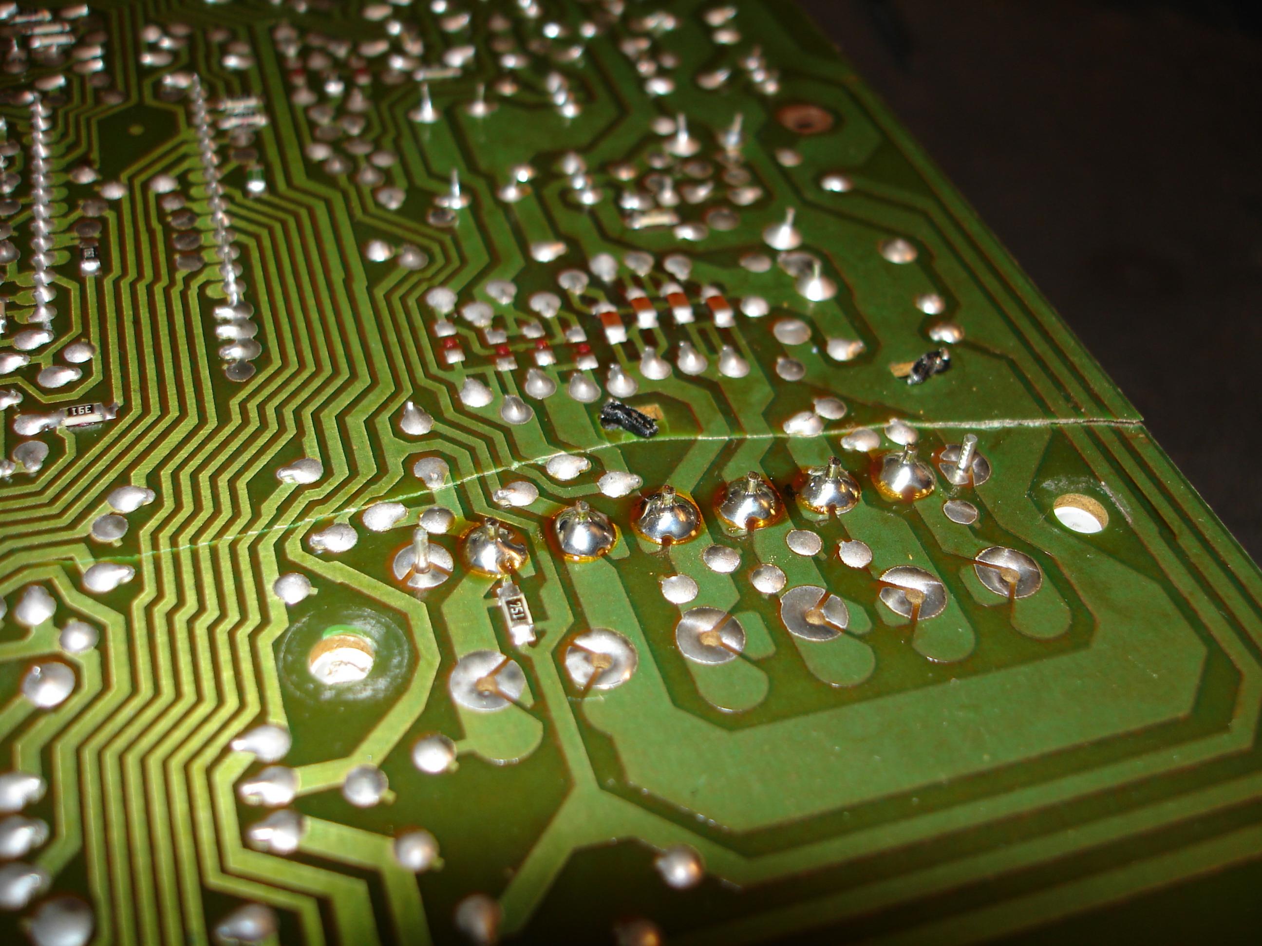

So I receive this CDB473 and not a thing works other than the display. Unit was packed well and it was assured to work?!?!? I start checking all the componets, laser, spindle motor, tray motor, some voltages and all seems ok. But nothing. Decide to do a total tear down. Pull the main board that has the power supply mounted on it. (NOT A GOOD DESIGN PHILIPS) and sure enough I flip it over and there is a 4" crack beside the PS running from back towards front. I count 23 traces seperated by the crack. Thank you USPS! Fire up the iron and have at it. Heavier traces get heavy wire to reinforce the board, some get light wire and some near the end only required a solder jump across them. Fun time......... scraping traces and fixing. re-install everything, connectors attached and dammit if it doesn't work perfect. YEA! 2 hours of labor pay off!
