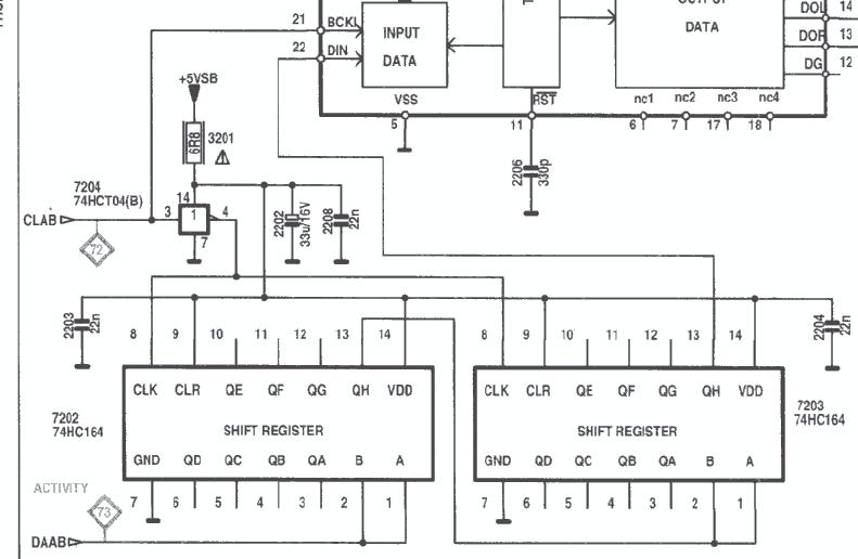

I will try any possible way to make it work inside a CDP,especially basic on PHILIPS CD system.i love PHILIPS.
so i am looking for any digital fiter to accept I2S.
it was said in PMD100's DATA,it can input I2S from SAA7345.but i failt to do it from SAA7210.
here are the Sch from CD931
it used SM5840 to accept I2S from SAA7310.i check that STUDER D731 are in the same way.but it used SM5803.
i am not so sure if SM5813 can do it in the same way.
